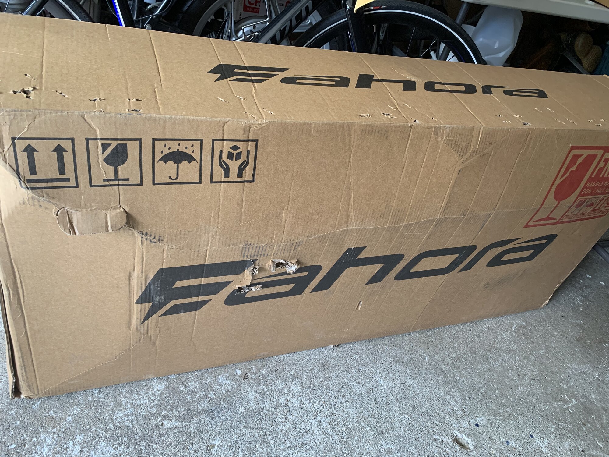

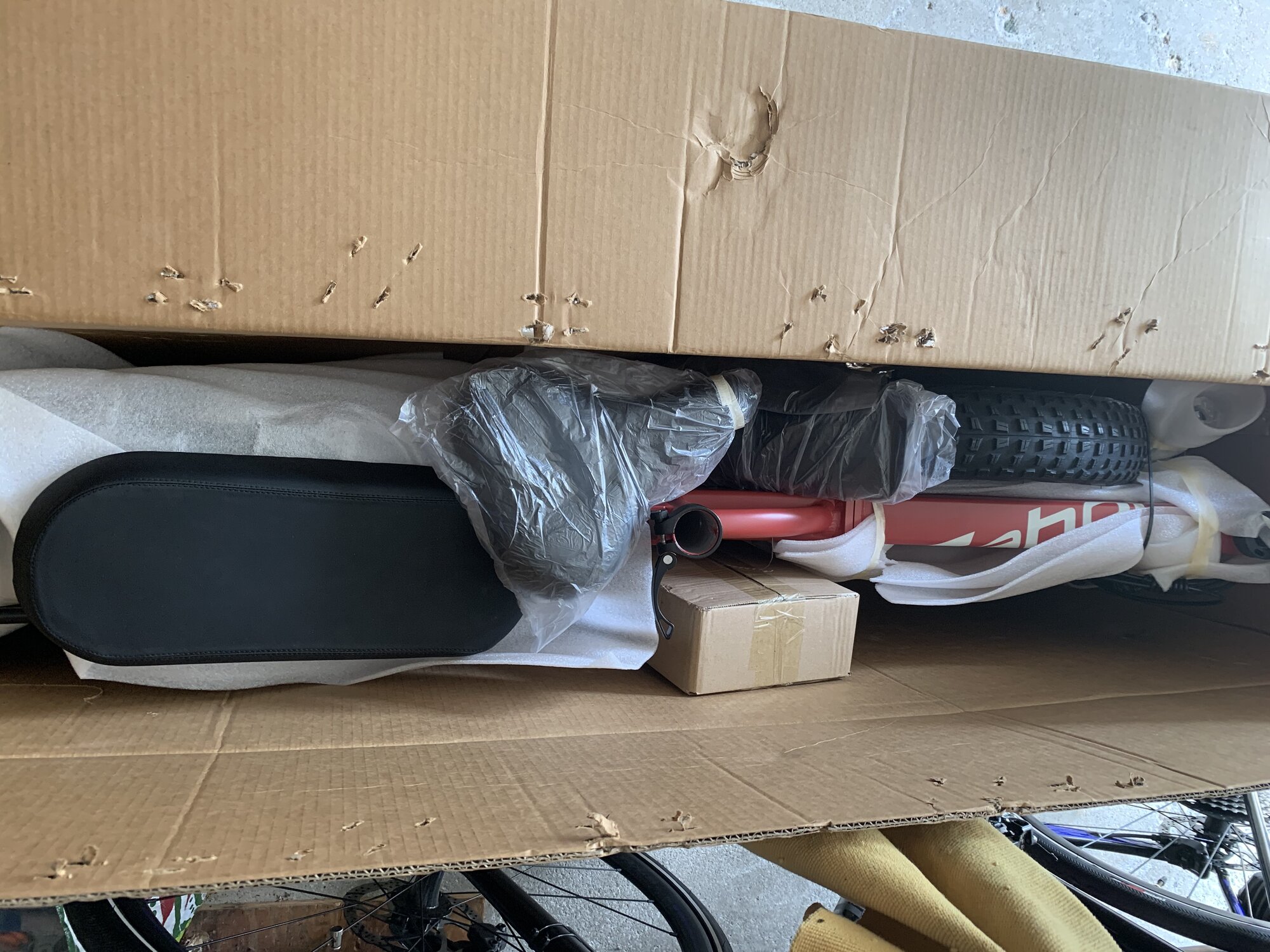

Mine just arrived. Box in great shape. Only one small hole where an axis bolt popped through. Here are a few pics. Will put together tomorrow.

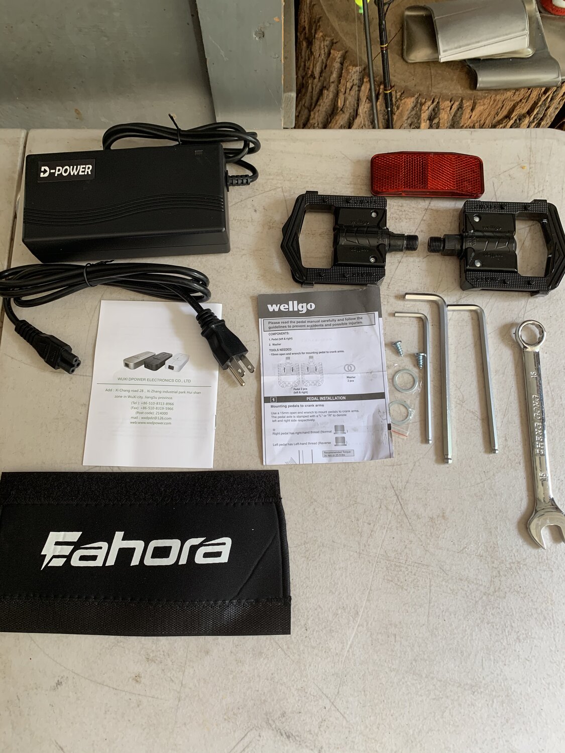

Small box has tools, charger and pedals. Last pic

Be sure to check for the shock mounting bolts which many have been missing. Also bolts for front brake mount. Some found them attacked to the packaging, so dont throw it all away off the bat.
