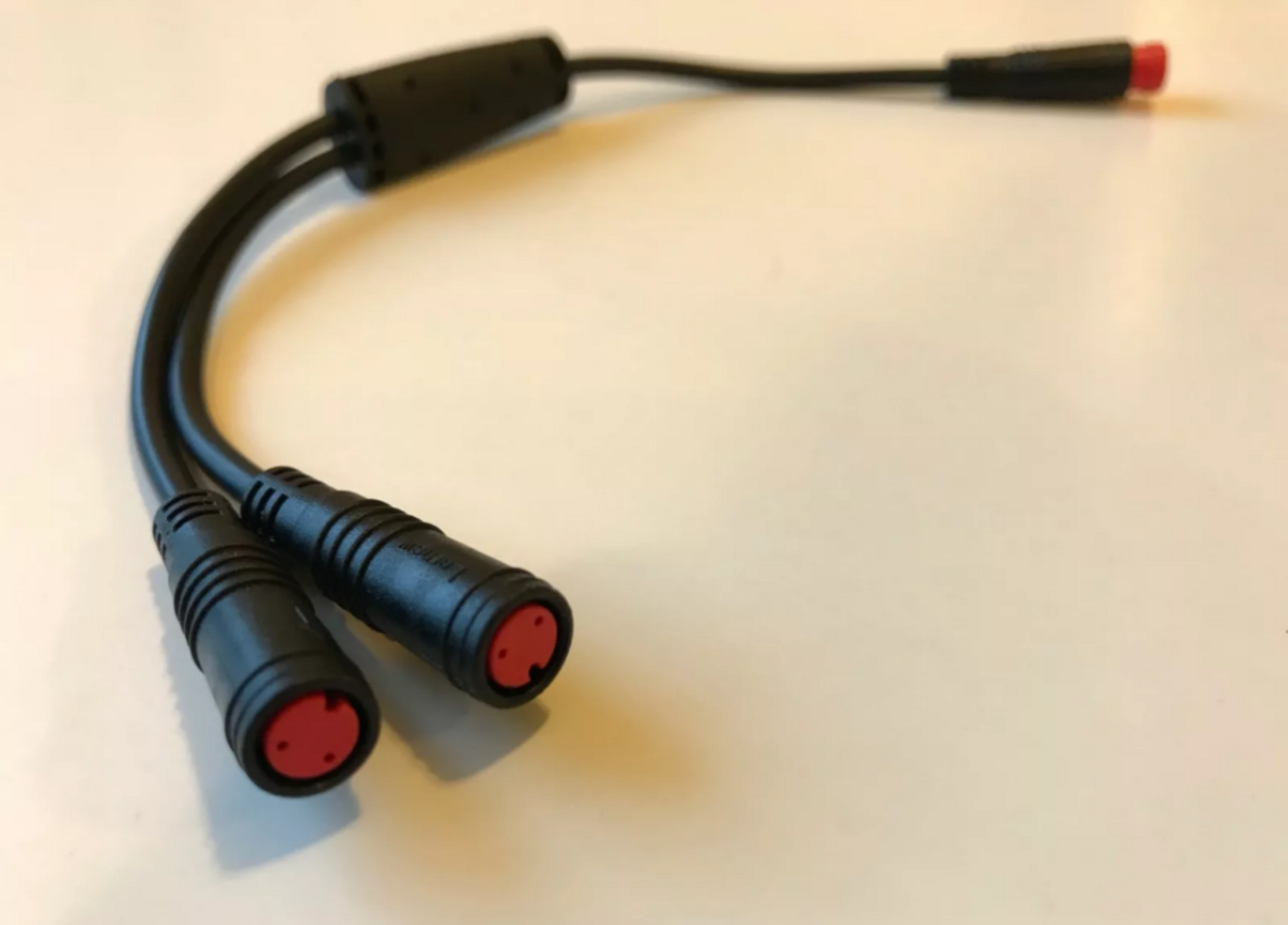

I saw a response from eAhora in Amazon that a rear light can be added to an X7 bike. Any idea how this would be done and if you can do it yourself? Is it worth it since you can add a battery operated one for under $20.
I bet it can split off the existing headlight connection in some way
If the headlight uses a 2-pin/2-wire connector you can use something like this Y-splitter.
It does, but right near the light. Might be a longish run to the rear, but your idea would be the least intrusive mod. Haven't dug in to noticing but maybe another plug connection somewhere.
