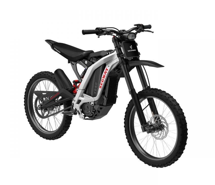

Looks like Segway is rebranding SurRons and raising the price.
That is a significant premium over the Sur Ron $3,600 direct price vs the Segway at $4,999... I don't see any additional equipment for $1,400. ;)
