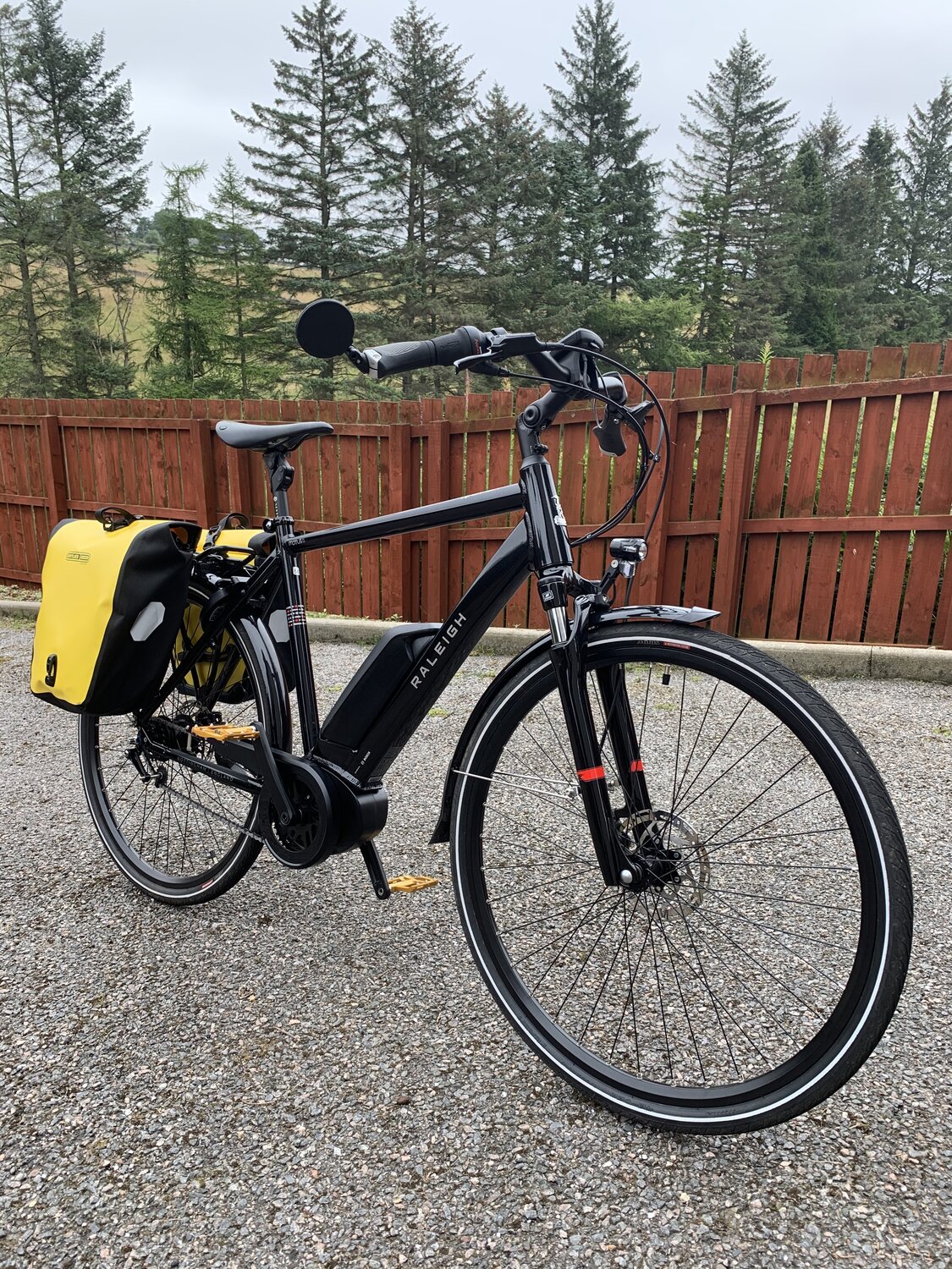

I went for the Redshift Shockstop after doing the research, and along with all the reports that it does what it is supposed to i.e. smooth out the road imperfections, the understated looks appealed to me.
After adjusting the settings to my weight, 195 lbs, by inserting the second spring and dialling in the recommended setting, I jumped on and went for a trial ride. Even though I‘ve not tried any of the competitors Cane Creek/Kinect I was extremely impressed with the Shockstop, handling every rough area of road and pothole with ease, never having to raise off the seat. Also, prior to installing the post, my rides involved wearing the padded undershorts and even an added pair of folded socks inserted down the backside to help the tailbone. Since Shockstop I can now hit the road without any padding!
My rear end definitely loves this product and works really well with my Brooks Cambium C17 saddle.
Ride safe (and comfortably)
Happy to hear that you’re satisfied with the Shockstop. It’s important to be comfortable and only you, not others, not manufacturers. You. Good luck and enjoy your rides.
