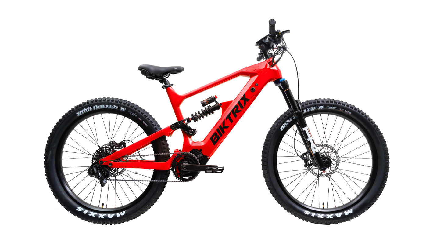

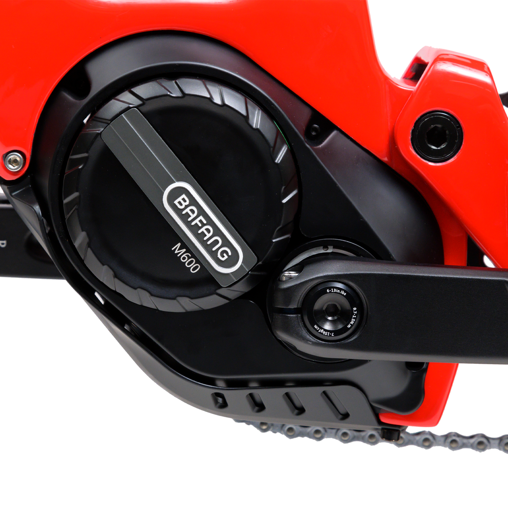

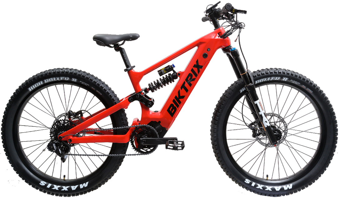

So this is interesting 🤨
So I imagine that their is a separate thread regarding the new Biktrix Monte Capro lite. However my fascination is more concerning the fact that its using the M600 motor and using the DCP18 display
Now for those of you who aren't in the know, the Bafang DCP18 remains a UART protocol display (not Canbus). Here, we can see that it has been paired to their new Monte Capro with the M600.
Now before all of you suddenly say, "it looks like a stock photo as they use that same image when depicting their ebikes with colour displays". Let's give Biktrix the benefit of doubt and presume, that it is possible to run the M600 (and indeed the M500 & M510) with the UART protocol.
I'll say this, it maybe a Dengfu E10 frame. But I'm curious to see whether Biktrix have pulled it off and found a way to do what many of us have been asking for.
View attachment 111650View attachment 111651

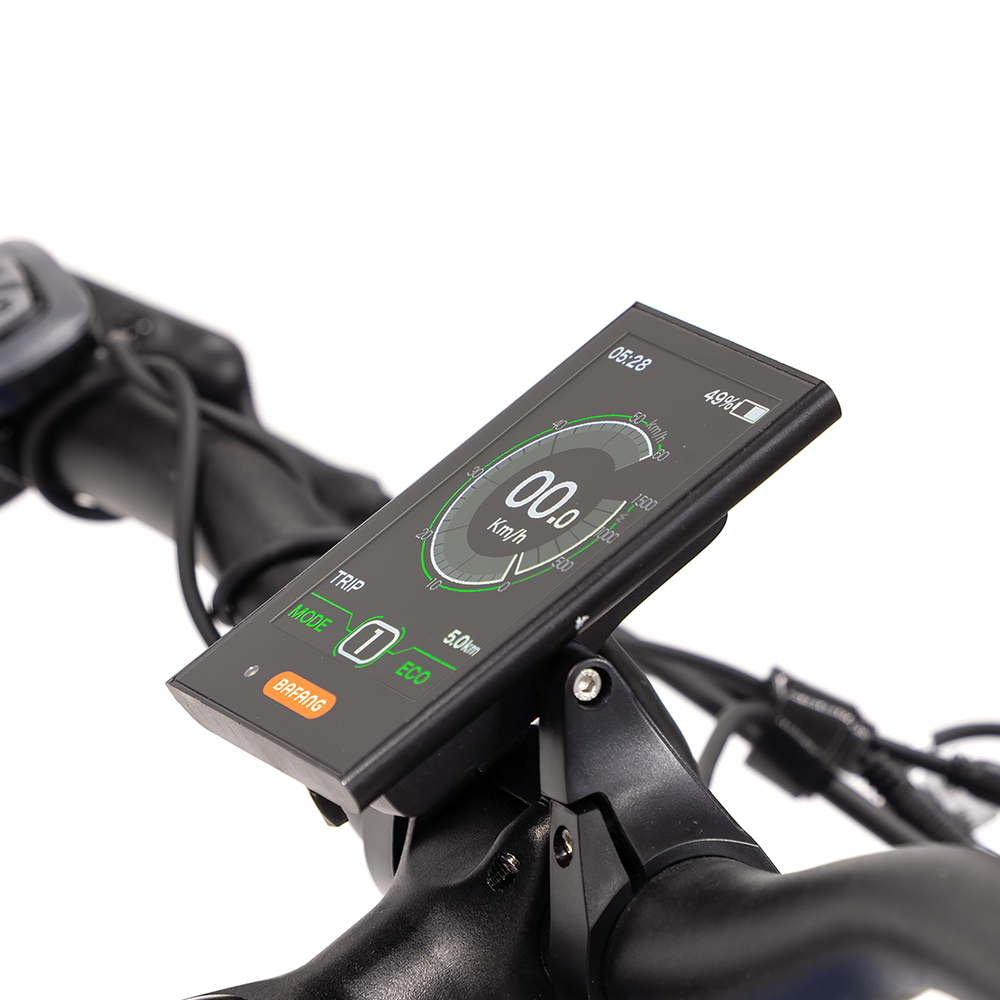

Good catch, however DP C18 also comes in CAN:
We can all hope though. I'd take my Ludi/VESC X2 over the Monte lite as specced, but am hoping there are more options for programmability on both the M600 and Ultras going forward..
Well, what do you know!! You can get the DPC-18 display in Canbus.
I wonder if the 500c will be given a Canbus protocol as well?
If you look at the newer Bafang displays, I'm honestly not sure what the heck they're doing. There's one that's kinda like the SW102/Eggrider in CAN, but the +/- is touchscreen. Dunno about you but the last thing I want riding off-road, or even in traffic, is 'am I pressing the right spot?'/touchscreen.
I'm kind of hoping for a separate display and control pad with a display sized roughly like 500C but sits below the bars, with a saner control pad than the DP-C240.
Meanwhile I'm just not impressed by any of their newer displays, it's more like an 'add tech' versus 'this will be better for people actually riding' etc. :-/
e.g. the below (looks 'neat' but no tactile feedback even before pressing/locating the control button, looks like another 'above the bars' display, etc..)
