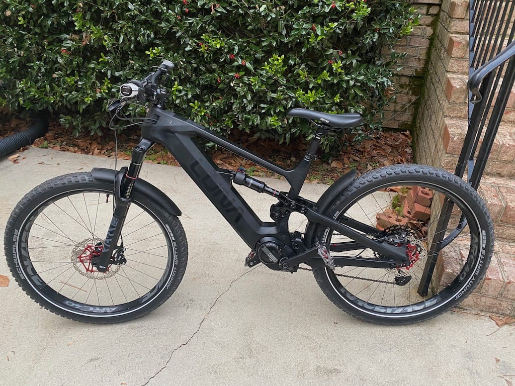

Meanwhile, X2 received. I've got an issue in bluetooth controller connectivity but working to resolve, and otherwise very happy with the bike overall. Shakedown 20 mile ride was great. If someone's looking for something using throttle as primary driver, I'd get a Z1 over the X2, but even swapping back and forth with my wife's Bosch, and riding around on PAS 2 (of 9), I'm quite happy with it. The sensitivity to pressure applied on the pedals ramps up a bit quickly from a standstill (something I expect to be able to adjust over time - the firmware dev is pretty active), but once moving, comparable in feel to my wife's Bosch Active Line so far.

So I find myself also in this same dilemma: road vs mtb. I am ultimately looking for a good FS e-MTB, and so far something like the Luna Z1 ticks most of the boxes for me. However I also wanted a commuter bike for some light around town commuting, and was looking at models such as the Rize RX. Super nice, but do I really NEED 2, when I can prob use ONE with some small drawbacks on one side?? After all, the biggest difference between these two is simply the rear shock (FS).
So maybe for me getting the Z1, which is perfect for what I need, and being able to ride on the street occasionally with mostly everything I would need there (Except for road tires of course) and only paying for and storing a single bike!! Would this setup work fine for light commuting?
