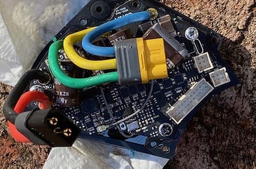

A pic of mine just for grins:
Is there schematic of the Luna Ludi V2 m600 controller?
