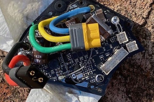

Ludi v1 was a shunt hack. Ludiv2 is a complete FOC VESC-BASED replacement controller. Swapping with my wife’s Bosch other than a bit sensitive on power application from a standstill, I’m not left wanting..it’s quite nice. This is not the as-comes-from-Bafang option though.

Once someone in the US can reliably ship Ultra FOC controllers or perhaps Innotrace will sell to the US in the future or Luna releases for the Ultra, I kind of agree - you gain a good amount of ‘abuse-abillty’ with the Ultra.

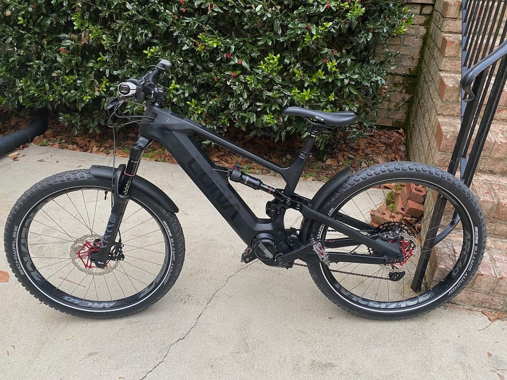

A pic of mine just for grins:

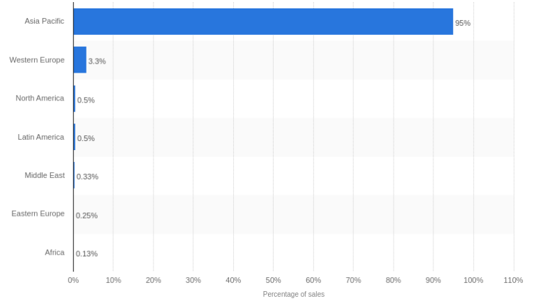

Even so... in 2019 Bafang had already captured 16% of the EU market. I hadn't realized they had come so far by that time.
None of this action on the part of Bafang is good for consumers, as you noted.
This chart is out of date, but even if there are big shifts... they won't be big enough to change the story much. Image stolen from this very old article.

That chart is telling. Great link and chart, although I'm wondering on any 'interpretation' done in market studies in general. So yeah, it's entirely possible there are entire 'fleets' of Bafang-powered ebikes out there <somewhere in APAC> we just don't have visibility into, although if the chart is at all accurate, would make you wonder why they're looking to make inroads into the EU honestly.. ? 16% of <tiny percentage> is still, well - relatively small, even if larger than the NA market as represented in the chart.
