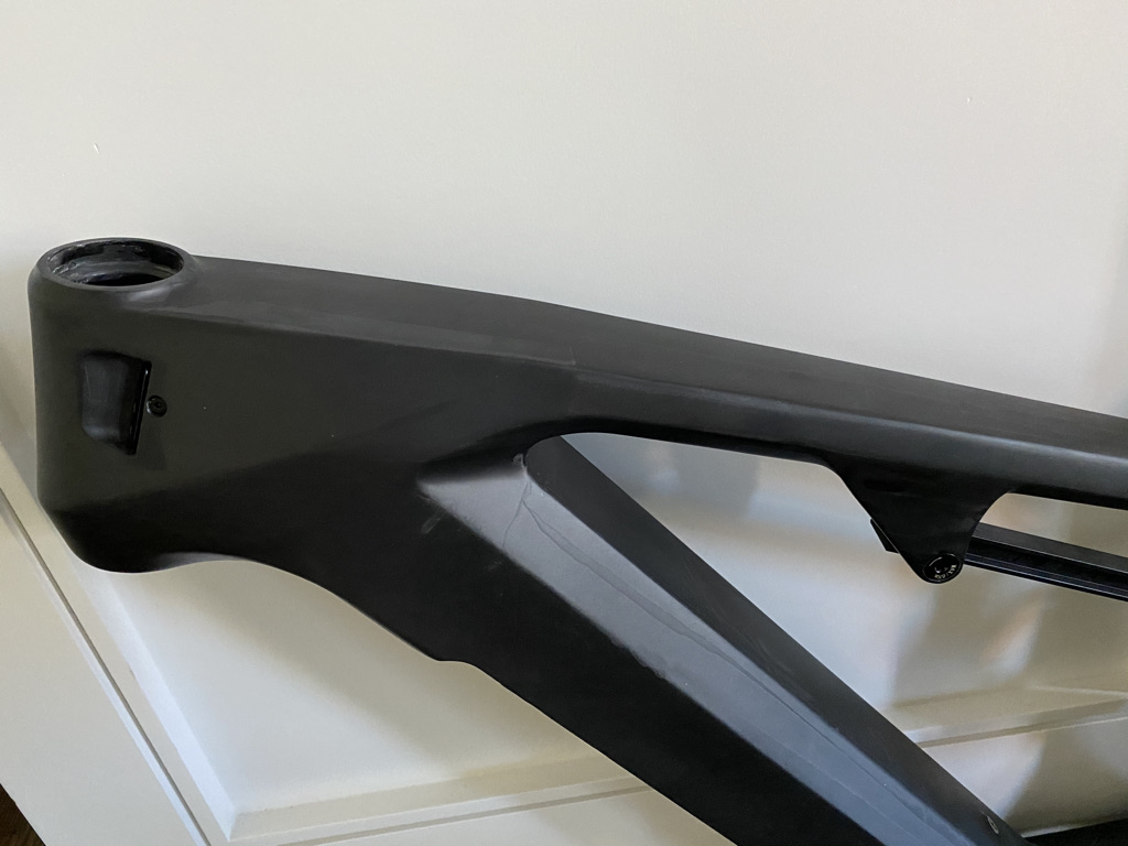

UC Pro Step through frame prototype build pics. Painting / Decal / lights etc will be done in Boston.

1. I am testing a triangle prototype of the frame right now and here is a sneak peek of the raw frame (still to be painted). The weight savings are around ~7-8 lbs for out spec frame (325-350lb load capacity). So not officially published but I am speaking from our current prototype :)
2. With this frame the CG is slightly lower (the battery is fatter and shorter, and close to the center of the bike) So there are definitely handling improvements.
3. We are also making the frame slightly wider / "squatty", with a larger dropout- so riders have the option of doing a wider tire (up to 2.8in). (ikr!) We have made changes to the geometry and i am waiting for the prototype frame to be shipped soon.
4. Fragility - frames will pass EN and ASTM tests. We have to rely on a standard. There will always be an edge case, regardless of what material one chooses. Since we are in a way "over building" our frames, and because the frames pass the tests, we are confident that they will be around for a long time. That being said, I have seen aluminum frames breaking, titanium breaking, carbon breaking... so if someone actually wants to break a frame, they will succeed.
5. There are a LOT of carbon based bikes that take a significant amount of abuse rough use without issues - e.g. our Travalanche (Exess HP180) is a full suspension trail bike in carbon. It is extremely sturdy. Carbon has come a long way, and esp more so if you build it right.
