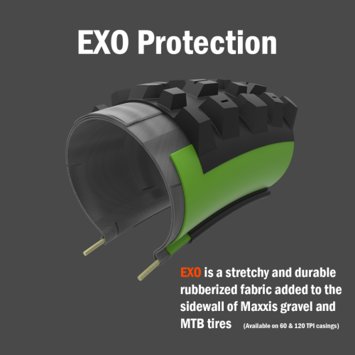

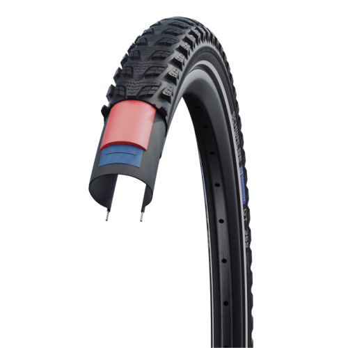

They are off-roard, but I don't see anything for puncture protection on them for main track - just sidewalls. Compare with i.e. Maraphon GT 365 from Schwalbe.
Is side protection useful for MTB bikes? I don't think it makes sense for regular rides a lot...
maxxis-png.160156
View attachment 160159View attachment 160158
Take a closer look at the mtb tyre - 4 layers of carcass AND the knobs - those knobs typically have a stiffer central compound and sticky / soft outer layer, so it's really 2 extra layers. The advertising dept hasn't bothered using pretty colors, because they are showing the EXO section, which relates to the side wall . Exo are flimsy, exo + a little less flimsy, but double down hill are toooo stiff. Goldilocks had nothing on the average mtb rider.....
Maxis will usually have three tread construction options, and 6 different options in sidewall construction - an identical looking tyre can have a weight difference of 400 gms! Same size / tread pattern , just different levels of construction / compliance / grip / longevity / brag factor.
For what it's worth, YES we slice sidewalls - on sharp edged rocks , sticks, landing sideways at speed on pretty much anything. ... or landing hard enough on a rock to squash all that technology against a rim that decides it doesn't want to be a rim any longer....
