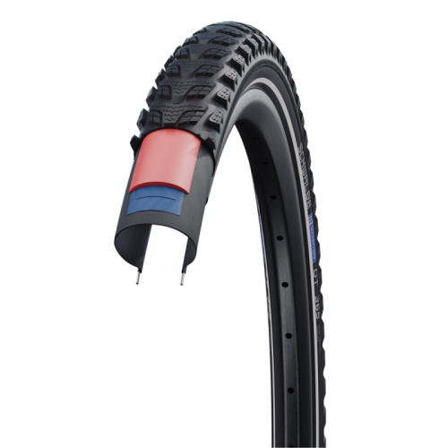

They are off-roard, but I don't see anything for puncture protection on them for main track - just sidewalls. Compare with i.e. Maraphon GT 365 from Schwalbe.
Is side protection useful for MTB bikes? I don't think it makes sense for regular rides a lot...
