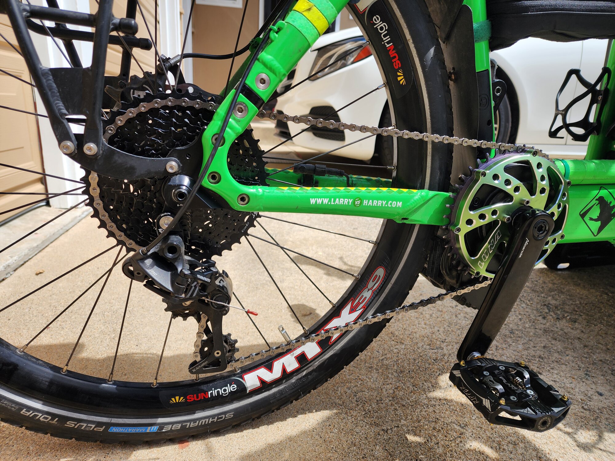

For years, I swore by KMC x9e and e9 chains. That or the e11. But in recent years, the market has given us new options. Many moons ago I did a whole SRAM EX1 drivetrain ($$$), which in 2024 I would never even consider.
For 9s clusters, Microshift Advent has an 11-46T that is solid, hardened steel cogs. Pinned together all over the place and even the 11T cog is steel. And its like $40. For 10s, Microshift Advent X is the same durable animal as the 9s in 11-48T and its about $45. For 11s clusters, the strongest is the Sunrace CSMS7 which is all steel again, and also pinned-together. Steel spiders. 11-42T but they just released an 11-46T. About $60. The BFD uses a Sunrace CSMS8 which is all steel except for the 51T cog, which I can live with. But now we've bumped up to about $105. But if you want ultra wide range and 11s thats the only one I'd trust with a BBSHD.
For my 9s setups I have been using the SRAM EX1 chain, which is compatible with 8s thru 10S and is $25 or less. Indestructible. For 10 and 11s I've been using just 11s chains. The narrower exterior of the 11s makes a 10s as quiet as a belt and an 11s chain's interior dimensions are the same as 10s so it works just as well.
For derailleurs I've used Box 2 and Microshift for 9s, Advent X for 10S. SRAM GX for 11s. I have to say the Advent X is my favorite of the bunch for cost and smoothness. But the Box 2 ultra wide long cage is the slickest. And the most expensive..
As far as I can see, Most of the Linkglide system is just Shimano offering what you can get elsewhere for less $. In particular their cassettes. But if I wanted a wide range 11s derailleur, I'd have to go Linkglide. SRAM maxes out at 42T.
Good stuff.. My current Sram cluster is coming apart with loose rivets.. The DM01 is too much for it. I will give the Sunrace solid steel a go. I appreciate the cheaper chain too.
I have never used a BBSHD without the lekkie 42t chainring so maybe the BBSHD with stock chainring has a bad chainline as well.
Yup it sure does. I am currently trying out a Gustavo chainring, which is a US$35 clone of the Lekkie. Just to see how it behaves. Its powder-coated vs. anodized so it appears to wear immediately, but thats just the powder coating wearing off. It also has a little less offset, but only a little. I've got a slew of Lekkie rings ranging from 52T all the way down to 28T, so I'm a big fan... but $35 versus about US$150 now on some of the sizes makes for a powerful argument to go cheap and just buy 5 of them as they wear out.
Things have changed still further since I wrote that post in August. I had not yet installed the 11s Microshift pie plate. Since then it has become a staple. Its a head-and-shoulders upgrade over the Sunrace. Much wider range, costs less and every cog is steel (except the big 46T which is fine). Zero issues with the 11s Linkglide chain and SRAM derailleur, which I extended to be able to handle the big cogs with a Wolftooth Roadlink that isn't supposed to work if you read the product literature, but in fact works great.
The Sunrace has steel spiders but the Microshift is 1-piece steel cogs. I get a lot of traffic on this page and I keep the hardware sections updated as I come across new winners. I updated last on October 11 with pics of that Microshift among other things.
