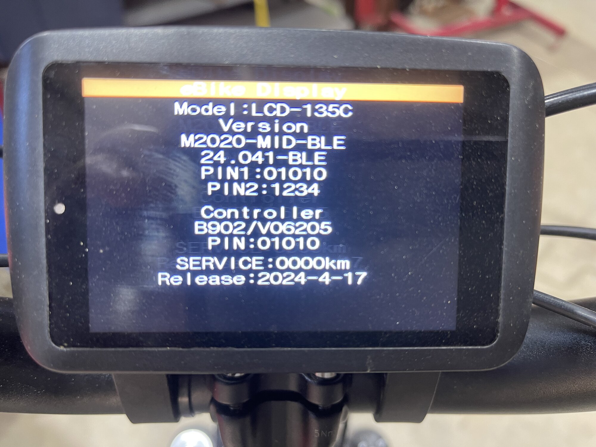

My experience with the dmo2 has been strange. First I got bad components with the kit. Display wouldn`t power up, then with a replacement display it powered up and the speed sensor would not work. John n/o sent me a speed sensor that fixed the problem. The unit started running for a short period and would kick off. It would just quit yielding power assist but not go off line. The display stayed powered up it just would not assist for a few seconds. I thought this was happening due to over heating as the motor felt hot to the touch. This persisted as long as I ran it for about a week. I went into the bios and reset the chain ring tooth count and the rear cog count to the proper numbers. I was running this build as a single speed with a 38 chain ring and a 16t rear cog. The kicking off went away. I then decided to put the motor on another frame set with a nine speed set up. This time I set the gears I was using in the bios. I put on a 36t chain ring and a 46 by 13 cassette. The damn thing has never kicked off again. I have been so impressed with the little unit after dialing it in that I ordered another one for a friends build. Explain this one for me. I have built over 50 ebikes with every thing motor wise out there. This one takes the cake.
