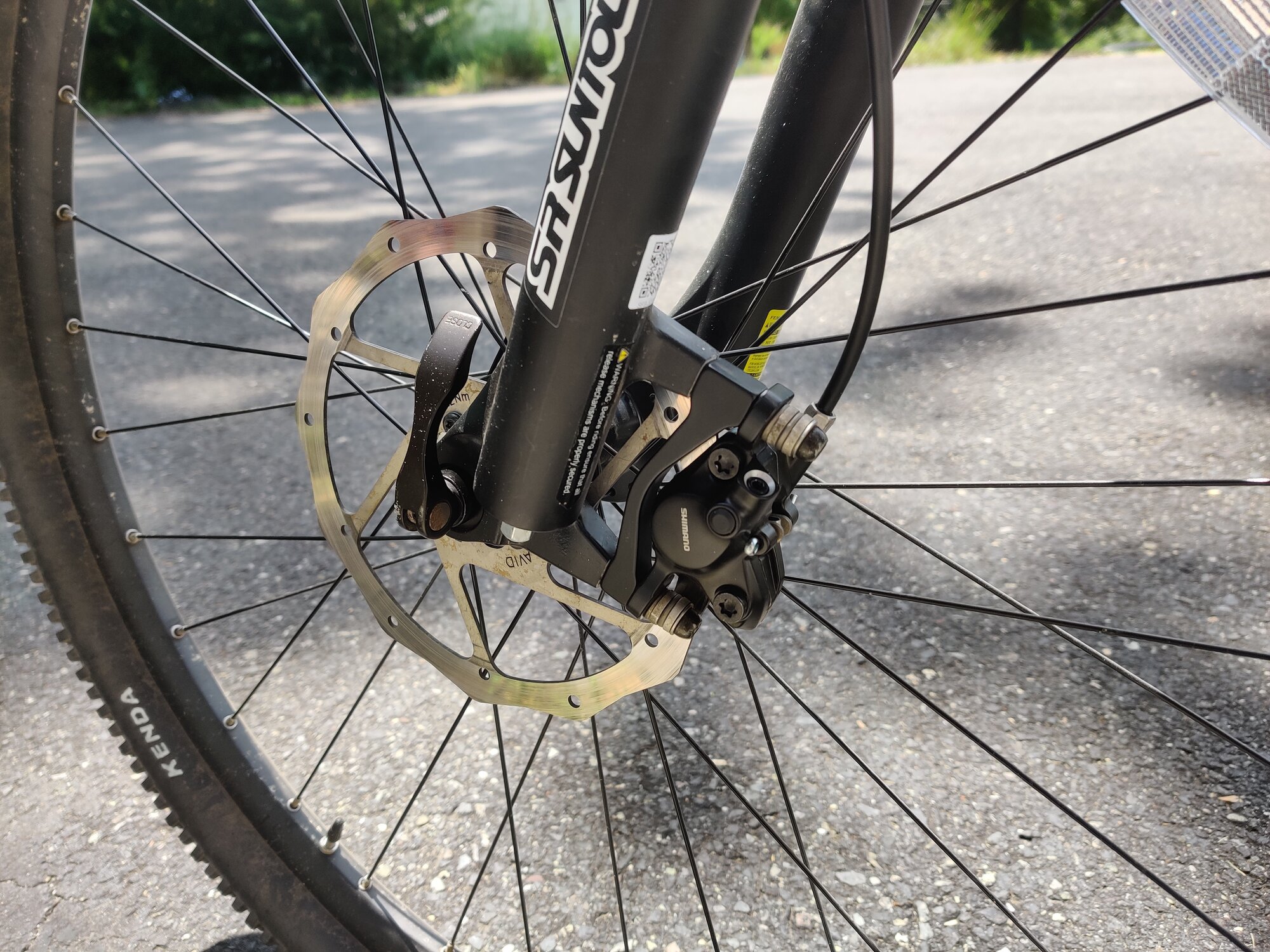

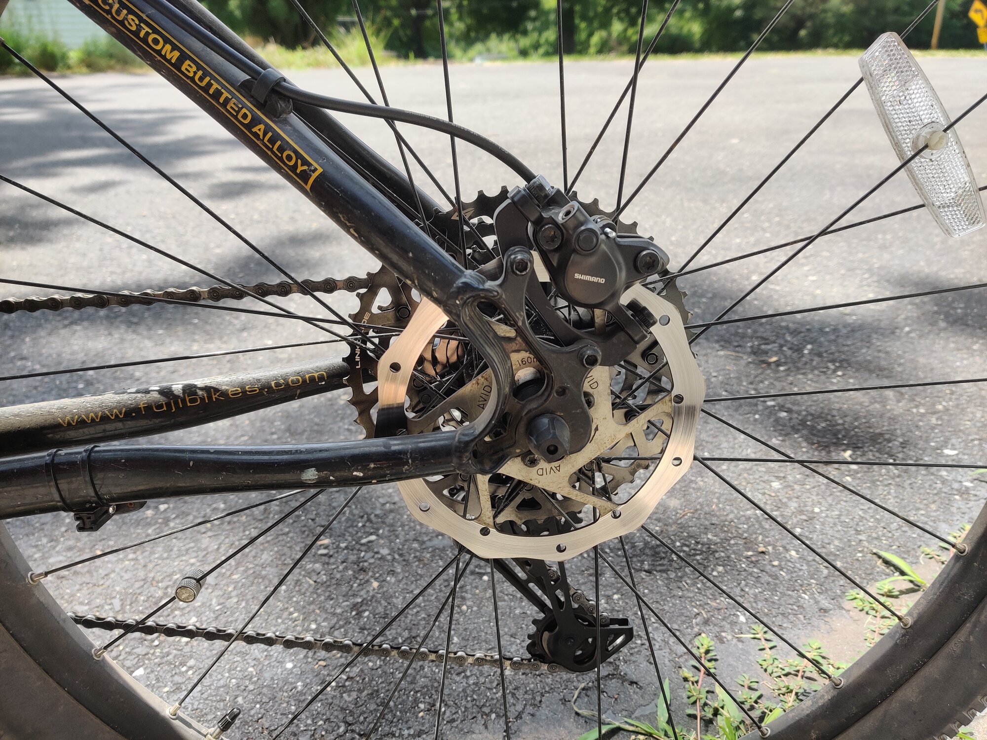

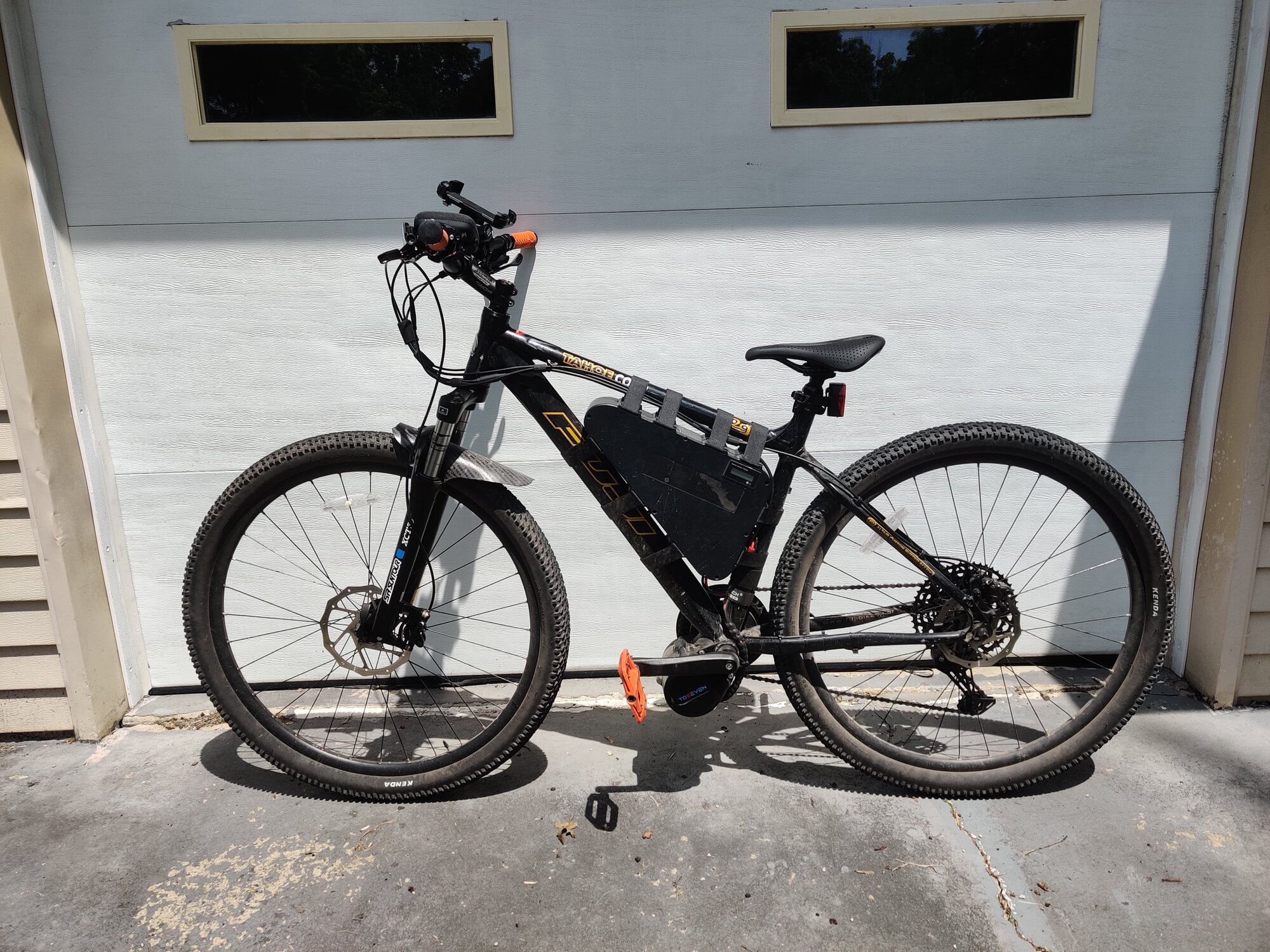

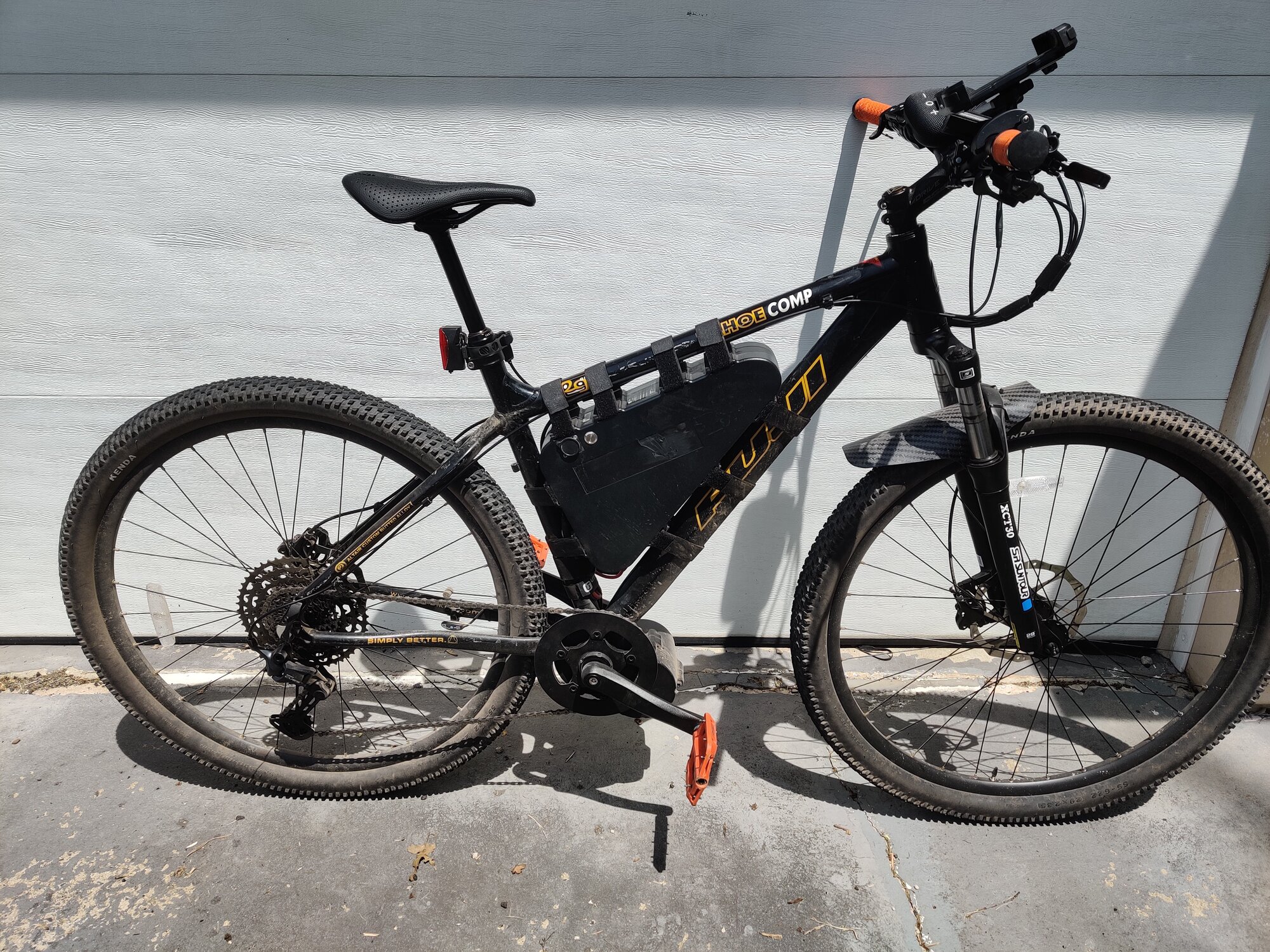

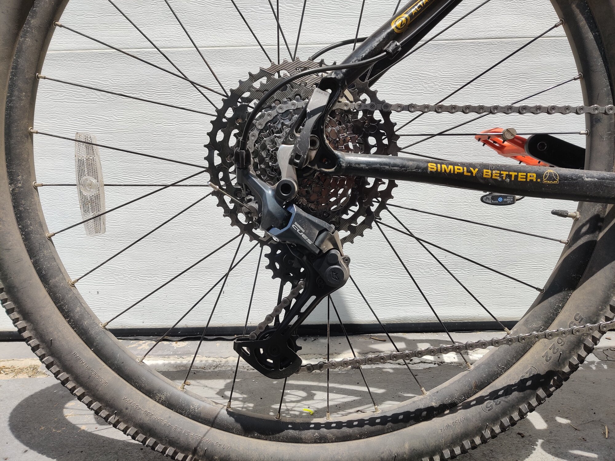

Update. I swapped in Shimano MT200 hydraulic brakes, Shimano Cues cues setup with RD-U8000 derailleur, SL-U8000-11R Shifter, CS-LG700-11 Cassette, and CN-LG500 chain. I also ditched the Rockshox Dart 3 with 28 mm stanchions for a spare Suntour XCT30 with 30 mm stanchions. The ride is so much more stable at speed and enjoyable, I'd have to measure to see if the Suntour fork has less off offset at the crown and more at the wheel, but it looks like it. I also swapped on the wheels from my Ozark Trail Ridge since the hubs and tires were in such better shape (new). The bike feels amazing. The lack of rebound on the Suntour is irritating, but I may swap in a Wolftooth GeoShift 2 degree headset with a Rockshox Recon when I have more money to burn.

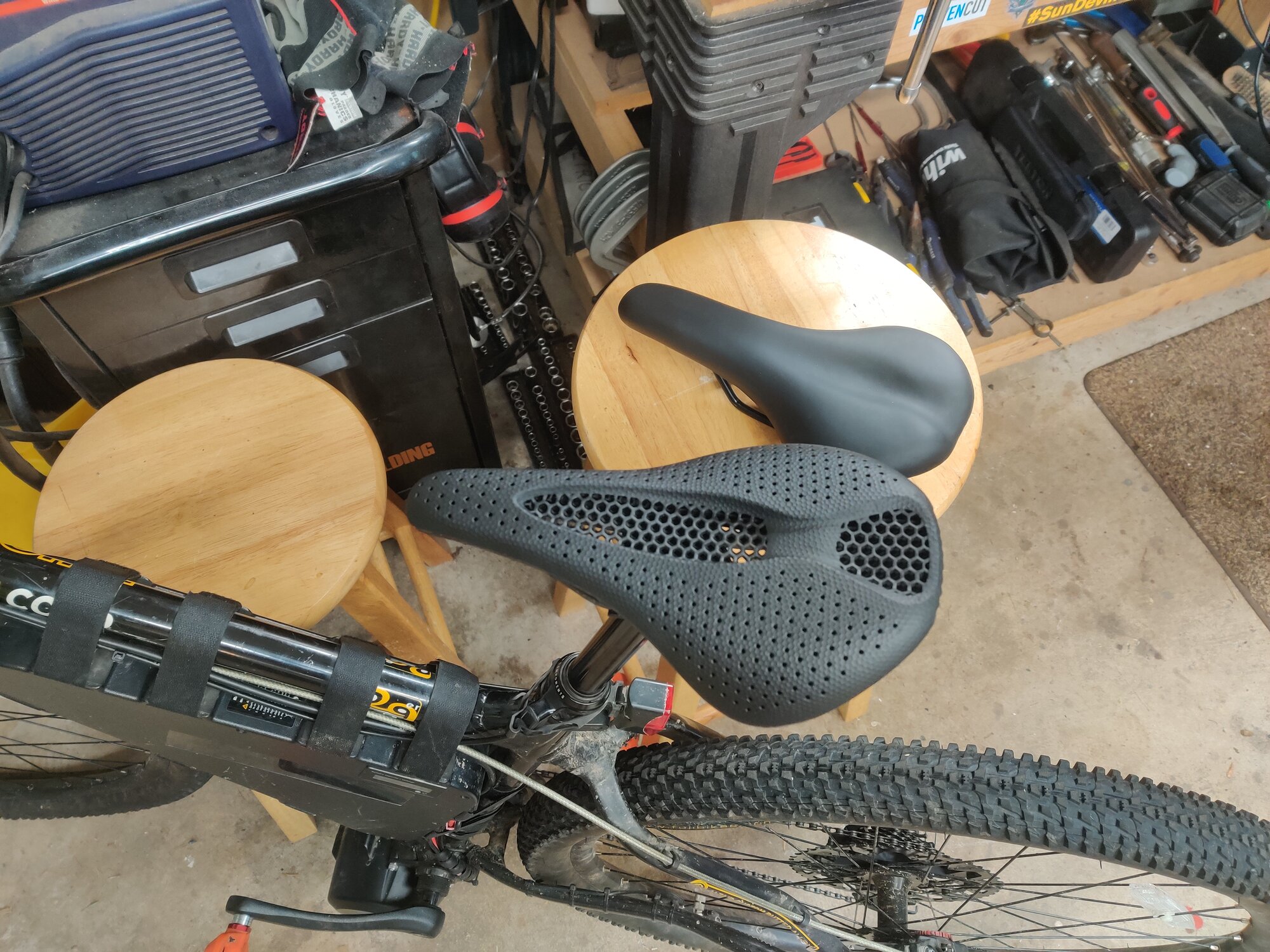

I'm testing some of the AliExpress saddles that seem to get good reviews, namely the Bucklos clone of the S-Works Power Mirror and a Zeius. I have new rotors and pads on order, going to try some sintered metallic pads. I need some shorter screws for my front caliper... lol. I have a shorter stem from the OTR also, I may swap that in too.
I love the printed saddle!
