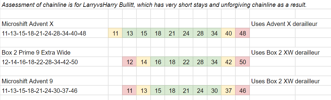

I usually do a little better than 6 gears. My 10s Bullitt has 9 out of 10, with 7 being what I consider to be long-term acceptable. But it took a few tries.

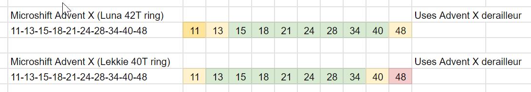

I had settled on the top config, but switching to the Luna on the front shifted my sweet spot inboard which better suits my riding. The 11T went to a big maybe (that I never use) and the 48T became usable but I haven't felt a need to do so and put that kind of wear on the chain.
A lot of the room you have to work with is tied to your chainstay length. The Bullitt has short stays and sharp angles happen as a result. My Big Fat Dummy longtail, on the other hand, with a 180-link chain, can easily use all 11 cogs without issue, and I don't even need an offset chainring.

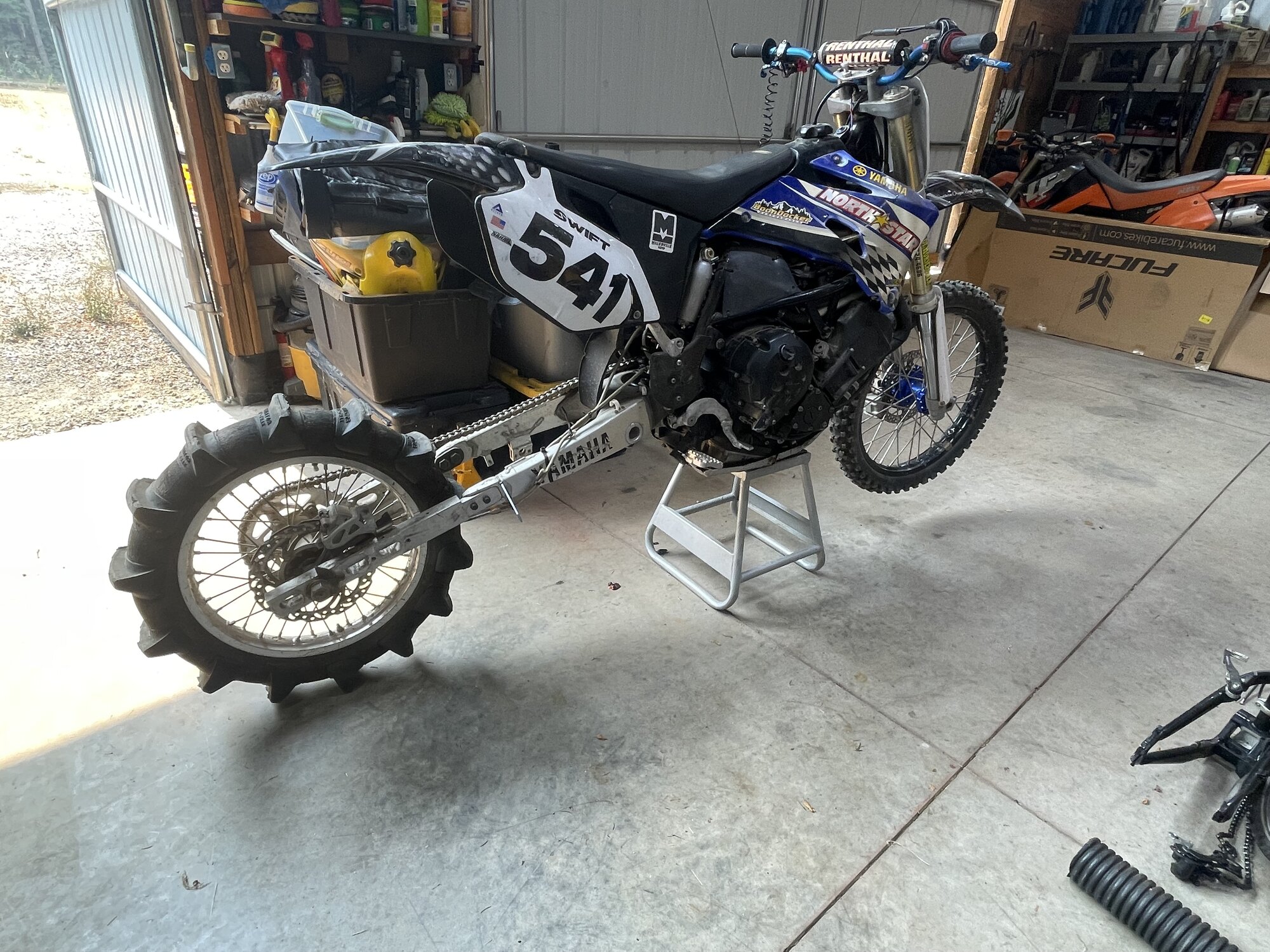

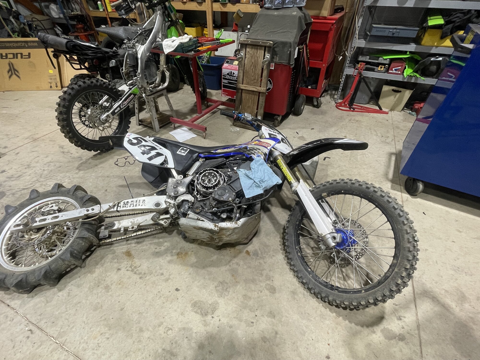

Images are an example of knowingly stepping on it... I repair a local pro hillclimbing groups bikes. Some of them are real messes, and I am called into action for issues they cannot solve themselves. This is the 3rd clutch on this R1 Yamaha powered monster, the last one liquified the aluminum plates when they used 2nd gear on a climb and sent aluminum and friction material into the oil pickup. They did manage the fastest pro climb of the day however...
Check out the rear brake line routing and connections... They have no fear of such things and no concern about it!

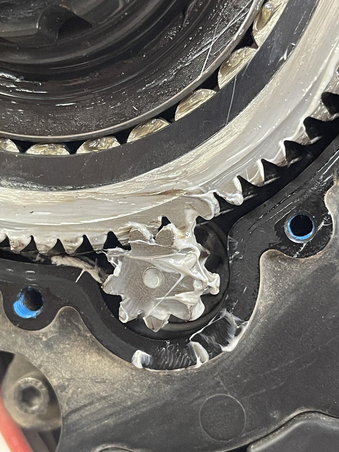

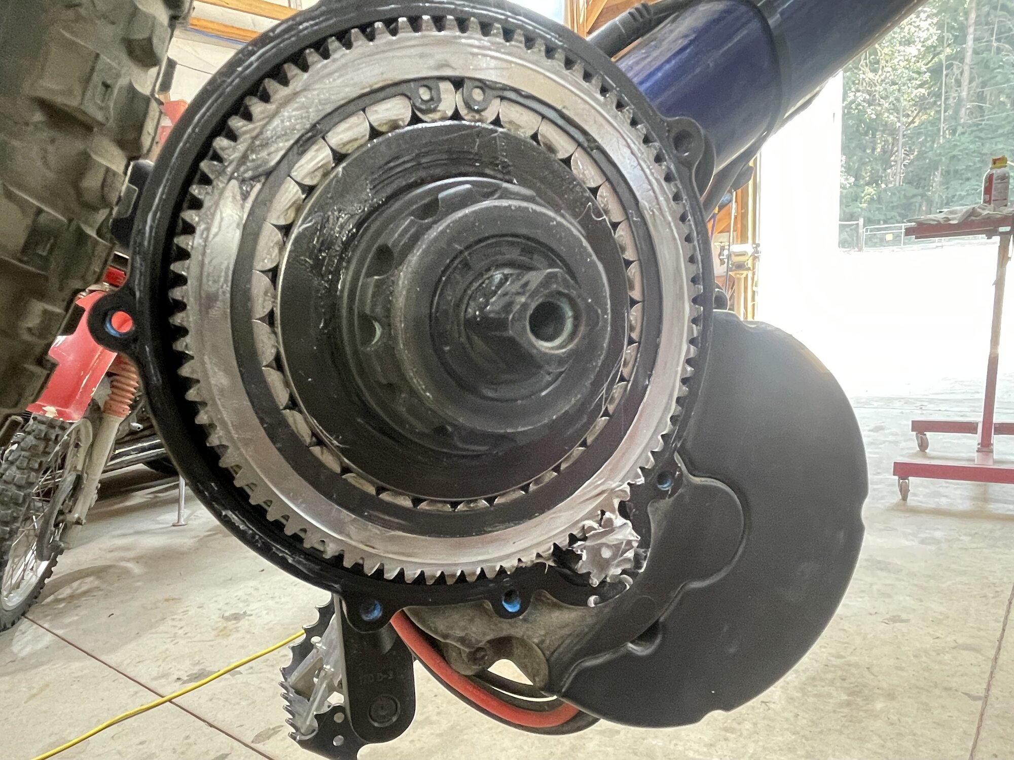

Additional issues with my DM01- when pushing the crankset a bit hard in a taller gear and or on a standing climb, the deflection of the chainwheel drive is a bit concerning. Noise is generated in the chain to sprocket as it wobbles a bit out of true. The sprag clutch will also do momentary skips on changes in crank load and make some unpleasant noises.
I realize that there are some significant engineering challenges with a single support bearing design, but this seems a bit excessive.
A peek inside...
I think their reputation will be short lived if they don`t change.
