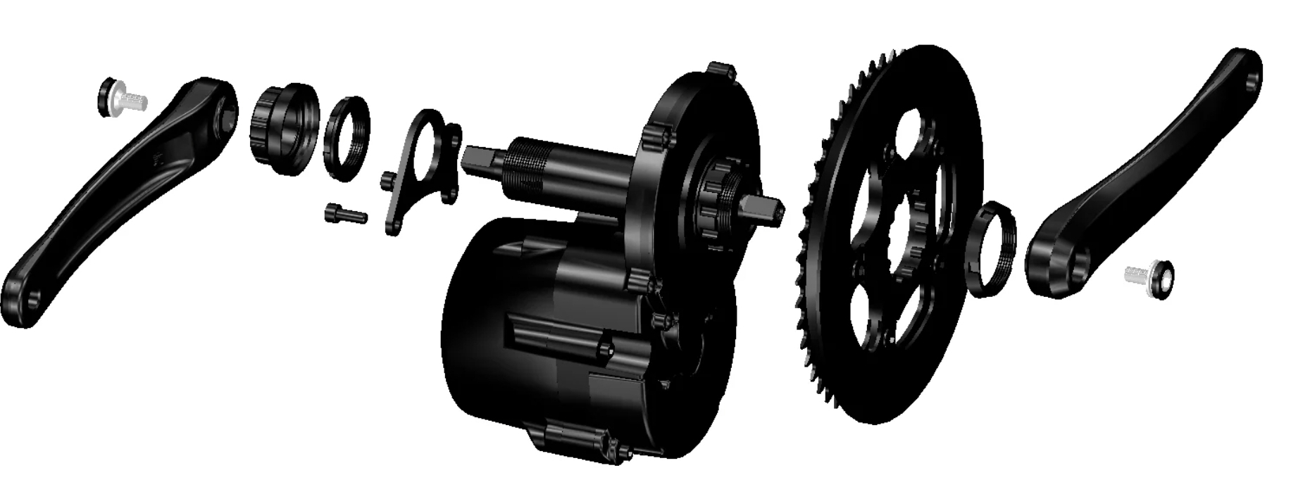

This came up on my screen today. The DM01 is kind of a BBSHD with Torque Sensing. Weighs 6kg......Square taper cranks, when are they going to get with the splined program over there? Supposedly developed by an ex Bafang engineer.
The DM02 is alot lighter @3.6kg or so and a competitor to the TongShen TSDZ2 and looks virtually the same?
There are some video's of them in operation and they sound pretty loud although they say in the factory information that the 01 is only 50db but it sure sounds louder than that. Looks like nylon gears also which might melt, or might not....
So they look like a mix/best of the BBS and TSD.
So for me the big question is... Is it end user manufacturer supported programmable or are we playing more of the hack game.
Chainring is spindle mount... Kinda/sorta 🤣🤣

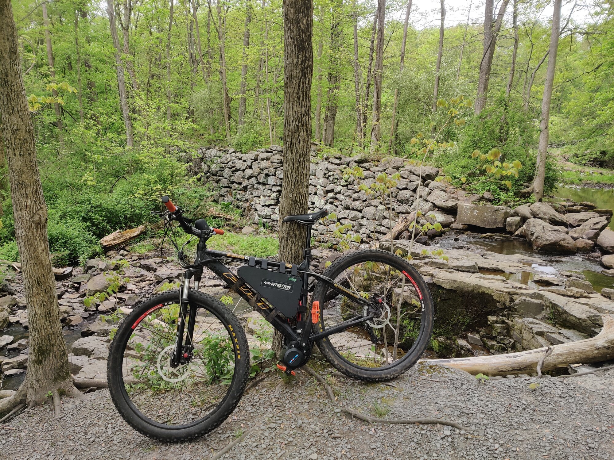

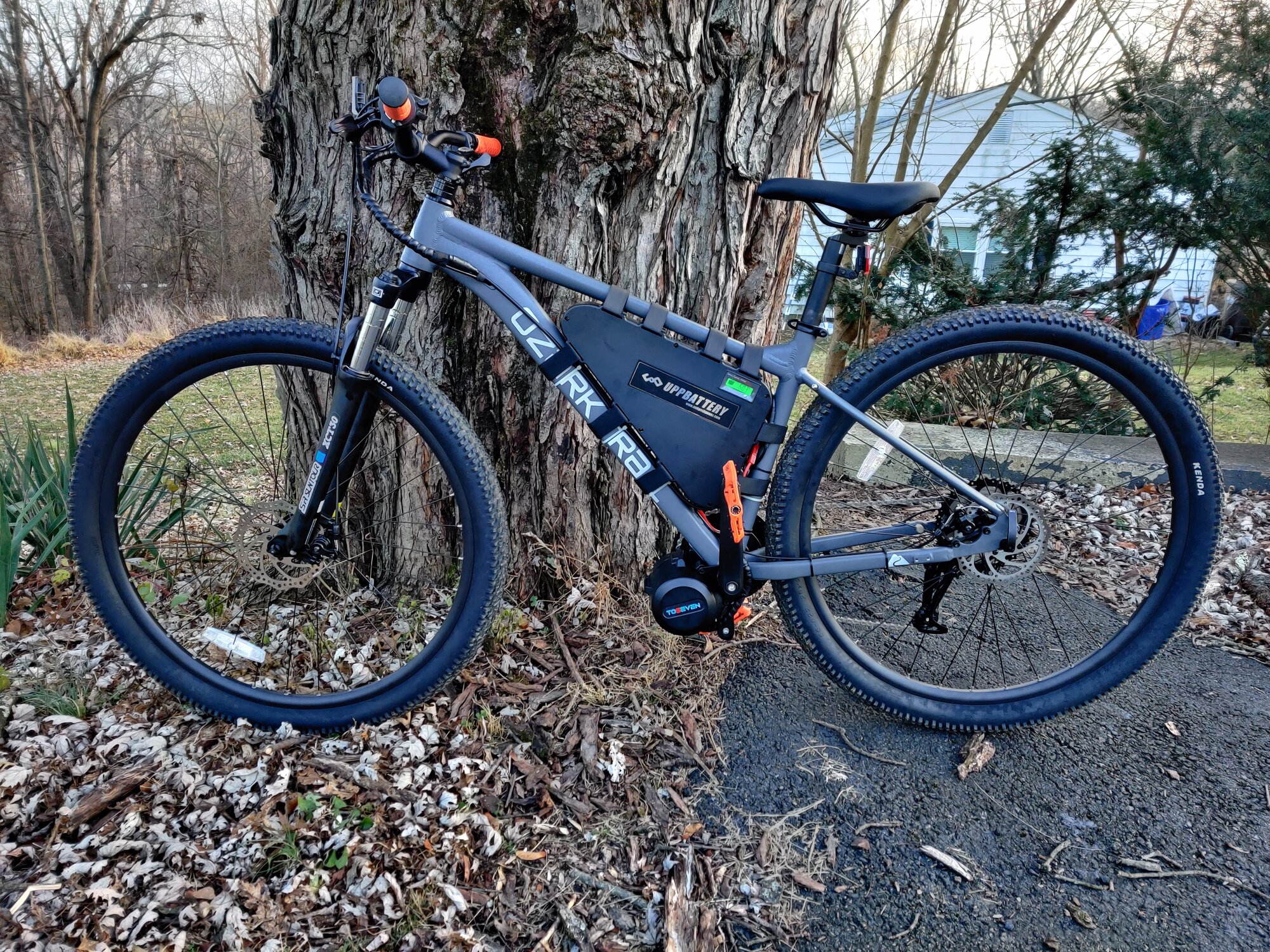

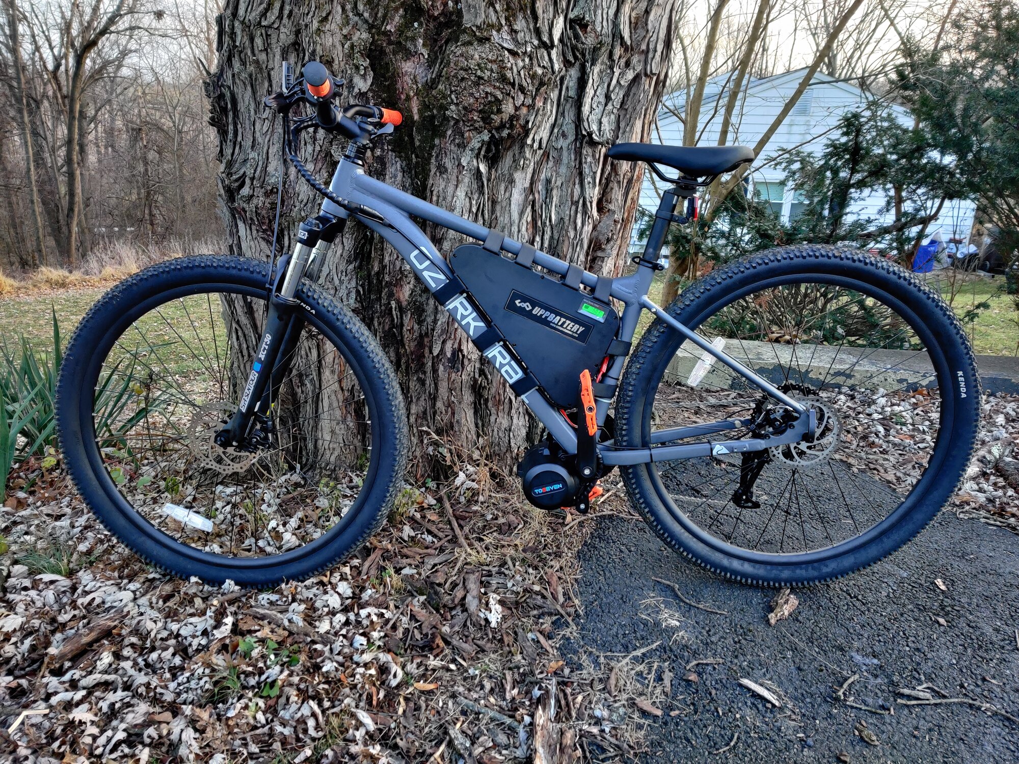

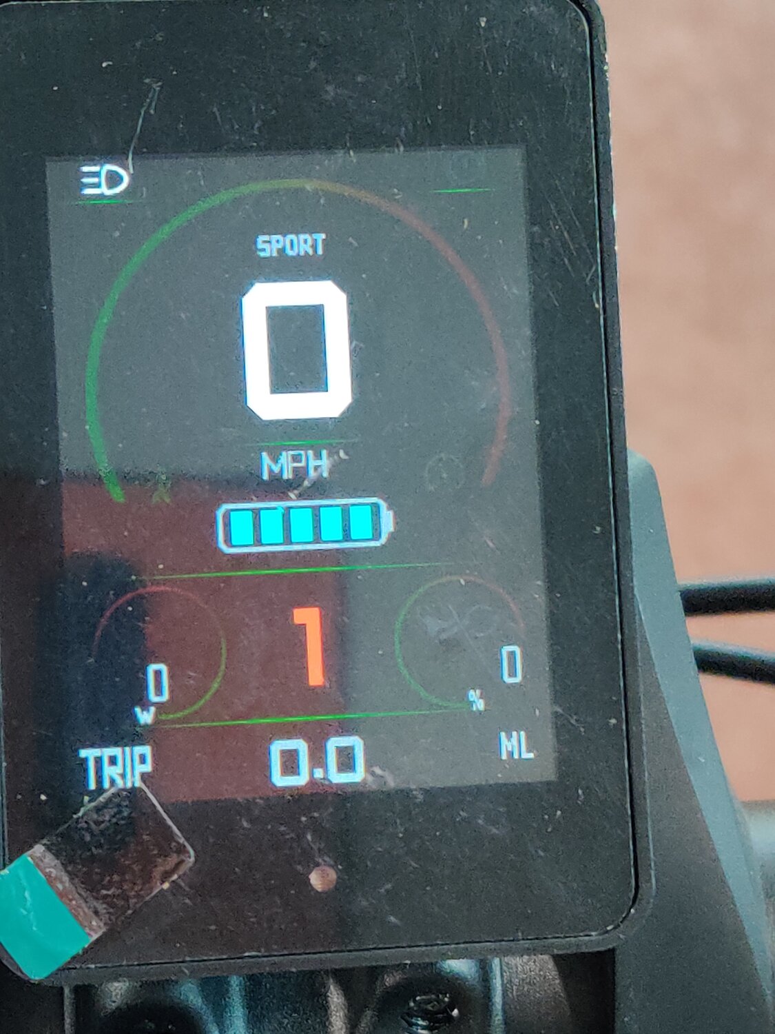

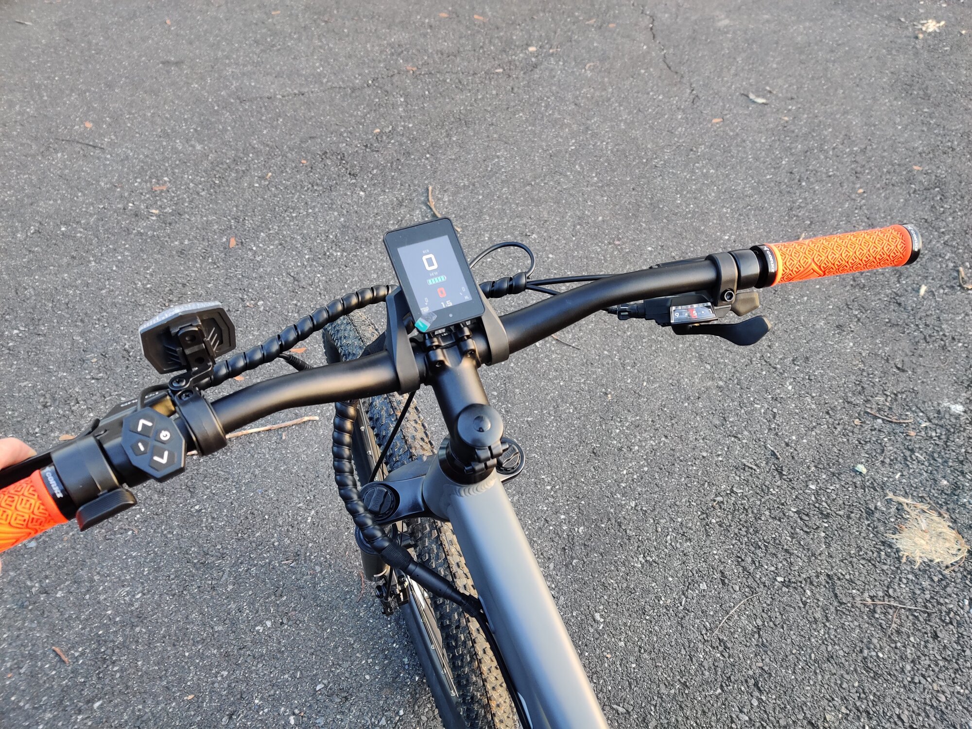

Ok, I finished the build this weekend. I'm using a budget Walmart bike (Ozark Trail Ridge), Toseven DM01 motor (from California Ebike), and a 60V 25ah battery 16S5P, Samsung 50E cells (from AliExpress UPP official store).
I need so spend more time riding, but so far it is fantastic... I love torque sensing since I mostly only run pedal assist. This will be my run to the store bike, I'm not comfortable locking up my Frey Beast outside.

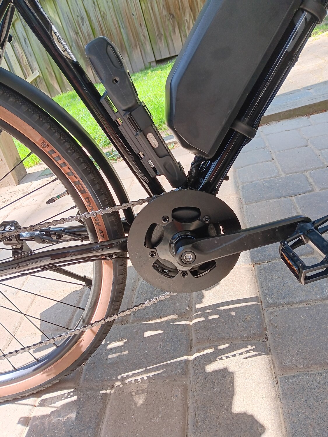

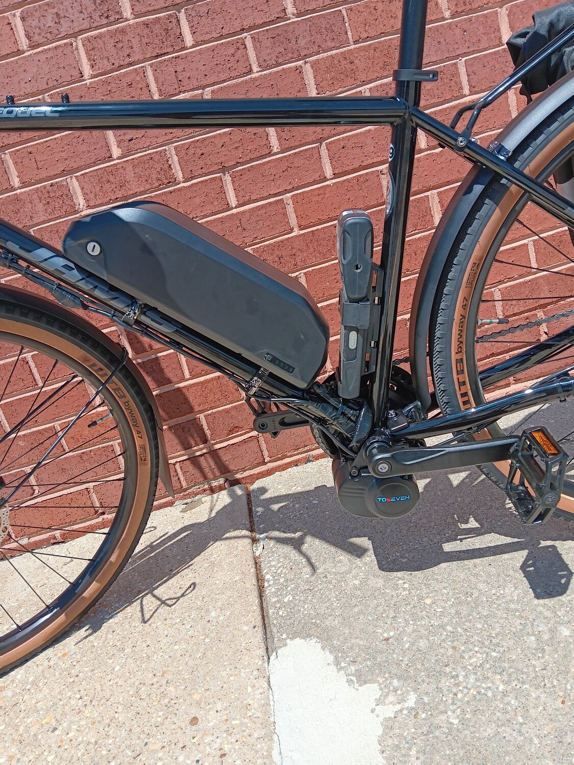

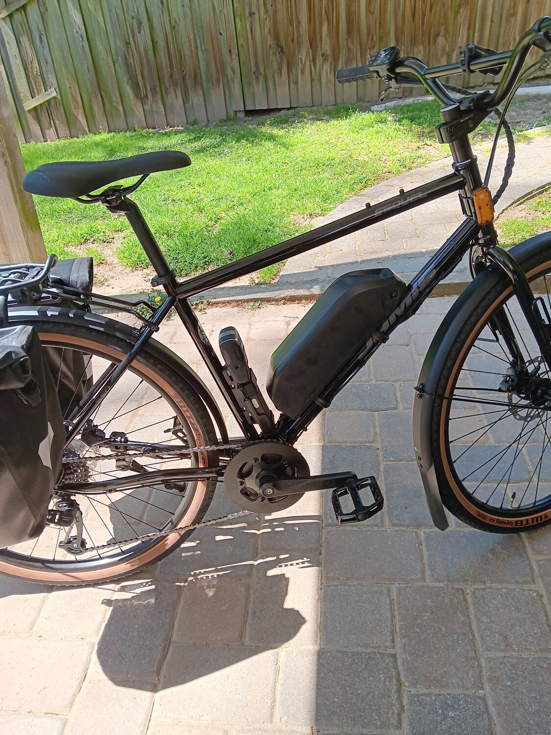

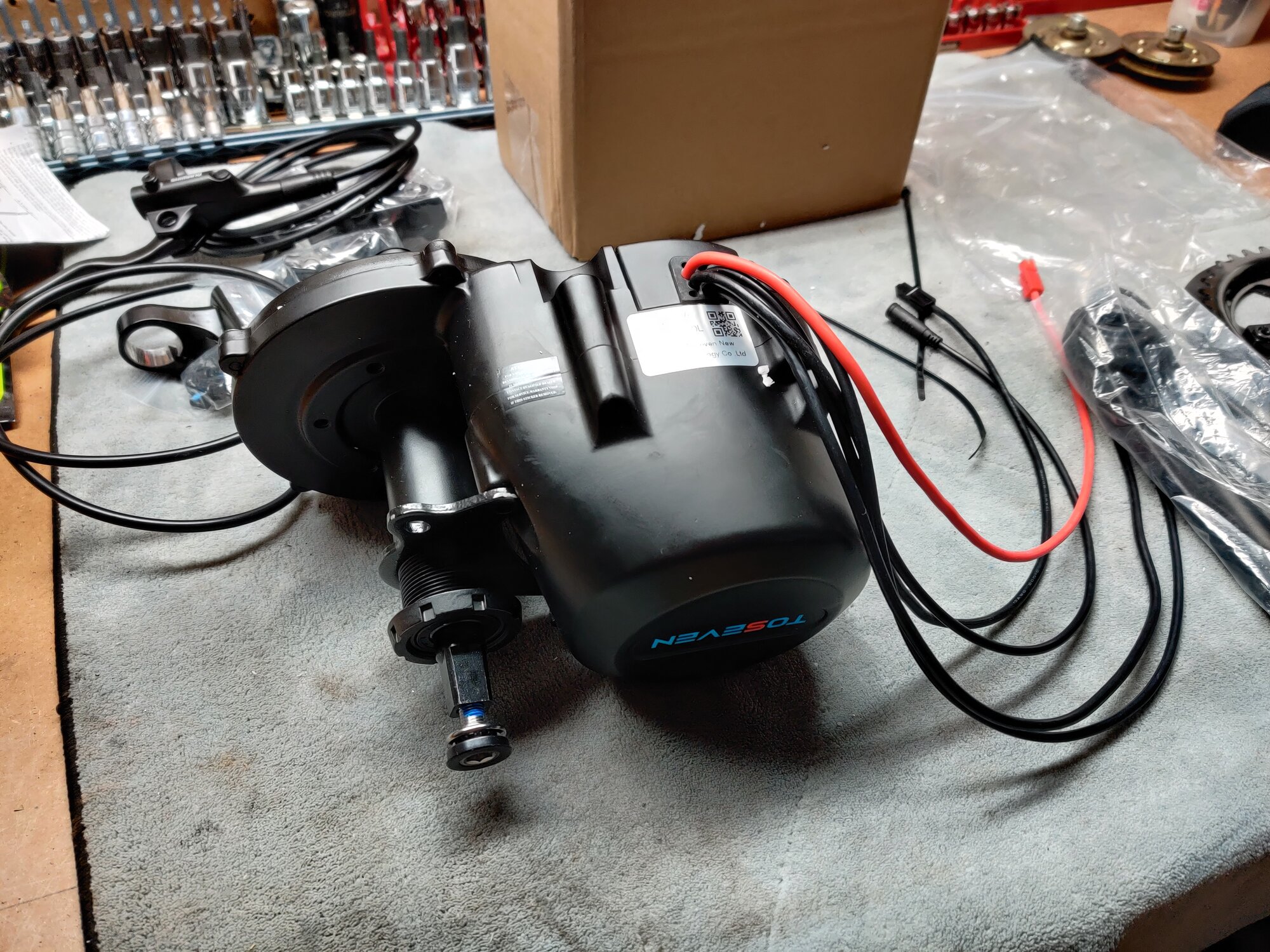

I just got my DMo2 and will have it on a bike this weekend, If it is anything like the Tsdz2b with OSF I am sure I will like it.

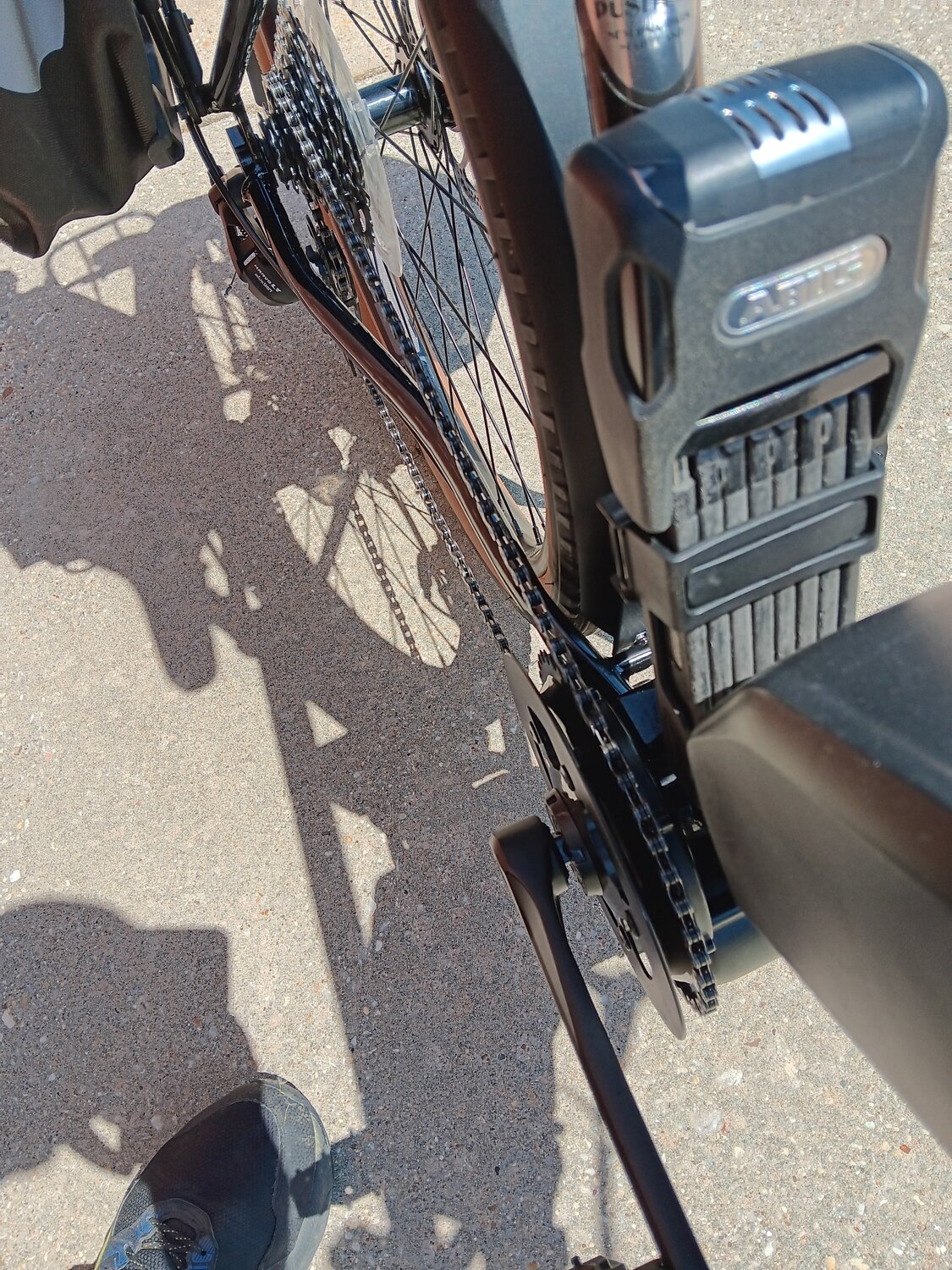

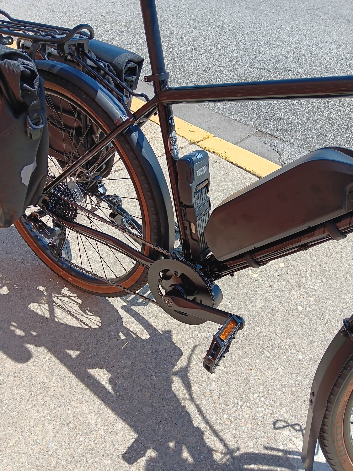

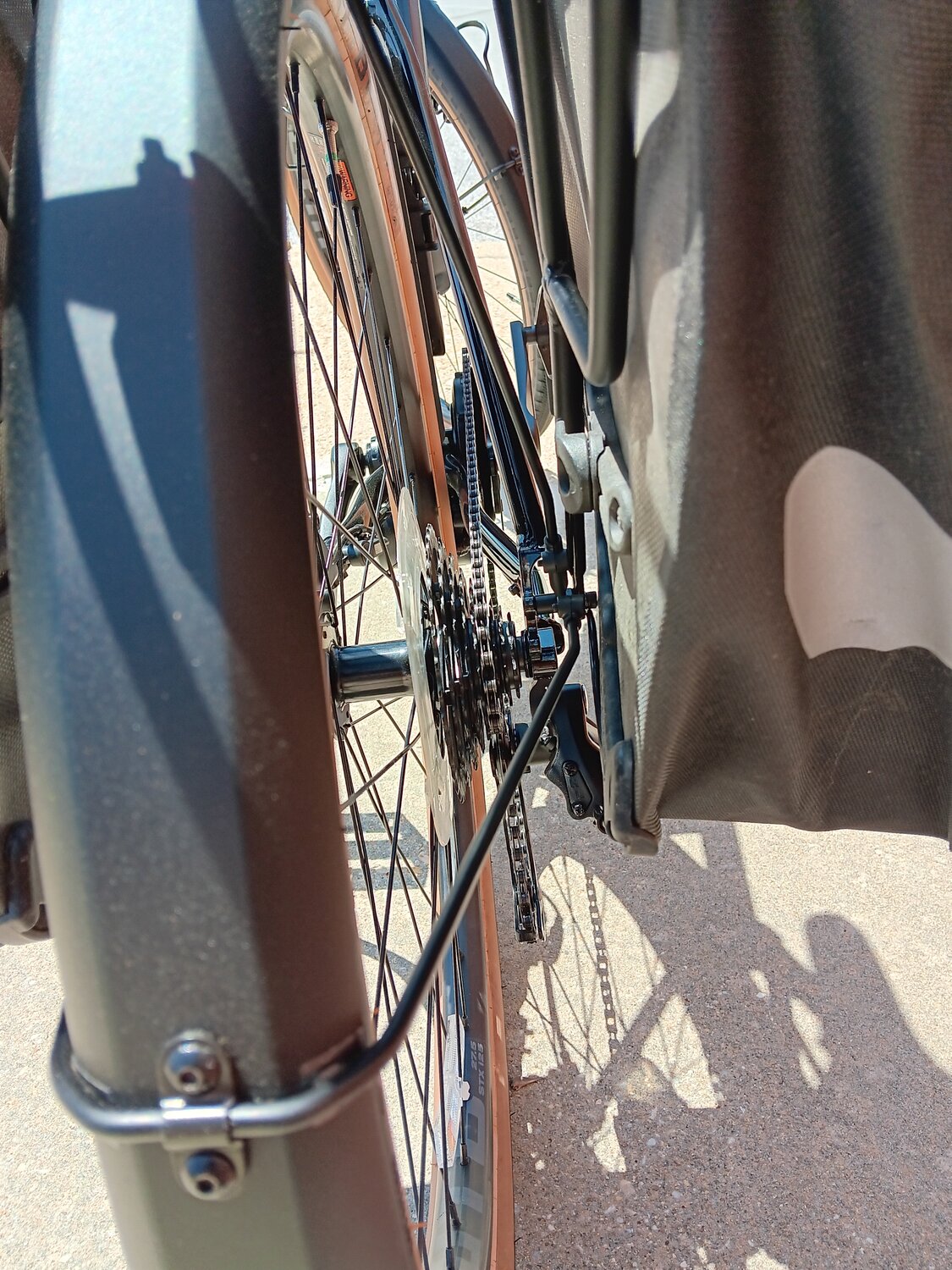

The DMo2 is on!

It feels more powerful than my Tsdz2b with osf. I need to get a programing cable to update the firmware though, The motor doesn't reengage fast enough after you stop and then start pedaling again and there is a run on after stopping.

I ended up damaging my frame on the Ozark Trail Ridge by not having a spacer between the motor and frame. In the meantime, I purchased an older Fuji Tahoe comp to ride. The Walmart bike was a vastly better ride, I've started looking for better frames that have a nice chainline with the DM01 (usually older 3X setups) while still having slack head tube angle.
I may build my own battery and use something like a Mongoose Salvo or older Enduro bike. The Nishiki Colorado has an elevated chainstay which would also work nice for a hard tail.
