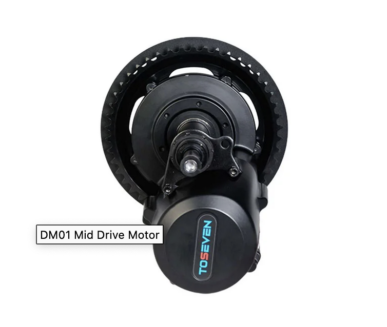

This came up on my screen today. The DM01 is kind of a BBSHD with Torque Sensing. Weighs 6kg......Square taper cranks, when are they going to get with the splined program over there? Supposedly developed by an ex Bafang engineer.
The DM02 is alot lighter @3.6kg or so and a competitor to the TongShen TSDZ2 and looks virtually the same?
There are some video's of them in operation and they sound pretty loud although they say in the factory information that the 01 is only 50db but it sure sounds louder than that. Looks like nylon gears also which might melt, or might not....
So they look like a mix/best of the BBS and TSD.
So for me the big question is... Is it end user manufacturer supported programmable or are we playing more of the hack game.
Chainring is spindle mount... Kinda/sorta 🤣🤣
