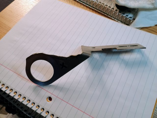

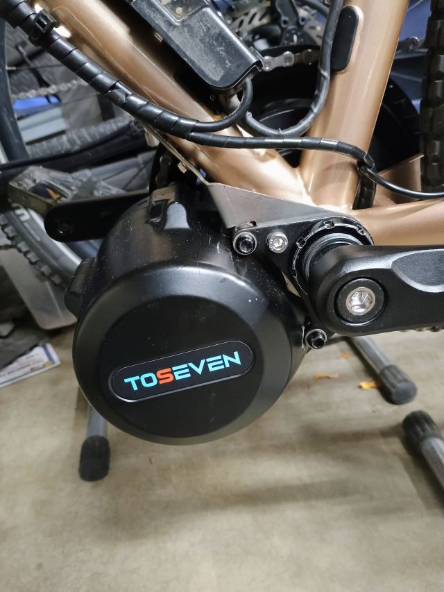

A california ebike BBSHD suspension brace can be made to work. The attached pic of the brace only isnt the final version (originally used on a BBSHD install, then I tried several things that didnt work so more metal was removed than on the final version). The final version cut off the two ears that bolted to the BBSHD and a new hole was drilled to match a new hole on the DM01 mounting bracket and they were bolted together. The motor is as high as it can be (toucheds downtube).

There is a small gap between motor and downtube of about a mm. On the DM01 there is a bump on the motor for a mounting bolt that hits the downtube first. I will likely ground it down next time I have it apart to get the motor a tad higher. My DM01 is same height as 46t chainring and the wires are below that. Never had any ground clearance issues including many raised cattle guards I encounter everyday.
I wanted to use two lockrings from my BBSHD but the DM01 is slightly different lockring size than BBSHD by about 0.6mm so no go there.
