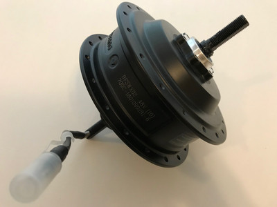

A search in this forum will reveal that there have been instances of various degrees of noice coming from the hub. I just opened a Tech Support case with Juicedbikes to see if we can correct this. I purchased the bike on August 20, 2019 (about 20 days ago) and it has about 140 miles on it.
In the video the grind does not sound like much but in real life it does not sound normal. The bike just started doing this noise and I have confirmed that it is coming from the hub. It is random (comes and goes) under all circumstances (pedaling, gear, assist level and using the accelerator).
I will be traveling for a month with limited internet access but any feedback will be appreciated. I will keep you posted on Juice's response to my request to exchange the rear wheel.
To me it sounds more tinny than grinding. It's not insignificant, and should be addressed. I had an ebike that made a similar type sound, turned out it was the hub motor machine screws needed to be tightened every once in awhile. I used a torque wrench set to 4 or 5 newton meters. The tinny harmonic vibration went away. Same type of sound can happen with the rotor attached to the hub, if not properly torqued.

UPDATE! Well Juiced bike came through with flying colors. At first they wanted me to send the wheel in and wait for a replacement, but I informed them that I did not want to be without a bike while I waited for a new wheel. I offered to buy the replacement wheel and get reimbursed when they receive the defective wheel from me, but instead, Juiced did one better. They hired a local mechanic and sent him the wheel. The mechanic came to my house, replaced the wheel and handled the exchange - all with no cost or hassle to me. WAY TO GO JUICED!!!

This grinding noise is an odd problem. I started to experience it around 4k miles and over a month ago thought it was gonna die soon, but it's still going & only once since then have I heard the grind. The wanted me to return the wheel then too, but considering the shipping cost I bought a replacement clutch to attempt a fix myself when it does finally go bad.
What motor is used? Changing a clutch gear assembly in a geared hub is covered all over the internets
. A new clutch gear assembly is no more than $75. But I’m punting as I don’t know which motor you fellas have.
I have already taken apart the motor from my CC so I know what to expect & already have the clutch assembly bought from Ebay on hand. When I took it the CC motor apart the gears looked fine so if it's a mechanical issue then likely inside the clutch mechanism itself? Just bothering me that I'm now experiencing it on the CCX, but it's not consistent yet so I can't fully say that the clutch gear assembly is the culprit.
Just had a MAC, gears ok clutch replaced. 4000 miles isn’t at all outrageously soon. Man, I’m stunned that we’d have to pay $160 in shipping for a $100 labor and parts project. That’s nuts!
