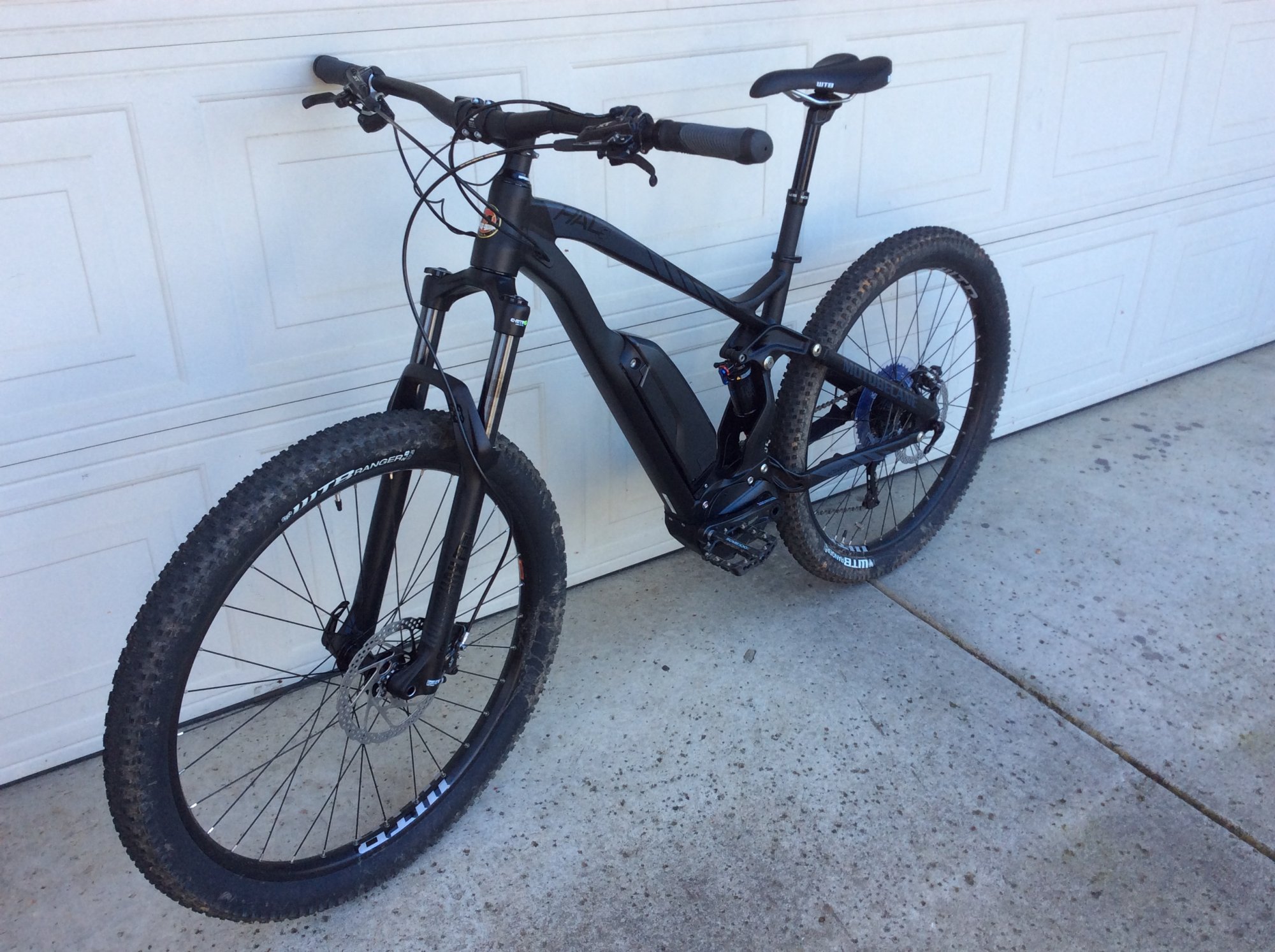

The infamous Motobecane HAL E-MTB. I bought one…
I bought the 42cm size. I am 5'10" with a 32" inseam. The size feels about right. I am 64 (hence the emtb; it's very steep and hilly where I live).

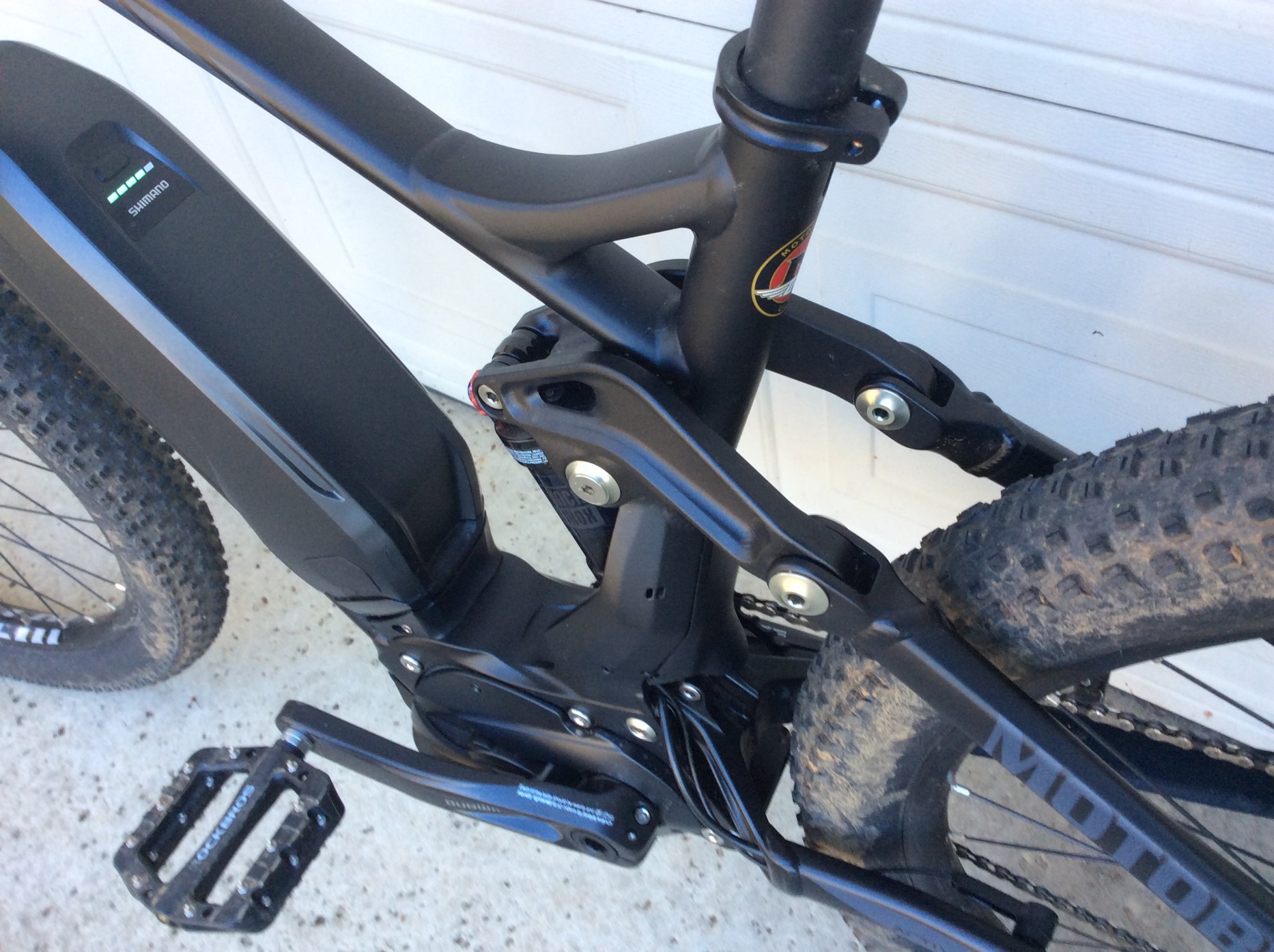

The measurement from crank center to center of seat post clamp is 16.5" The distance from the crank center to seat rails clamp (using LEV dropper post) is 26.5" at full dropper extension (the way I have it set up).
Thanks again for checking that for us. So the 42cm HAL electric really is 42cm. Which with the stock 100mm dropper post is going to leave me 8mm short without changing to a longer dropper.

The factory dropper that is now included is also 385mm overall so in order to get the extra seat height above where your seat post is I would have to swap it for a longer post such as the 415 version of the 9point8 with 25mm offset.
I'm curious if you run into what I did with the two Motobecane ebikes I assembled that came with droppers. In both cases, the droppers' internally routed cable housings were pinched by the motor such that the housings wouldn't budge to allow for seatpost height adjustments. The motors thus had to be "dropped" to reposition them for proper functioning...

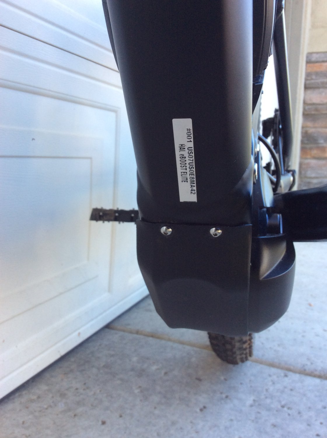

Giantsteppin.. I know the 504wh battery will fit but I don’t think the 630wh will. That said, no issues on battery life. I’m on a time crunch now but can give more details later. As I’ve said, I’m waiting for the delivery of my 2nd eboost Elite so I’m a fan..

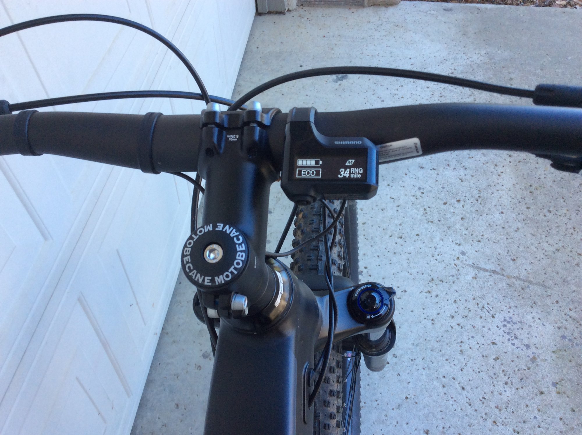

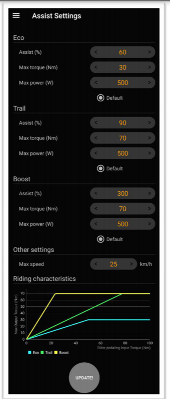

My average every other day ride is 9-15 miles up and down with some rock garden stuff. I have the E7000 setup in mid on ECO and low on both TRAIL and BOOST. I try to stay fully in ECO every third ride. Otherwise I’ll use TRAIL up the steep rocky stuff. I charge the battery every 3 rides and have never been down below 2 out of 5 battery bars. You will be crazy happy with the ELITE. You’ll want to spend about another $100 to get it perfect. A Shimano e7000 chain guide, rim tape (I use Gorilla Tape), tubless stems, tubless tire sealant, good flat pedals and grips to your taste (I use ergonomic grips). You’ll also need the shimano steps chainring removal tool to install the chain guide.
Very nice !!!! Just ordered one. Back ordered till mid may, heck not a problem. I had given up on being able to get one since I first started looking at them last fall.

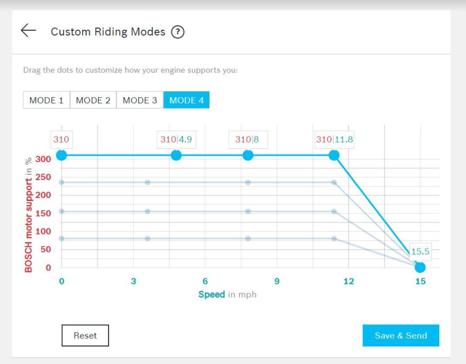

I have a 50 nm Bosch gravel and a 70nm e8000 Marin emtb so I did a bit of research on the E7000. E7000 came out after E8000. It is said that E7000 is very much like an early Ep8 engine but they had to neuter it to keep the price points correct and they simply wanted to get something out there to be competitive in a market they have really dropped the ball on. (I know most people know about this but some don't so here goes). One way to find out is to use Steps Unlocker (StUnlocker) and set your own torque values at different levels which I will do to test it by setting it to 1.15% = 70nm higher than max and check for engine overheating..and see if it pulls close to my e8.(just for fun will not keep it at that for long.) Btw, no ebike maker knows what your legs like on a given day. StUnlocker lets you set your assist levels to any % you want from (0-100+) (Gestapo Bosch has not such 3rd party app yet except for speed delimiting [I am using volspeed on the bosch motor for that].) I know what kind of training I want to do at the given eco, trail, boost modes and it is certainly not always at 33,66,100% (low, medium, high) in a given mode. My dealer said he did not have a problem with it me using it YRMV but anyway, i went ahead and shelled out for the SM-PCE2 which is the same diagnostics device they have so I can use etube to clear and check diag codes and any firmware mode code from StUnlocker being used if necessary.
Here is an early writeup on E7 I found interesting. "On the trail, the E7000 motor can easily keep up with the stronger E8000 version, even at maximum output. Only when riding in the wrong gear or at too low a cadence will you notice the10 Nm torque less." (iow, the torque sensor is tuned differently lol.)
To make a long story short (ya) I know that I will be fine with a 60nm torque limit (which I will set it back to)...I am really pretty fine with a 50nm and able to keep up with all the in town speed demon racer rides we do so....Btw, there is also videos on youtube testing one against the other and of course they find E8 is brute stronger on a non technical climb but some felt the E7 was easier to clear stuff in technical terrain. I find that really kinda silly as I simply set my boost mode properly on my E8 lower so to modulate it better so it doesn't shoot out from under me on the gnarly steep stuff if I decide to use it. But still the lower torque value and sensor settings "seem" to modulates in rough terrain. :) Fun stuff ! Still giddy at getting one these are incredible deals even with the price increase.

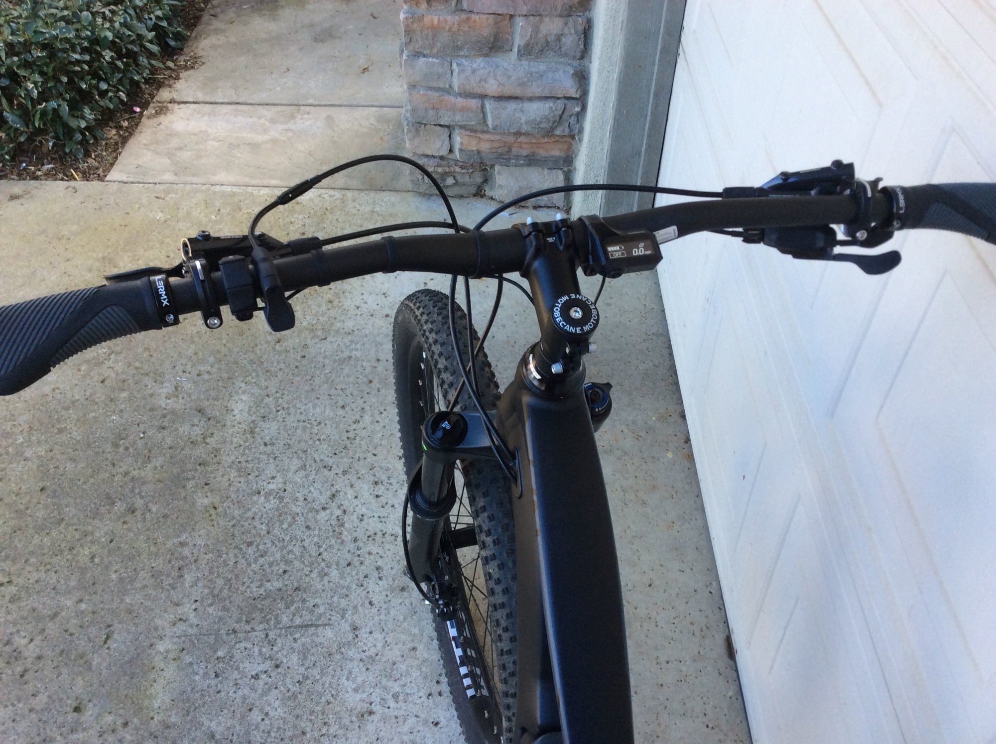

Shimano E8000 controller at right, Elemnt Bolt bike computer added at top. The Bolt monitors and records GPS track, speed, distance, pedaling cadence, heart rate and calories burned and uploads workouts to Strava.

To make a long story short I know that I will be fine with a 60nm torque limit (which I will set it back to)...I am really pretty fine with a 50nm and able to keep up with all the in town speed demon racer rides we do so....Btw, there is also videos on youtube testing one against the other and of course they find E8 is brute stronger on a non technical climb but some felt the E7 was easier to clear stuff in technical terrain. I find that really kinda silly as I simply set my boost mode properly on my E8 lower so to modulate it better so it doesn't shoot out from under me on the gnarly steep stuff. So, then easy to understand why the e7 "seems" to modulates in rough terrain. Fun stuff !
Congratulations on the new BD with the E7000 and thanks for sharing the article. :)
Nice to know that Shimano allows a great deal of user control on the motor settings.

True that. I have a Bosch on my gravel bike and this E7000 will be my second Shim motor adding to my E8000 on my other mtb. Reason is simple I hate the gestapo tactics of Bosch. Not only do they lock you into modes with no ability to adjust the assist levels at there 4 modes, but they make hacking it for third parties very very difficult as well as their with their batteries potentially bricking themselves if you try and replace the cells I have heard...at least though I found a guy who if you send him your battery he will guarantee it for a year after replacing the cells for only 260 bucks shipped. :) Oh yea, and overpriced. My E8000 I use StUnlocker and easily set my level I want 0-100+% at the various modes. Eplus is working on a solution to be able to do that with the Bosch motors but it so much harder to do than with Shim's that it is taking them years. Not to mention the fact that Bosch used to have a system that allowed user to set their own assist levels and for some inexplicable reason they took it away ! Now, I love how quiet the Bosch is compared to the growling loudly E8000 as well as the E8's "clunk" when engaging verses smoother Bosch. But, again, can't get over.....ya know...
Ps, Bosch you can't buy a tool to reset the notorious I think it is 504* error, dealer only. As you know Shim you can buy your own tool Sm-PCE2 to do diagnostics and reset.*I am NDA on which one but one of the big Bosch speed delimiting tools company is working on a tool to plug be able to bluetooth the Bosch engines and reset any codes you want. :) Supposed to be out this year.
