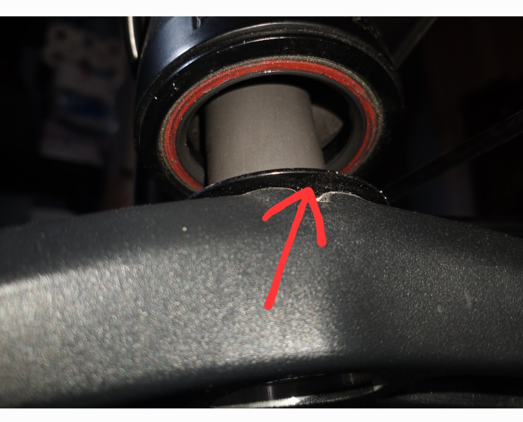

What is the length from the top of the double shoulder to the start of the bottom of the inverted leg?
I need between 12 to 24", for proper mounting of the 2 brackets...

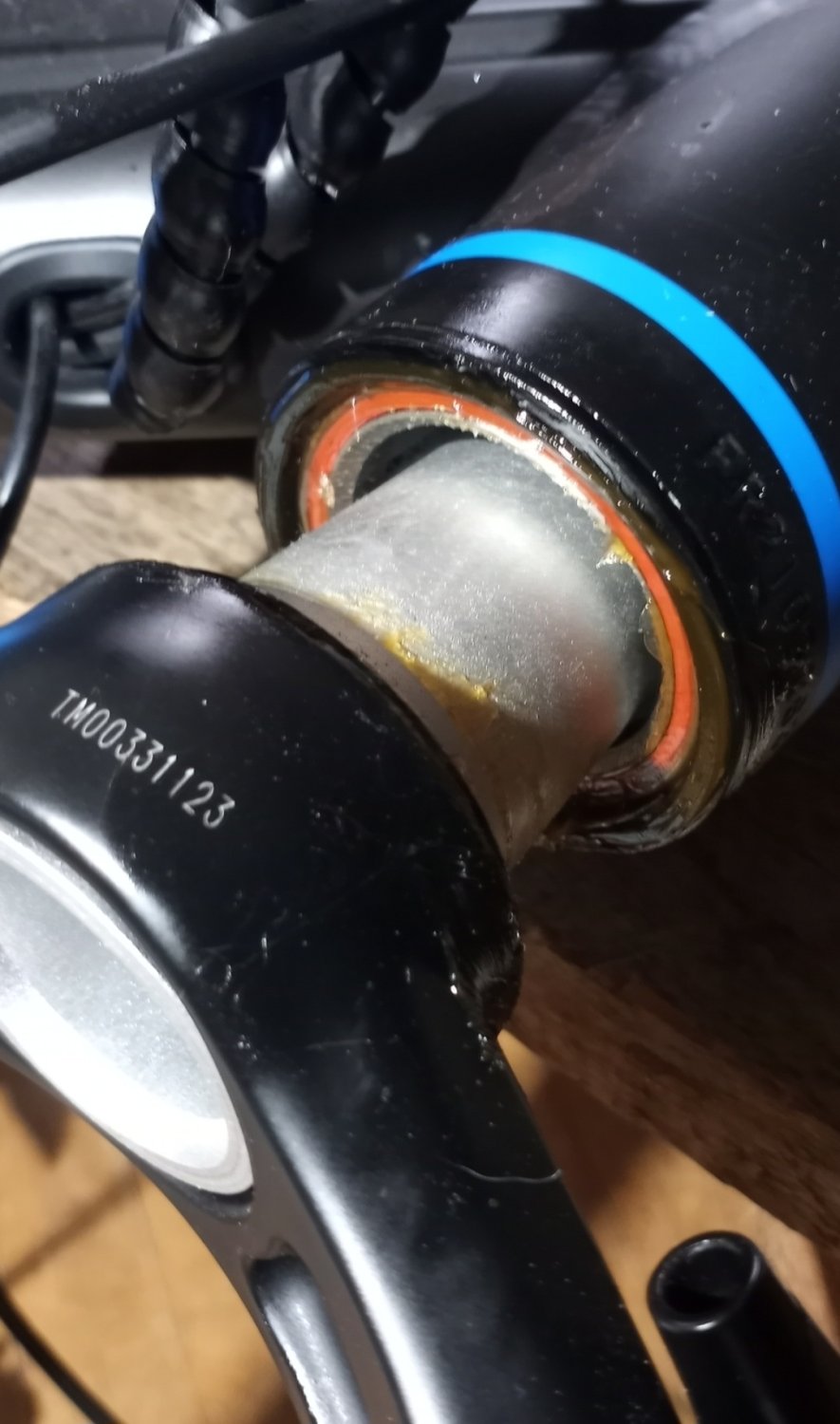

Ah PC,
When I went to school in the very early 60's, 135mm from 150mm was 15mm/.590" difference, divided by 2 = 7.5mm/.283" + or - approximately.
How did you come up with 12.5mm per side?
The brake side will be less than the non brake side...at least from my quick measurements, to keep the brake centered between the hydro brakes.
Or are we talking about something else/different ???
JJOYC = Just jerkin on your chain...lol

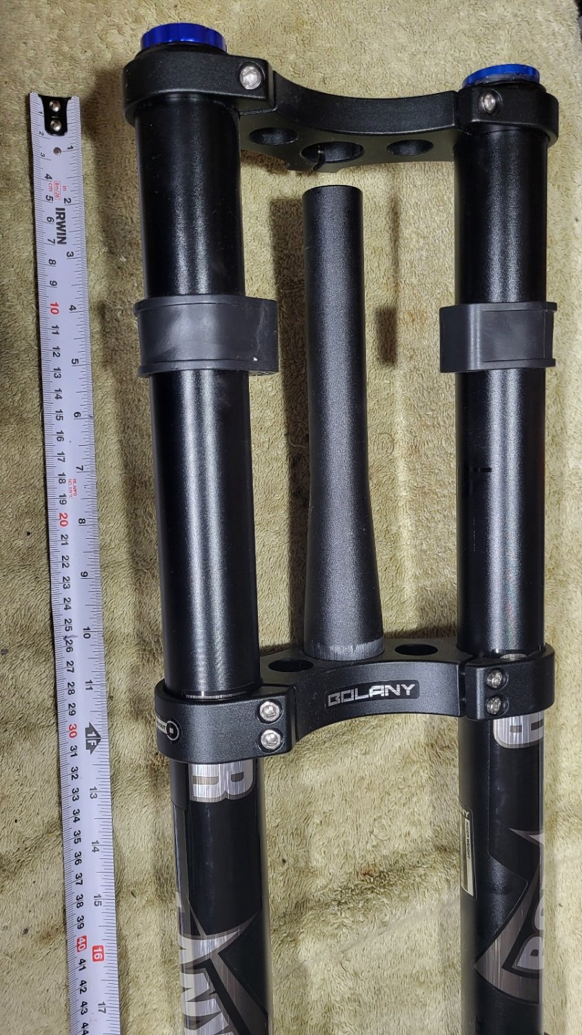

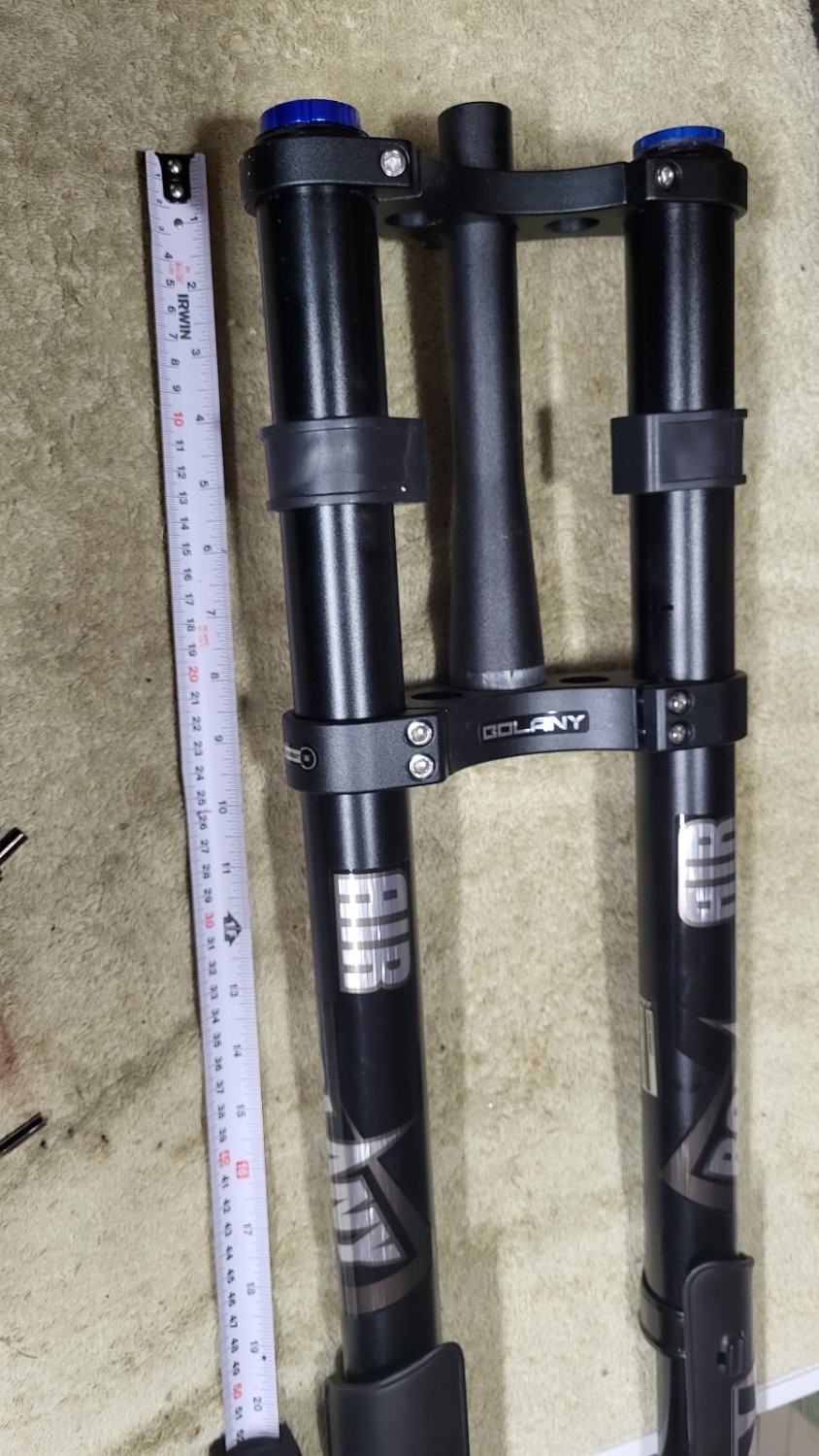

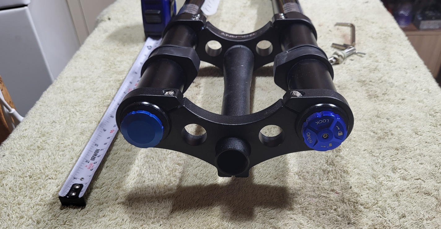

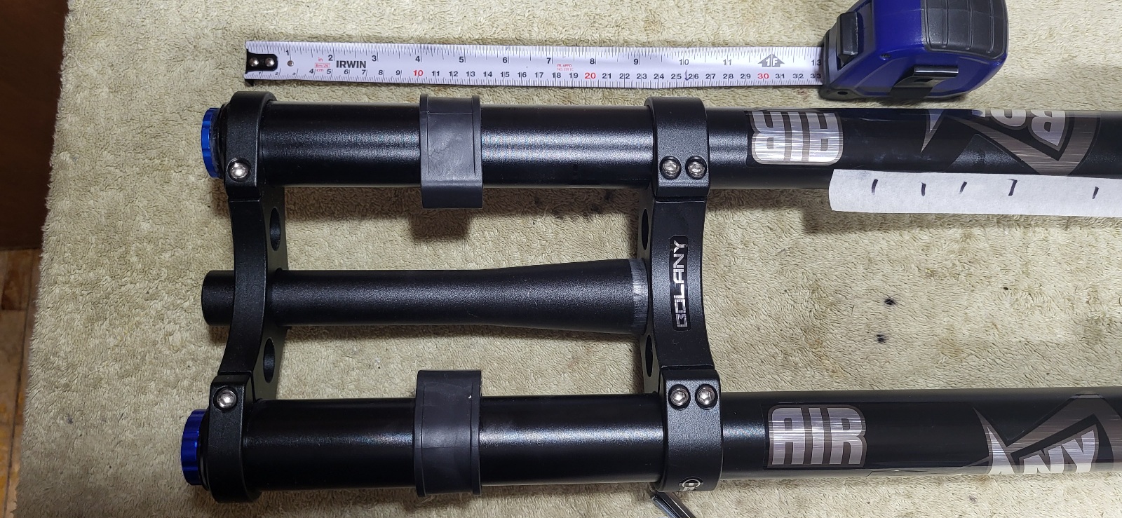

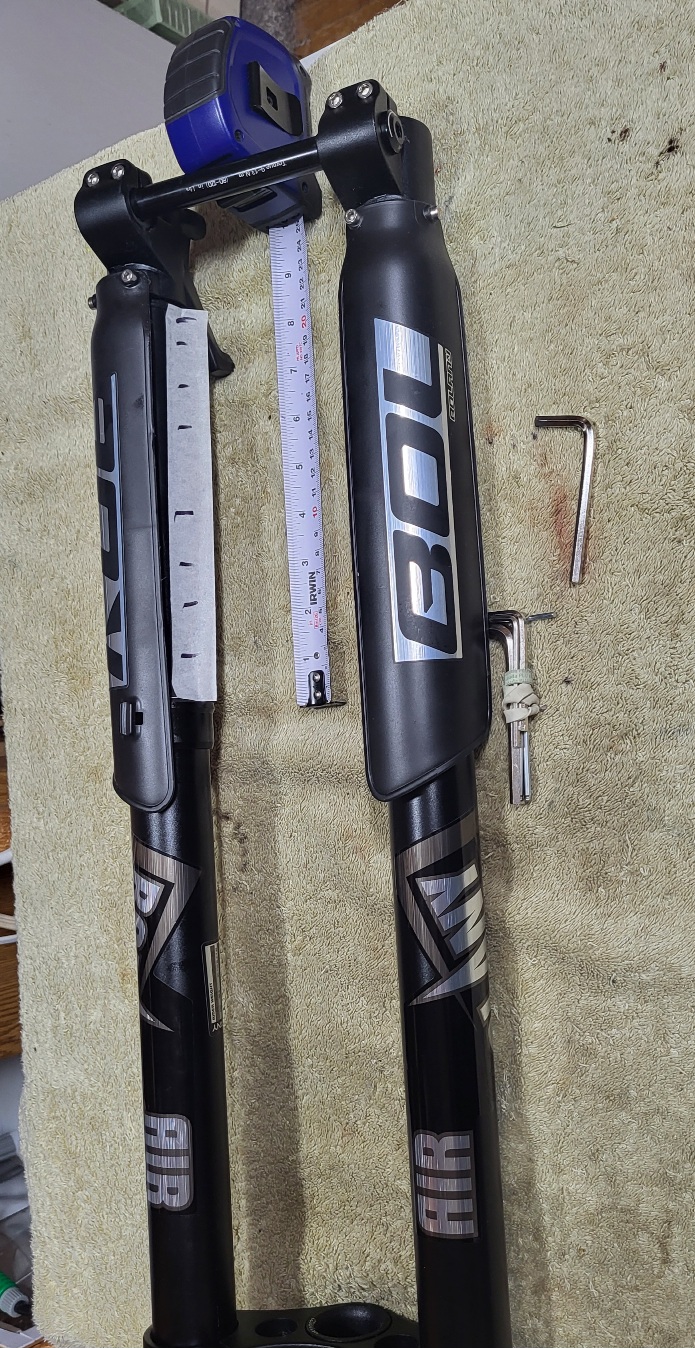

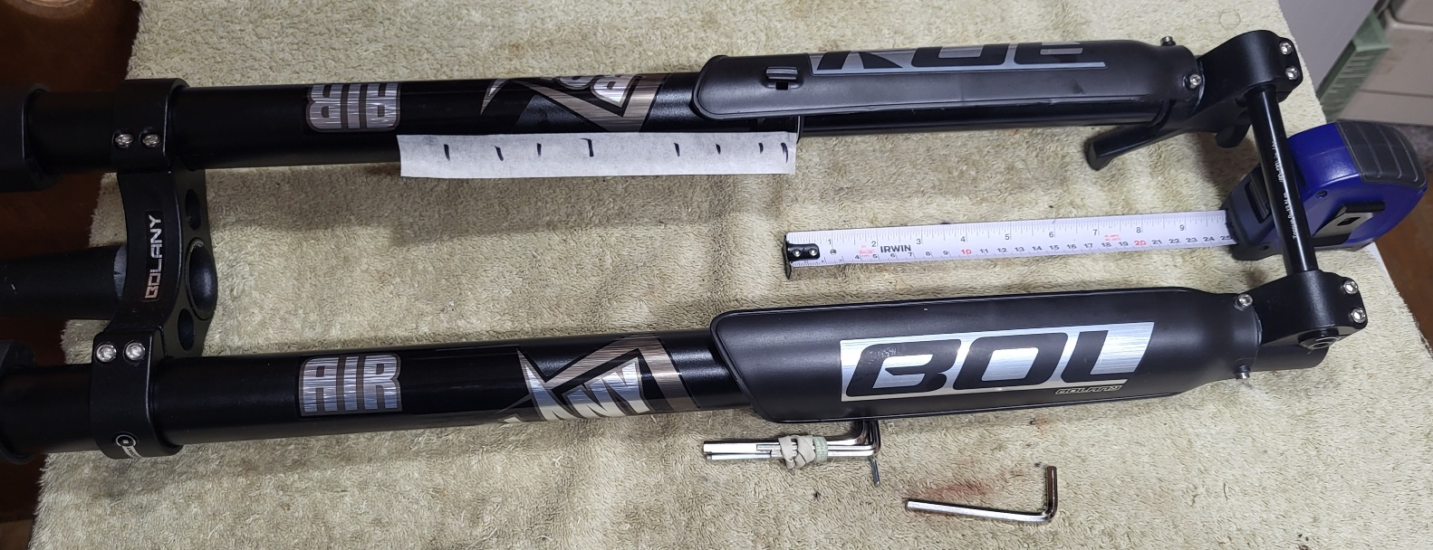

It's adjustable. Top and bottom. It depends on the length of the steering tube on your ebike frame.
My damn steerer tube was about a half inch too short to attach the steering stem,..
Don't adjust it this far.
That's too much. 😄
I put tape on the exposed stanchion, then put it on the over tube to show maximum compression,..
I think that you would have plenty of room ??
Keep in mind the offset fork tubes.
You'd have plenty of rotation before your bumpers hit, unless you're frame is in the way somehow ?

PC
Thanks for the photo's,
A rough measurement from my bike,
I would need approximately a 9-10" long steering tube length.
The frame is 7"+ in height, with the excess of the steering tube above the frame.
One item, I did NOT think about is. I will lose my front basket if I go this way,
using a double shoulder fork...)()*&%*$)*&()
If I understand all this right, to install a D shoulder fork, the top cross bar comes off, you add the bearing components to the steering stem, then add the top cross member and adjust to fit, and the handle bar stem lock sits on top of the top cross bar, to hold it all together?
It appears that there should be enough length, for what want to do. I just have to think about losing the front basket. If I can find a long enough (20-24") narrow width (12-13") basket, I can also use it for mounting the rifle carrying rack.
I have lots to think about...Thanks,
That sounds right.
I never did install the forks but I'm sure that's how it's done.
You tighten up the should braces after the fork tube is tightened up.

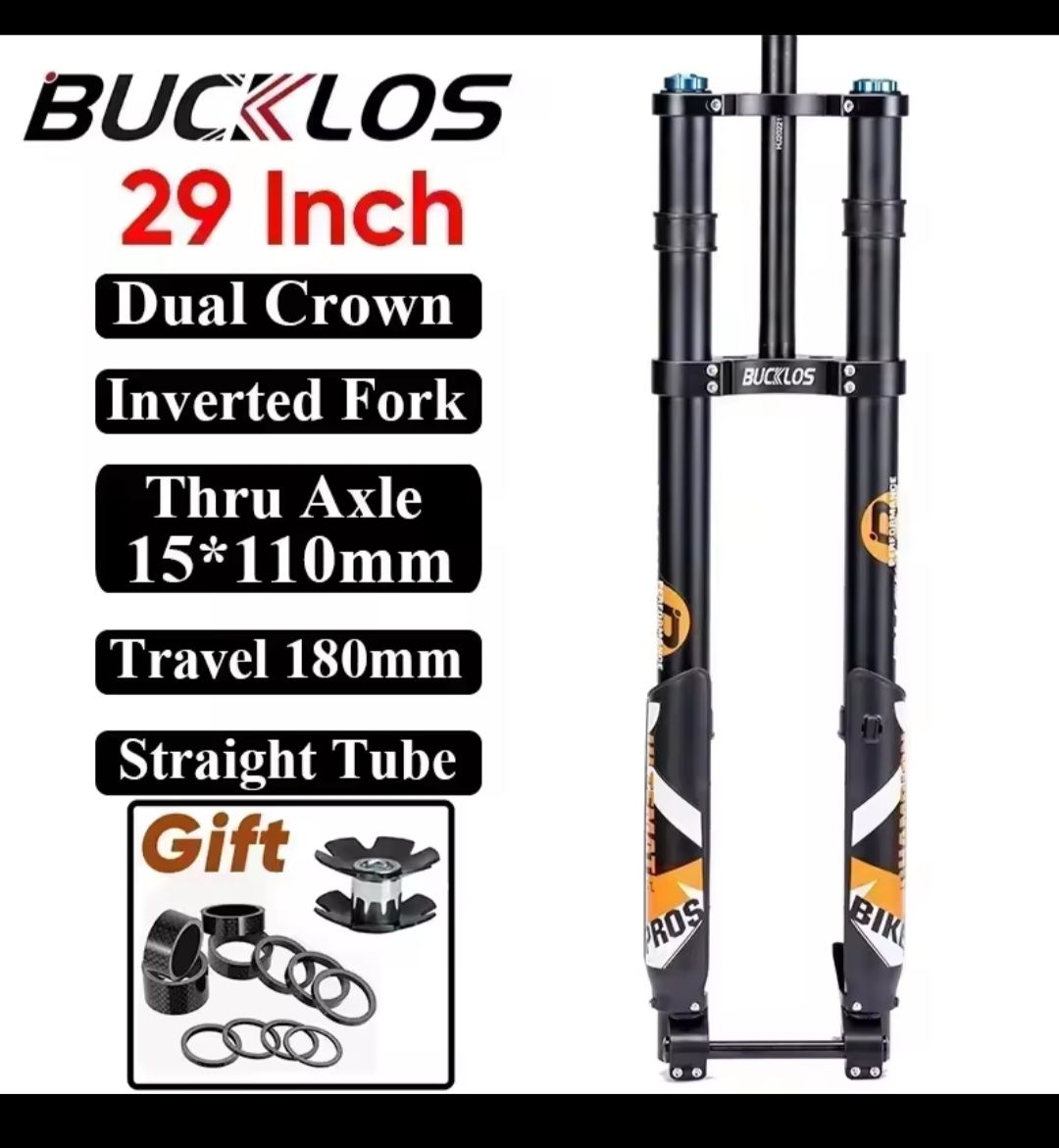

You'll need to know if you have a straight or tapered steerer tube.
Your best bet would be to remove your current forks and take some measurements.

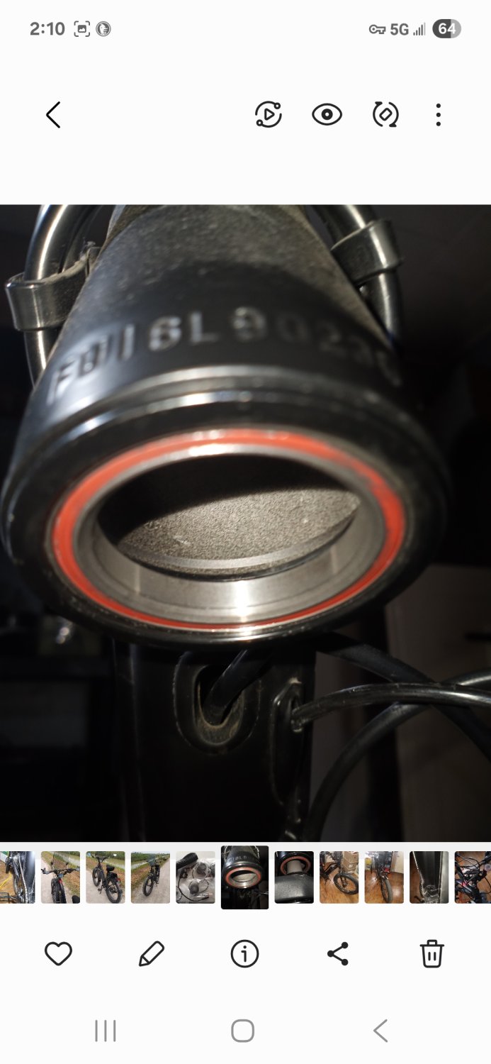

My Juggs 4 bike has these spec's for the steering stem =
Threadless 1-1/8" - 1-1/2" tapered,
I don't know the bottom/top bearing sizes yet.

PC
You don't need to know about the bearings, they're "installed" in the frame, not on the forks.
The fork dimensions are standard.
Even my extra long steering tube on my new ebike frame is a standard dimension.
The only thing that you should have to do is swap the "bearing race/fork seat" thing on to your new forks. 😁
It's basically a big spring loaded C-clip that supports the bearing race and steerer tube connection.
