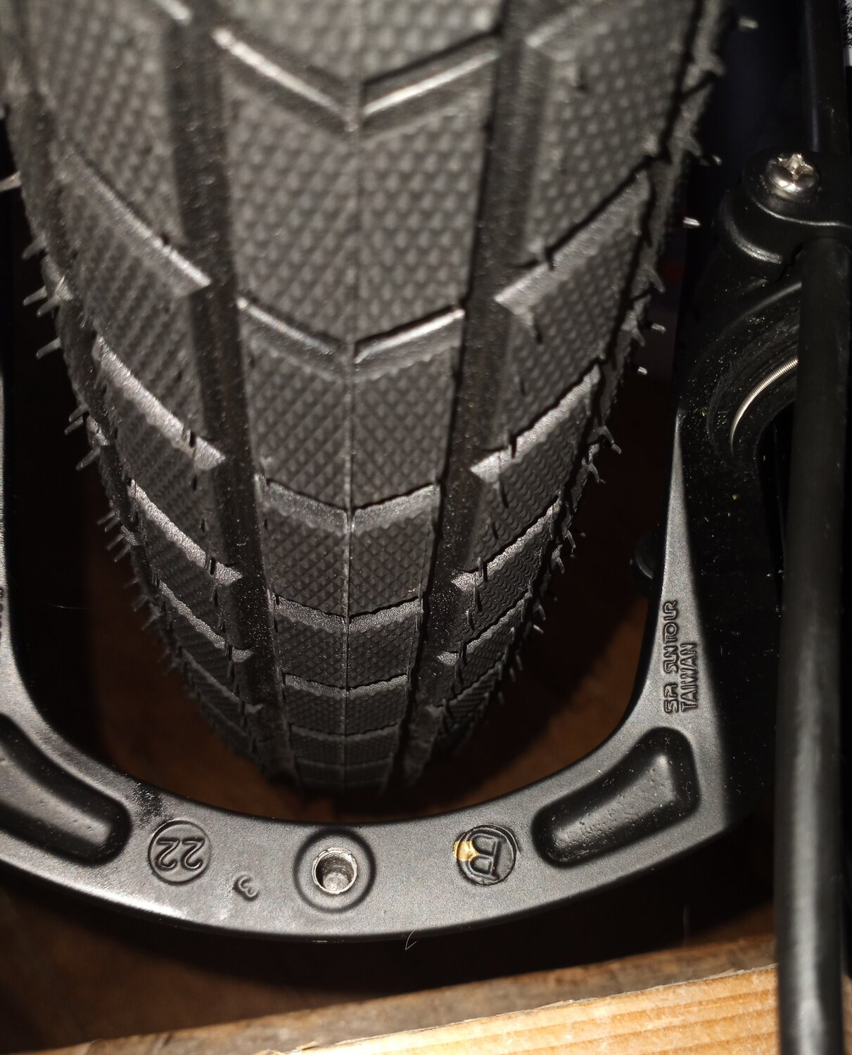

Check out this warped tire,..
There's nothing wrong with the rest of the wheel.
