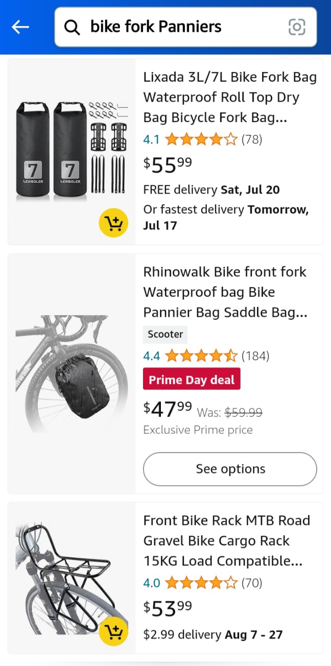

I'm thinking fork mounted panniers might be a good idea, especially if they're filled with the dense heavy stuff?

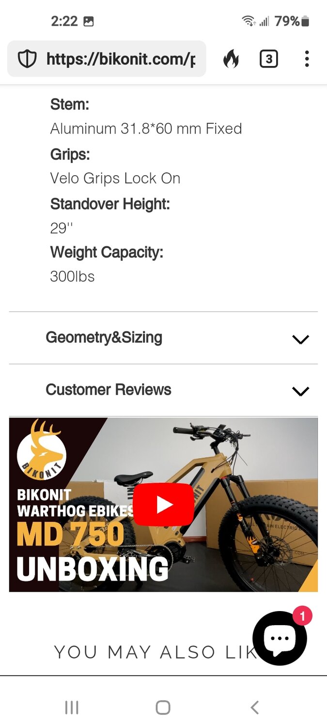

The max loads for the bikes includes the riders weight, so a 330# max load weight - 200#'s for the rider, leaves 125 #'s max load
I think that your Warthog has a 300# capacity, unless this isn't your exact year and model?
