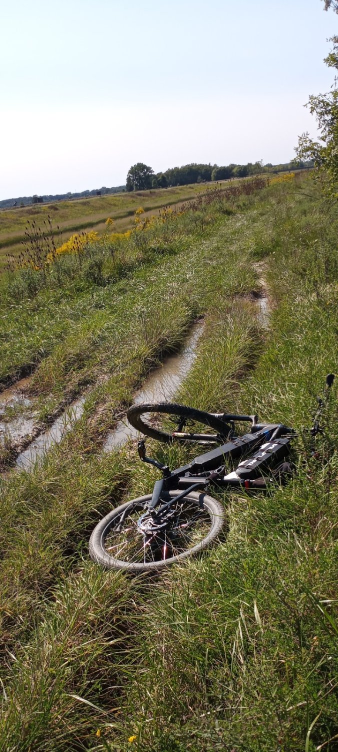

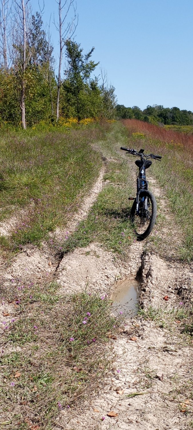

I disagree,..
There's no way I could ride in the ruts if I had to pedal,..
I don't want a pedal strike while cornering on pavement, so I don't pedal for clearance.
Having the power turn on and off while pulling G's around a corner is dangerous.
