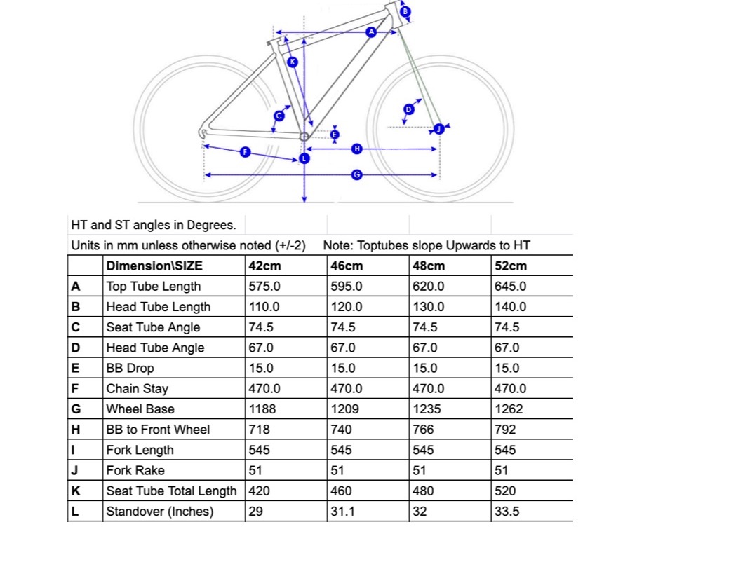

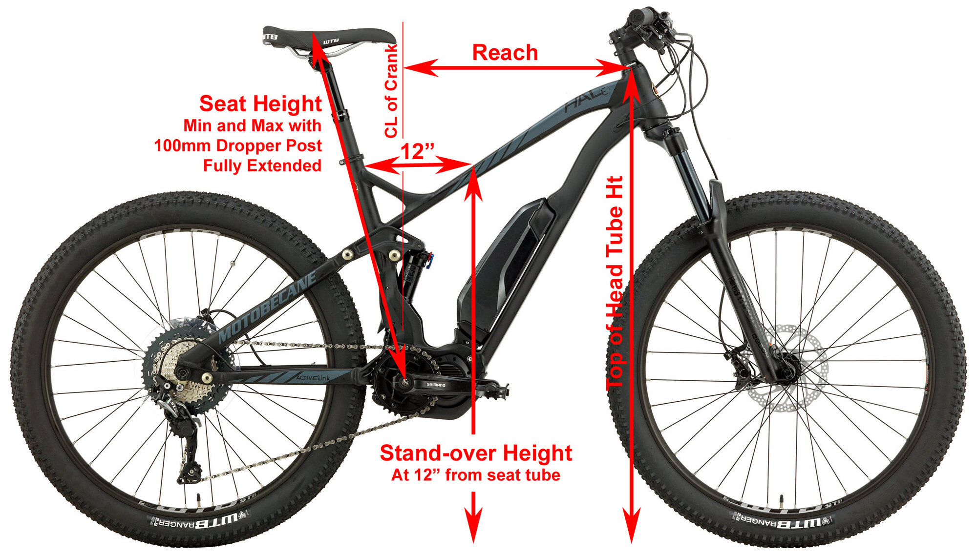

Can someone PLEASE help me with some size information on the Motobecane 27+ ELITE Full Suspension eMTB. This is for size 38cm and 42cm. I am in between sizes and because of the suspension obstructions within the seat tube, the seating height range becomes somewhat limited using the included 100mm dropper. Please include your frame size (38 or 42), Seat Height (min and max if you can), Reach, Stand-over, head tube heights and weight. Thank you.
Can someone PLEASE help me with some size information on the Motobecane 27+ ELITE Full Suspension eMTB. This is for size 38cm and 42cm. I am in between sizes and because of the suspension obstructions within the seat tube, the seating height range becomes somewhat limited using the included 100mm dropper. Please include your frame size (38 or 42), Seat Height (min and max if you can), Reach, Stand-over, and head tube heights. Thank you.

Yes, and they don't open the boxes, so getting an accurate answer is difficult. I figured there have been owners on this forum and hoped they could measure it. I also sent an email to Motobecane, but the email was kicked back. I'll post the answers if I get them so others will benefit. Amazed that such an important aspect of the bike is kept secret. Another well kept secret is a bikes weight, especially when it comes to ebikes. I added that to my post.

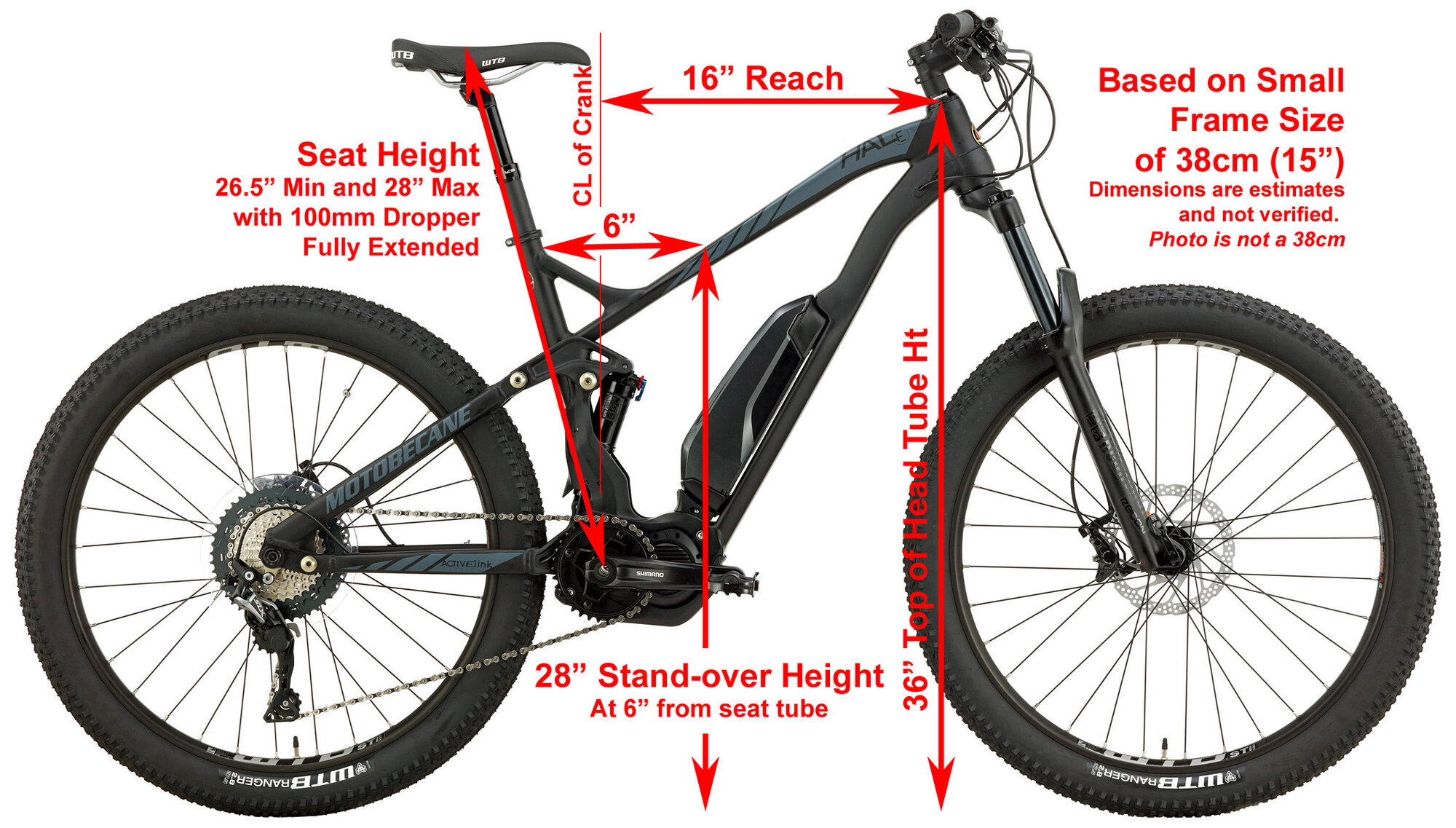

They used to publish these numbers-- I saved a screen shot of the ad for my bike before it was discontinued. It is the Motobecane in my avatar, also a 27.5, and the frame is not identical to yours, but similar. My bike was a 48-inch size and was 49 pounds out of the box, (Currently 46.5) yours shouldn't be that much heavier-- your motor is probably heavier, I don't have a dropper post, so that adds some weight on your bike. Or it could be lighter b/c it's a smaller size. So here are the numbers for a similar, though not identical, bike, please scroll down to the very bottom of the image for a diagram and measurements. 1,500 trouble-free miles, though yeah-- watch those damn bolts, check EVERY ride, and I got some shock squeaks, quick release sometimes pops open randomly. Love it, handles beautifully even on pavement, glued to the road during fast cornering. Hope that is helpful, at least vaguely.

I appreciate the input, but unfortunately NONE of the charts answer these 4 simple questions, and the seller can't either. That is why I came here hoping that someone with the actual bike can take the measurements. Can someone PLEASE help me with some size information on the Motobecane 27+ ELITE Full Suspension eMTB. This is for size 38cm and 42cm. I am in between sizes and because of the suspension obstructions within the seat tube, the seating height range becomes somewhat limited using the included 100mm dropper. Please include your frame size (38 or 42), Seat Height with the included 100mm dropper (min and max if you can), Reach, Stand-over, head tube heights and weight. And please make sure you are using the bike shown below that has the rear shock going back below the seat tube, not in front of it like most of their other bikes. Thank you.
You are unlikely to find anyone here who has this exact bike in one of these sizes. Try eMTB project and some other forums, but you may have to make your best guess based on what folks report about similar bikes.
It is true that my chart is no help for size 38, or for Head Tube Height and Seat Height. It is also true that measuring anything for my 48 would be no help.
However, reach and Standover on the chart my bike are likely to be similar to my bike for 42 inches. I would bet standover is a little less on your bike in a 42 than it is on the chart for my bike.
I found a few excellent photos on this forum of the 38cm and 42cm, scaled them in photoshop and derived the dimensions I needed. I am 5'-6", and because of the suspension obstructions, only the 38cm will barely work with the provided 100mm dropper, giving the seat height at about 26.5" minimum (28" maximum), reach at 16" (15" to top of stem), stand-over at 6" from post ~28" (I wrote 12", but it really should be 6"), stand-over at cl of bottom bracket is ~26" and top of headtube to ground is ~36". For what it is worth, I'm not sure if this is all relevant, for I think they discontinued the 27+ Elite.
