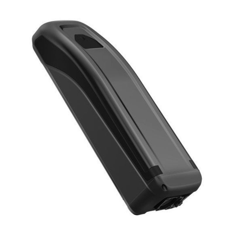

Well, what if I told you that you could travel light on 520 Wh one day but could use 680 or 880 Wh on a long trip?
- As light as possible
20.5 kg is OK?
Easy to mount, lightweight, front suspension (Future Shock). 520 Wh battery in the frame, available 160 Wh Range Extenders in the form of a water bottle.
