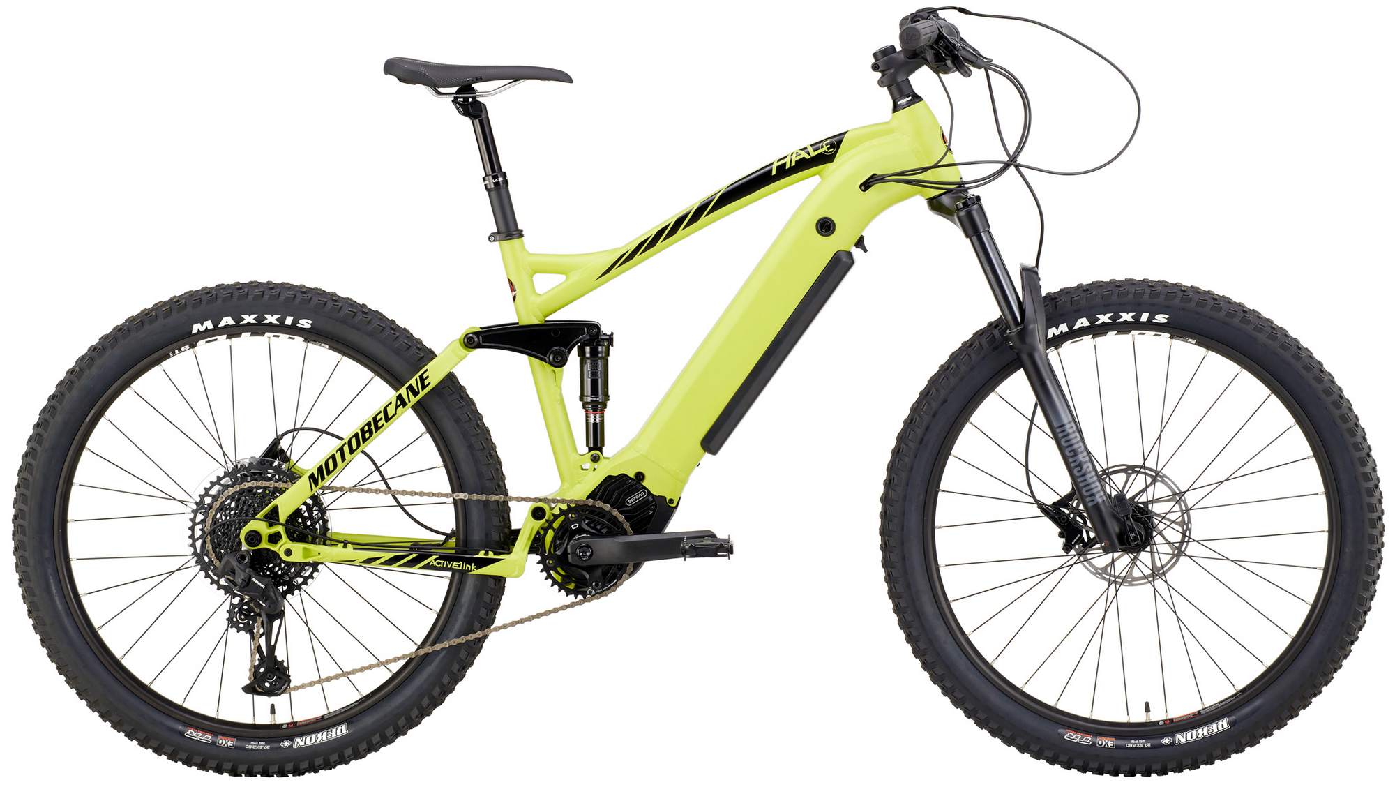

Can someone help, by telling me how to take cover off the front of the battery ? I pushed it on, not realizing that the bag taped to inside had something inside. And now it seems impossible to pull back off . Also, my charging port on frame does not charge ???? Thanks
The battery cover has 4 small screws accessible only from the inside of the cover, the battery has to be removed to get to them. My charging port didn't work when I got the bike, I called Bikes Direct and they told me to remove the battery and loosen the battery contacts and adjust them until the port works. This did fix it but it was a hassle, I loosened the bolts to the battery contacts then plugged in the charger and moved it around until it was charging. After that I carefully took the battery out and tightened the screws for the contacts back down.
