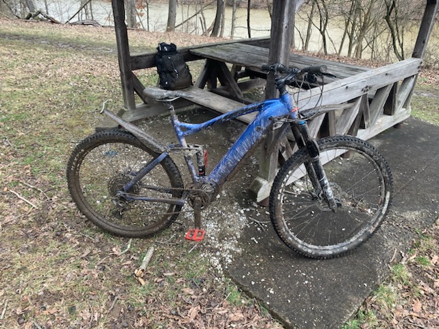

I’ve got a little less that 200 miles on it so far. I live in south west Pennsylvania which has lots of short steep hills and is often wet and muddy and I ride technical single track almost exclusively.
At first I was disappointed with the range, but I think that was due to riding in muddy conditions. As the trails dry out, range has improved quite a bit. I find The m600 to be pretty quiet. I ride without throttle in 1 with 9 power levels enabled. It’s the canbus controller, so it can’t be tuned like the uart version which isn’t ideal. I’d like to tone down the initial surge of power, which can be a bit much.

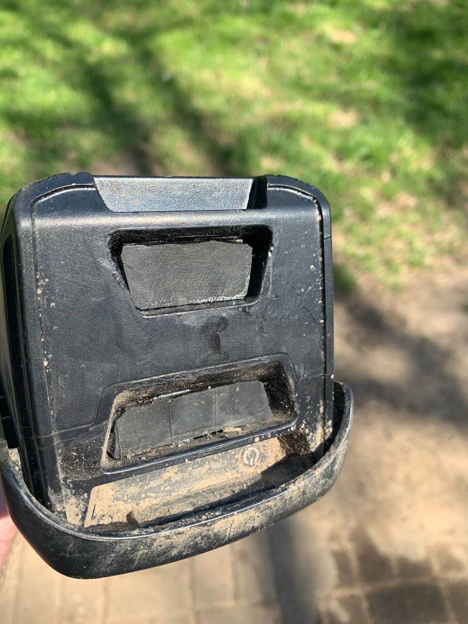

Yes, the four smaller self tapping screws fasten the cover to the battery, but after removing the cover today to check out the latching situation, I’d say there is plenty enough interference to hold the cover on without them.
The locking post engagement to the battery was pretty minimal, so I’m pretty sure the battery can jostle around and that’s what’s causing the un-clicking.
I glued some rubber from an old ultra heavy duty motorcycle tube (about 3mm thick) inside the recesses on the opposite side of the battery and didn’t have any un-clicks on my loop today where I usually get a couple, so hopefully that did the trick.

A couple of updates. Battery unclicked again so I added another layer of rubber in the recesses:
It’s 2mm thick, so 4mm seems to make it pretty snug. The upper recess seems to be the one that matters most. Hopefully it’s a done deal now.

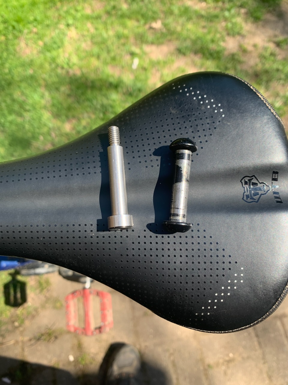

I mentioned I already had some play in the shock linkage. The lower fastener was showing signs of wear and felt like it wasn’t very high quality, so I replaced it with a stainless should bolt from McMaster-Carr:
Still a teeny tiny amount of play, but much better than before, hopefully it holds up.
