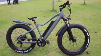

Soft ground, bushy trails? Honestly you sound like you're going to be riding over some tricky sort of ground and even a layback style recumbent like the ones mentioned above would probably be a disaster in such an environment. I'd be looking at some fat tire upright bike, you can have the seat as low as she wants it and start off with high pedal assist and the throttle. Her feet can be easily planted this way and as she gains more confidence you have the option to raise the seat height so pedal power can be used a bit more efficiently. Anyway that's the route I'd take. Actually, It's the route I have taken, but when learning to ride motorcycles on gravel roads. I got a gutless little Yamaha XT 250 farm bike that had a very low seat height, it was like sitting on dining room chair. Once I had some confidence I transitioned to a much higher adventure bike.

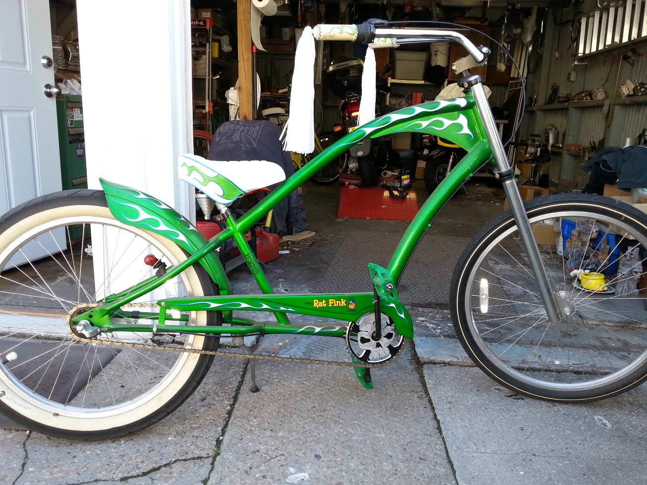

My wife gets crazy workouts if there are rough trails, headwinds or hills. Otherwise it rides nice for local rides. Electra Townie Ed Roth addition.

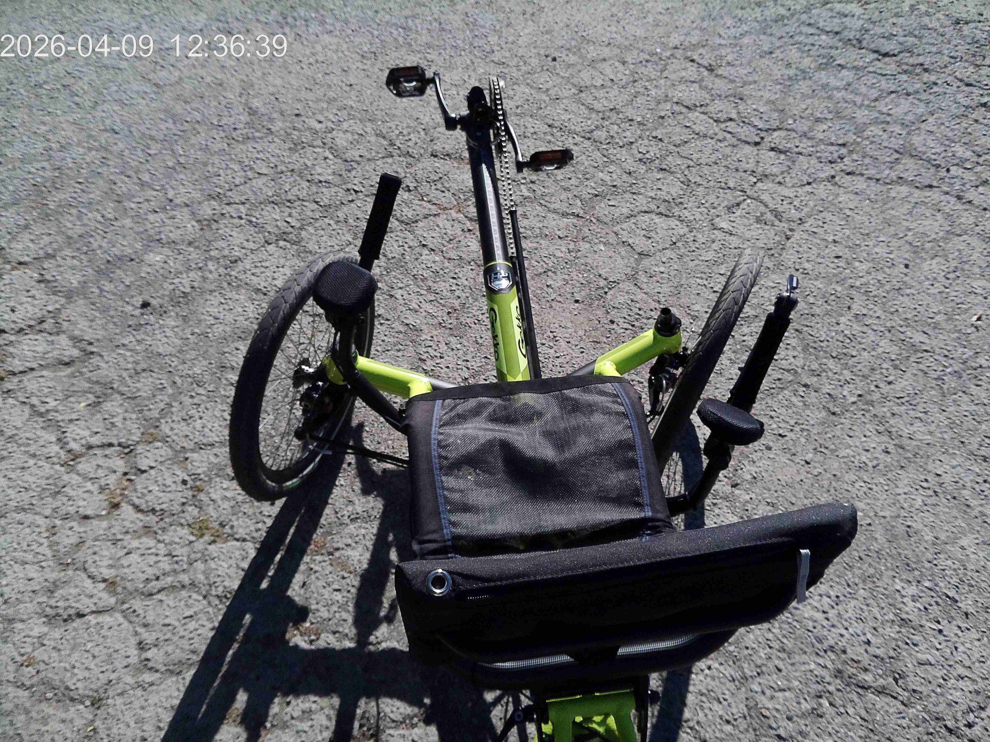

The one I will start working on Monday or Tuesday has front wheels that are only vertical when going straight. They tilt when turning so it cuts into corners like someone on skis. The steer tubes angle out from vertical and the wheels are tied together with a rod and ball joints. I am placing the battery on the center bar at the back of the folding seat. The heavy gage discharge wire will go down to the seat's fold pivot, then to the back of the frame, in a hole and up the boom to the mid-drive. The wire will have an 'S' in it so the bike can be extended or shortened for different ridders. The wheel magnet will be on the rear and will take some modifications and heavier gauge wires. It is called Gekkoluma.
Oh, edit, the steer bars are vertical. So if I mounted the display there it would be sideways by 90 degrees. I will cut the 'S'-curve out of a dropbar and use an HB accessory extender bracket to make the display horizontal.
