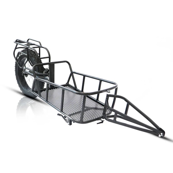

If you were figuring out the tongue weight of a Single wheel cargo bike trailer, like this one,
How could you do it?
The only way I can see, is to make a stake to hold the tongue at the approximate height/location as when attached to the bike, set the stake on a scale's center, then add weights inside the trailer, in these 3 locations of front, middle and rear of the frame basket, to read the indicated tongue weight?
The trailer has a weight limit of 100#'s.
This tongue weight question has been asked, but no information can be found, so far.
Your thoughts or suggestions.............

Fish scale works, if you buy one with a high enough rating. I’m thinking most inexpensive scales are under 20-ish pounds. And how many times are you going to use it? Your idea of a bathroom scale is good, it has the capacity, but i don’t understand why you need to do it 3 times. Load it up like you normally wolud, and weigh it. The wheel in your picture is at the far back … in a full size cargo trailer the wheels are in the center so its possible to put load behind the axle to reduce tongue weight.

Since I know nothing about using this type of trailer, I plan on doing a scale check using the OEM 1 rear wheel, check everything, then add the second rear wheel, test the same way, and see the difference, between the two.
I have a feeling that the direct location of the load, will have an effect on the towing and bike handling results.
As this will be my Big game meat/load hauling trailer, I NEED to know the end results, so I don't get cross threaded on the Mtn with a load of meat on it.
If possible, I would like to be able to haul out around 200#'s in a load, to reduce the number of trips back to camp.

Here is an example with some assumptions, since I don't know the dimensions of the trailer:
W : Total Trailer Weight (lbs): 225 lbs
Laxle : Total distance from hitch ball to center of axle(s) (ft): 5 ft
Lload : Distance from hitch ball to the center of the load (ft): 2.5 ft
T=W(Laxle - Lload)/Laxle: 225 lbs (5 ft - 2.5 ft) / 5 ft
T= 112.5 lbs

It won't matter if there is one wheel or two in the rear as the distance from the axle(s) to the tongue will be the same. The only things that will affect the tongue weight would be shifting the load (center of gravity) forward or backward or moving the wheel(s) forward or backward. You can play with the formula to see how those values affect the tongue weight.
Another wheel won't change the tongue weight, it will only change the weight on each wheel. Anyway, you need to be concerned with the gross weight too. Pulling 300 lb uphill and being pushed downhill is going to have a significant effect on your drivetrain and brakes, regardless of tongue weight.

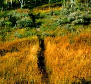

The trouble with a 2 wheeled trailer is the width of the wheels,
which average 24" to 30" wide, on an 18" wide Trail?
One side or the other is going to be hung up or bouncing over
rocks/sage brush all the time.
If I had trails that were 24" to 36" wide, I would go with a smaller
2 wheeled trailer.
Normal cow/hose trails are about 18" wide sometimes
and normally smaller, in width.
I'll see if I can post some photo's.....
After I do my tests, I'll know more information, to work with.
Thanks,
Some interesting reading>>>>>>>https://www.valleyagvoice.com/cattlemans-corner-cow-trails/

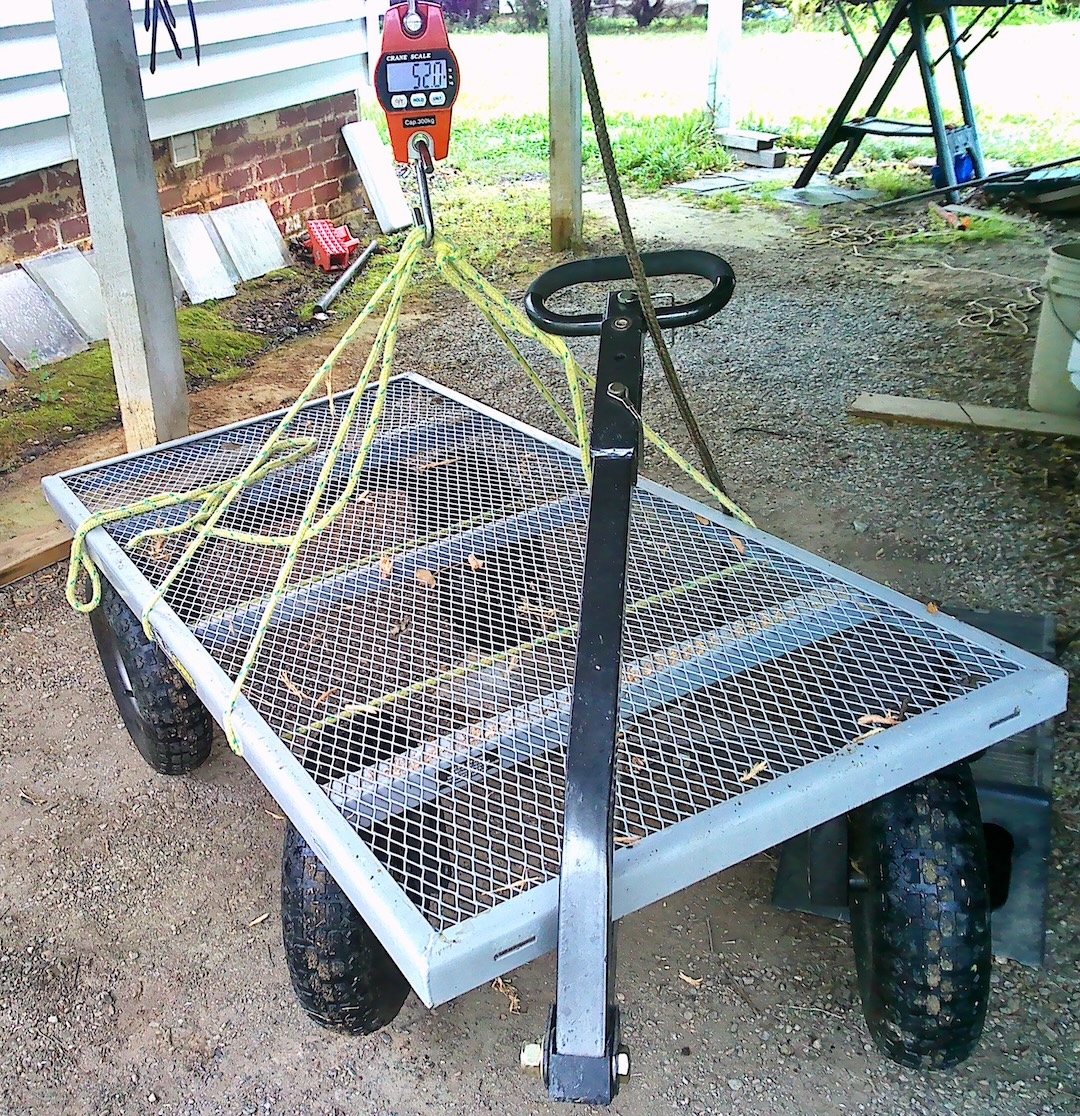

I guess that rules out my cart with a 24" track width! (The scale says 52.0 pounds.) The cart is rated for 1,000 pounds. I see the single-wheel trailer is rated for 70.
