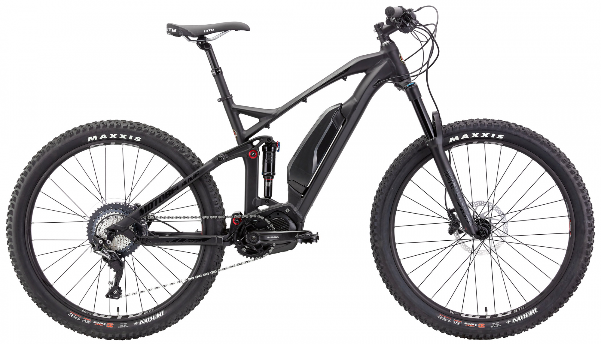

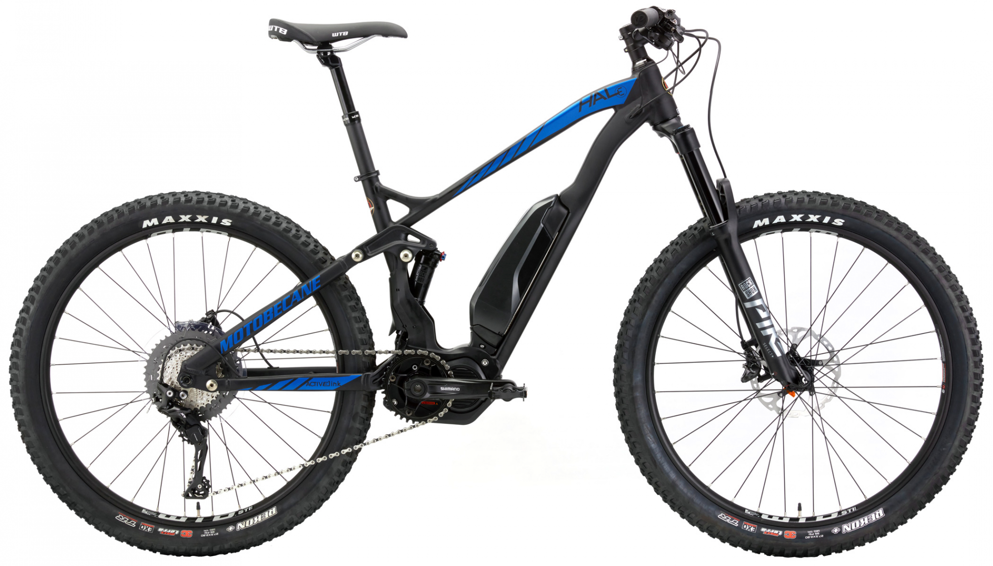

The 2020 Elite (black) and 2020 Pro (black/blue) frames appear to have a different design with the rear shock and pivot as shown in the photos below.
If you look under the ELECTRIC tab on the website, you'll see that the 2020 ELITE and PRO frames are the same. My ELITE has the same rear shock lower attach point as the PRO. You can see in the photos I posted. Can't go wrong with either.
