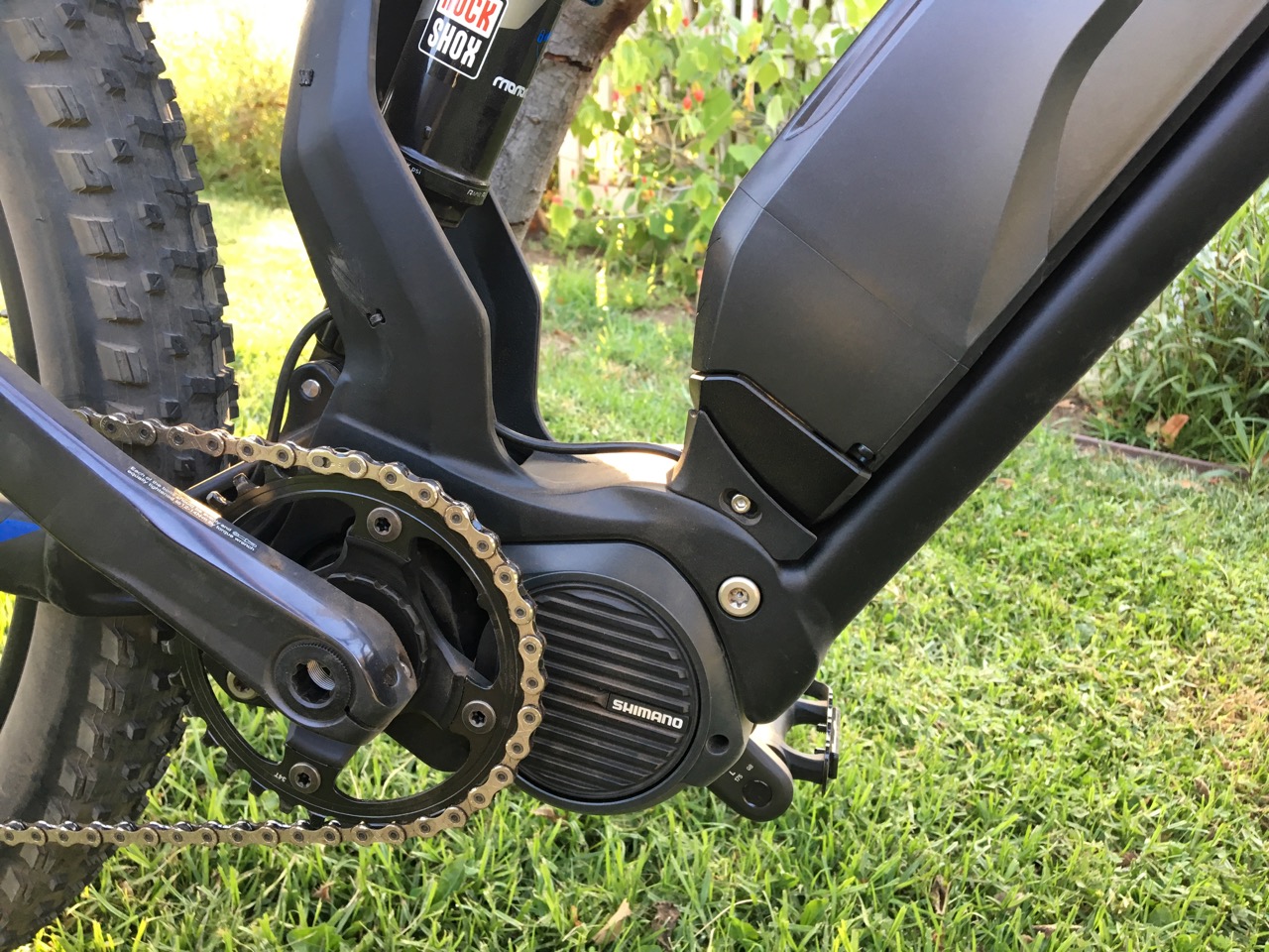

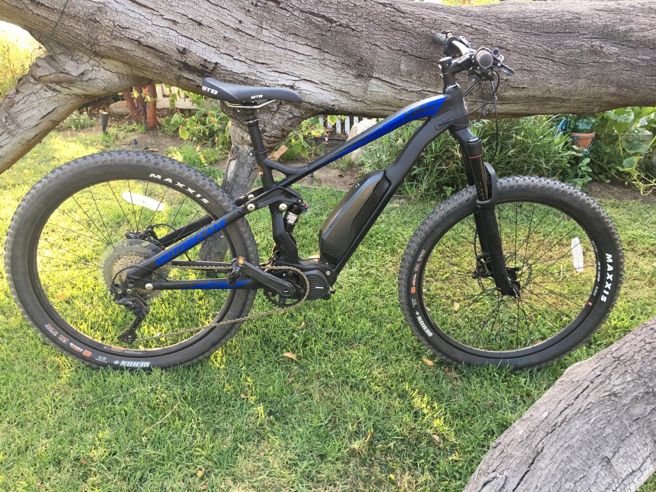

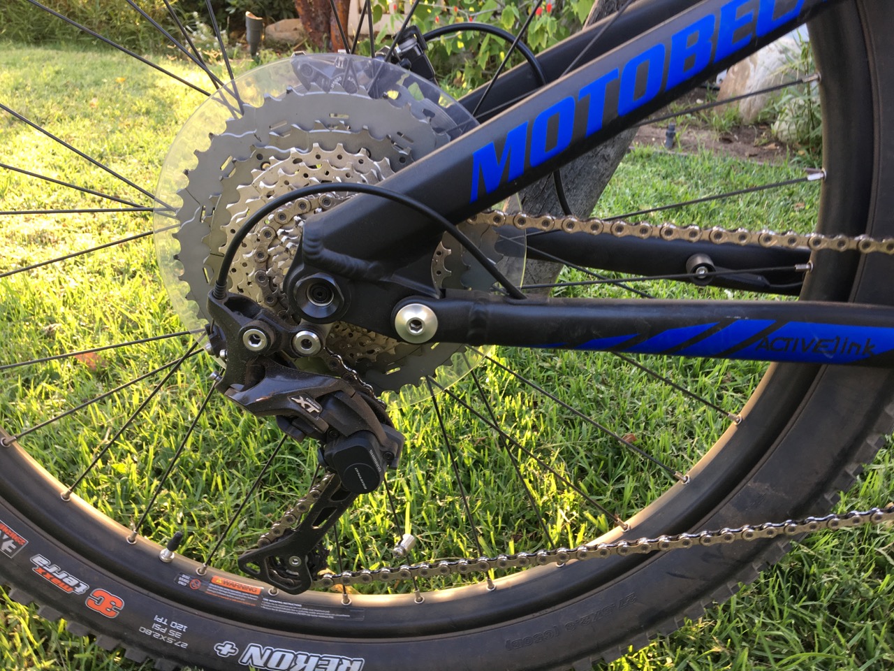

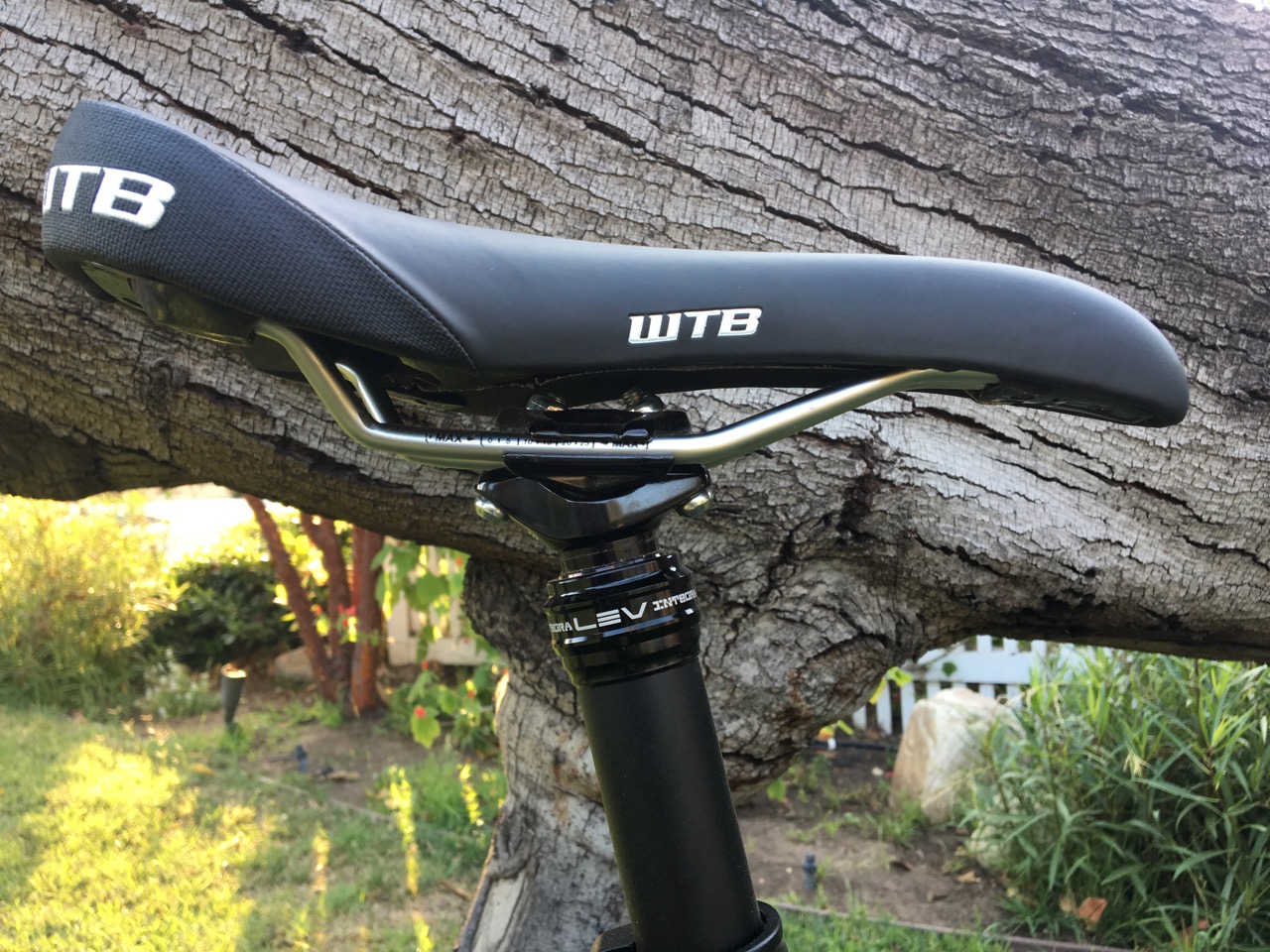

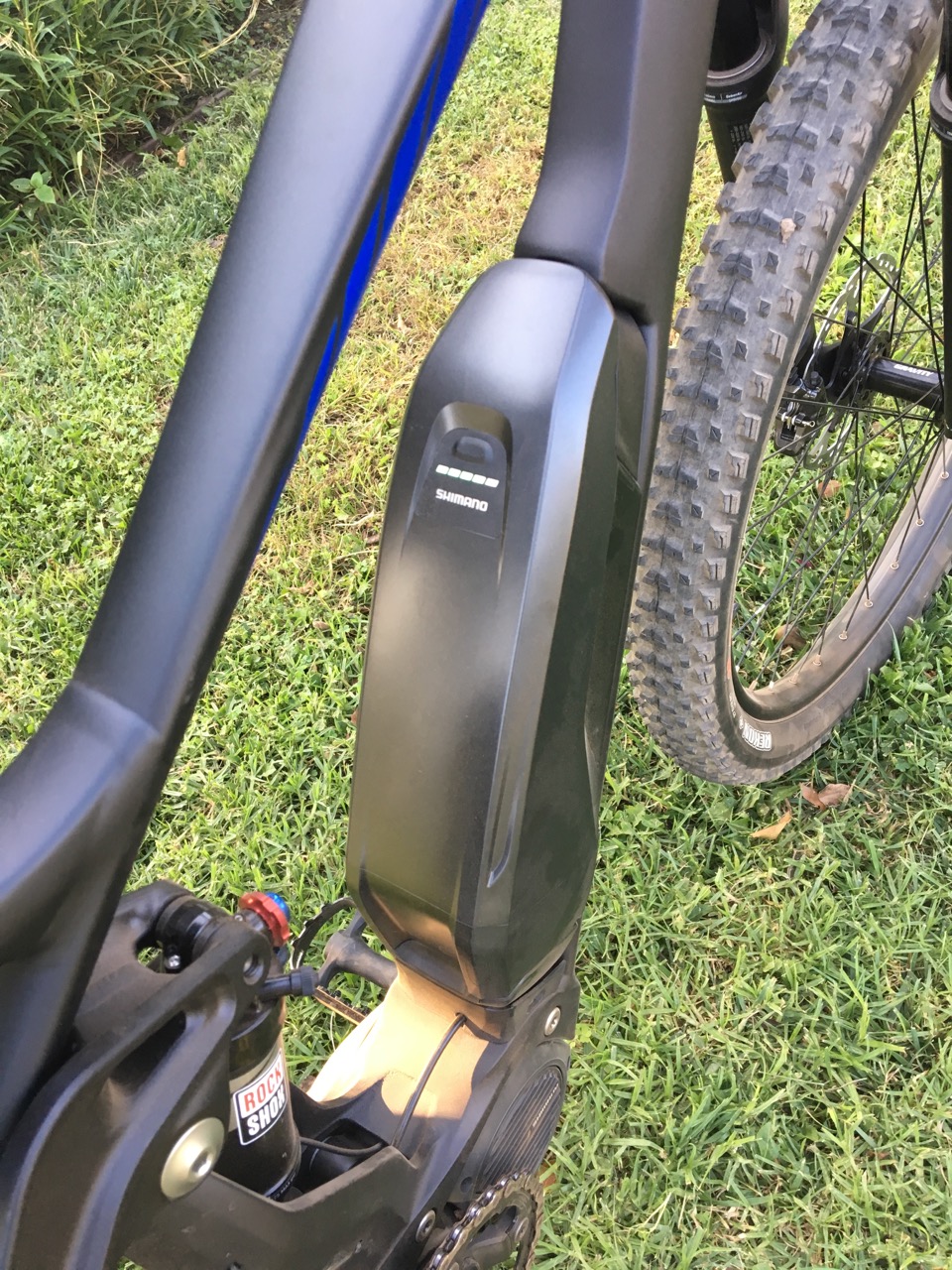

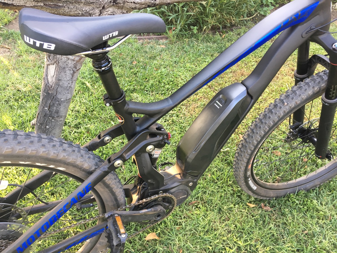

The infamous Motobecane HAL E-MTB. I bought one…
Hey LimboJim, Thanks for the info. I too ride pretty intense trails on my emtbs and have been thinking of trying out the Sram EX1 8 speed drive train when my 10 speed Deore XTs needs replacement. Interesting that the EX1 chains are so much cheaper, but how about the cost of the new EX1 drivet train? When I priced it all out (shifter, cassette, rear mech) it was nearly $500. Any leads on a better price?
The XG-899 cassette is expensive, no doubt, but I've never seen another 8-speed cassette with anywhere near the 11-48t range it offers. $500 is about as good as it gets for the trigger shifter, derailleur and cassette, as far as I can tell. I'd also consider the X-Sync EX1 sprocket for Bosch or X-Sync Chainring for other motors.
Even with the elevation changes, the wear is excessive. What chain are you using? Do you use the factory grease the chain is packed in, or do you clean off the factory grease and use a different lube? How often are you lubricating the chain? Are your rides mostly dry and dusty, or wet and muddy?
Conditions vary here in New England. I clean & relube just about every ride (MucOff wet or dry, depending). Makes no difference with 11-speed chains in my experience (KMC X11e, Shimano CN-HG601 & 701, Wippermann Connex 11SE). Same is true for my Bulls w/Brose & 11-speed setup - about 200 miles per chain. My 8 & 10 speed rigs have done 400+ on the same hilly trails.
Mind you, I'm using the "0.5% for 11-speed, 0.75% for 10-speed or less" rule.
Bottom line - the thinner chains used on 11-speed drivetrains don't last as long on eMTBs, but as a Stromer rider, you don't have to worry about that.
I only ask because I'm considering a mid drive bike. Well that and I was curious about the motobecane build quality. I've owned a 7~8 bikes from BD and there have been a couple lemons. I'm a bit reluctant to order another motobecane if I can help it as I've found a higher quality supplier for most of my natural aspirated bikes. $3500 may be a good price, but it's still a lot of dough for an e-bike I wouldn't ride a lot as we can't use those bikes on the trails here in Michigan on state and metropark land. I was considering it to tote my trail grooming tools around, and if I caught hell, well so be it, because I'm trimming trees, shrubs, putting dirt in holes, etc and toting those loads around by leg can be annoying.
I read about them all, the prestigious brands. Rode a bunch too. Was really close to buying a Bulls E-STREAM EVO AM 4 27.5+ (love the Brose motor). But could never quite get the value of the Motobecane HAL 5, from "that" internet company, out of my mind. Spent a year going through this evaluation.
Finally did a mental exercise. I imagined a person placing the Bulls & Motobecane in front of me and saying, "You can have either one of these bikes." "Bulls, baby!" I'm thinking. And then this imaginary person adds, "But if you take the Motobecane I'll also give you $2400." $2.4 can buy a lot of accessories, tools, and other gear that a newbie (or re-entry guy like me) is going to need. Decision made. I took the risk and pulled the trigger on the no-name, internet bike.

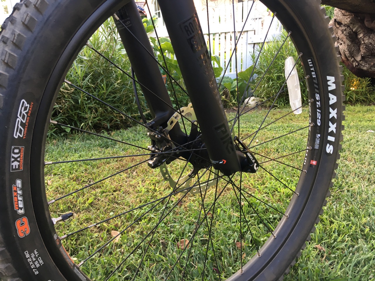

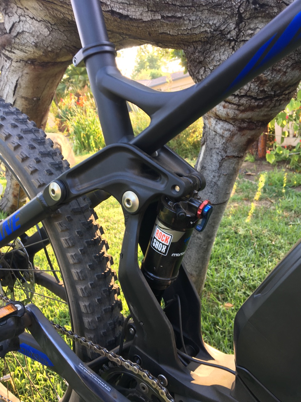

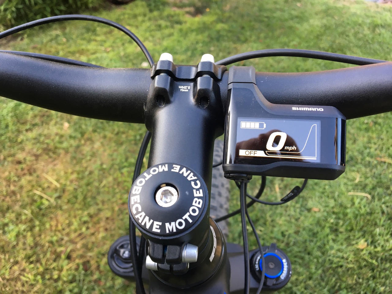

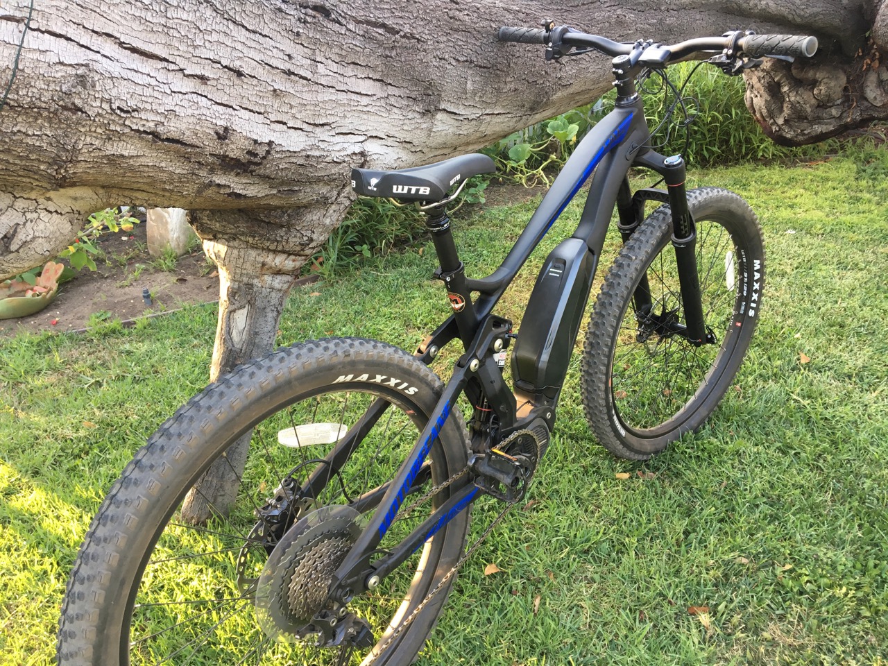

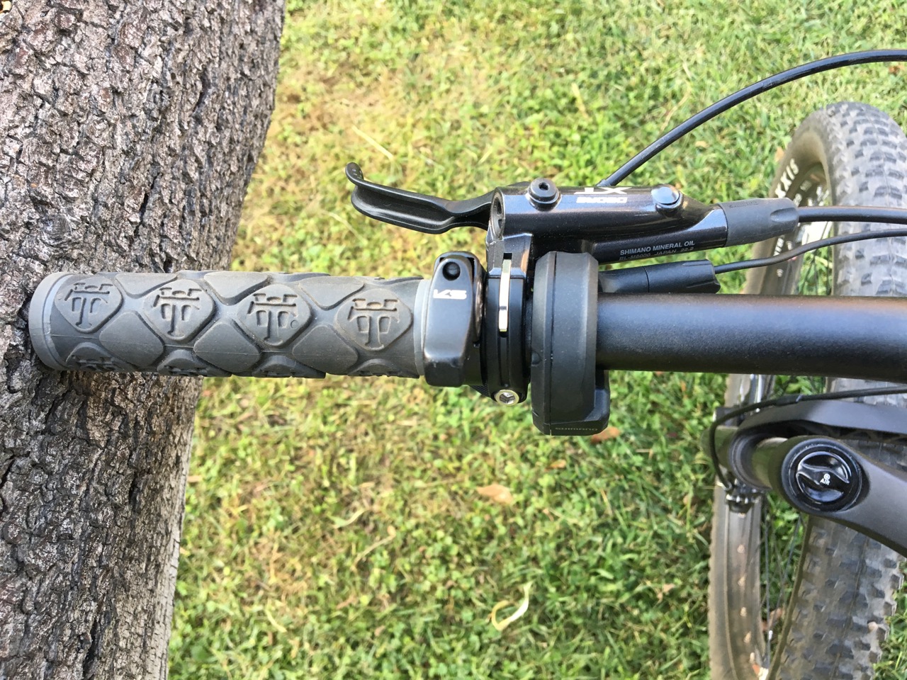

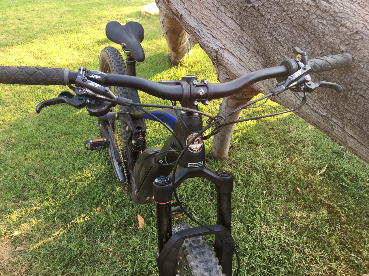

Don't get me wrong. I didn't buy the MB just because it cost less. The components are very good, and usually found only on very high quality e-bikes. I like the Shimano E8000 motor for it's size and weight, and it has plenty of power. Plus, for me, the power and gear shifters are tough to beat for the symmetry of function, and the compact display is well positioned, bold and concise and easy to read at a glance--these are primary touch points that make or break the pleasure of the ride, whether you're riding hard or easy. (Would love to see the Brose S with the Shimano shifter and display, but...)

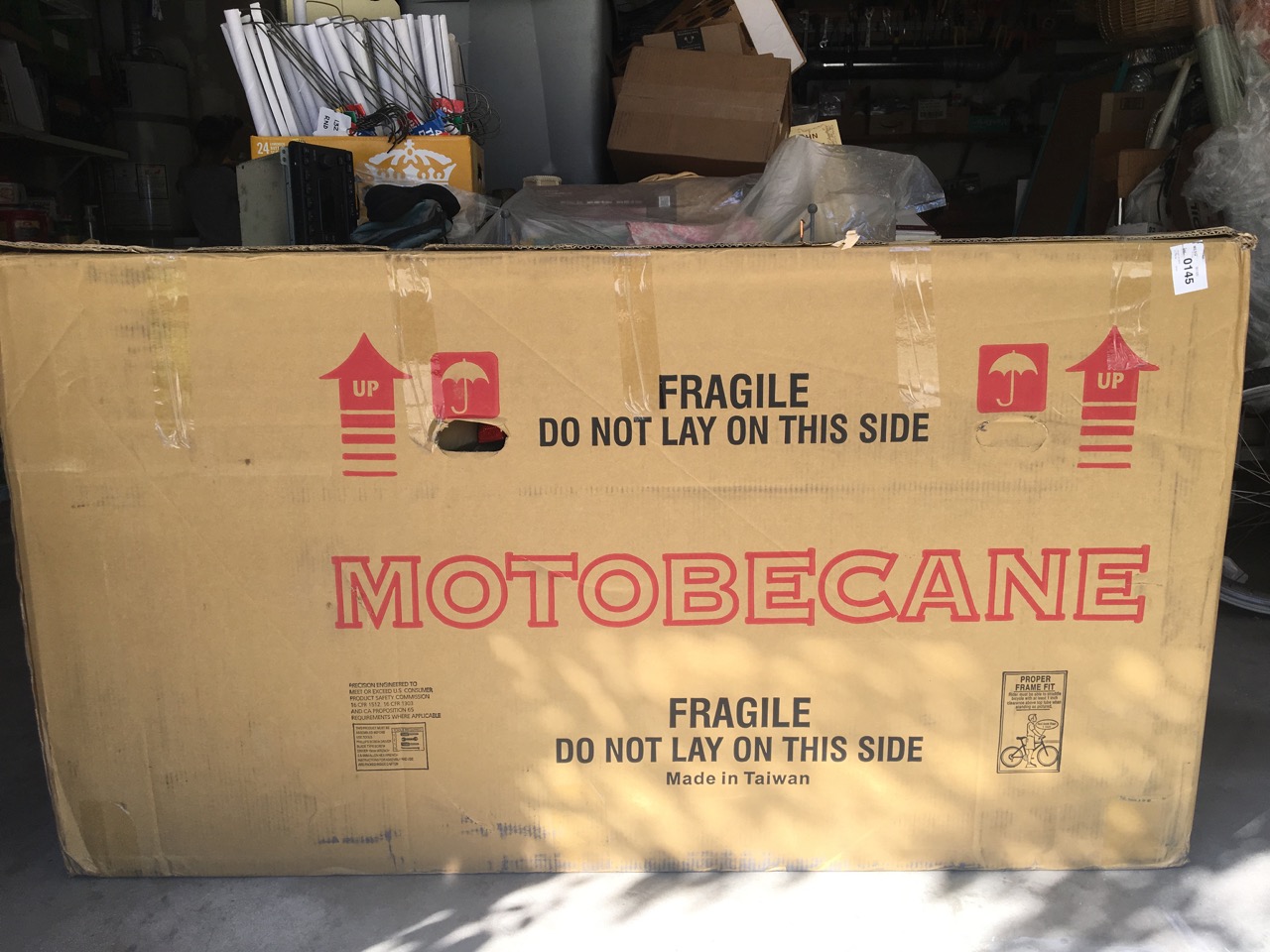

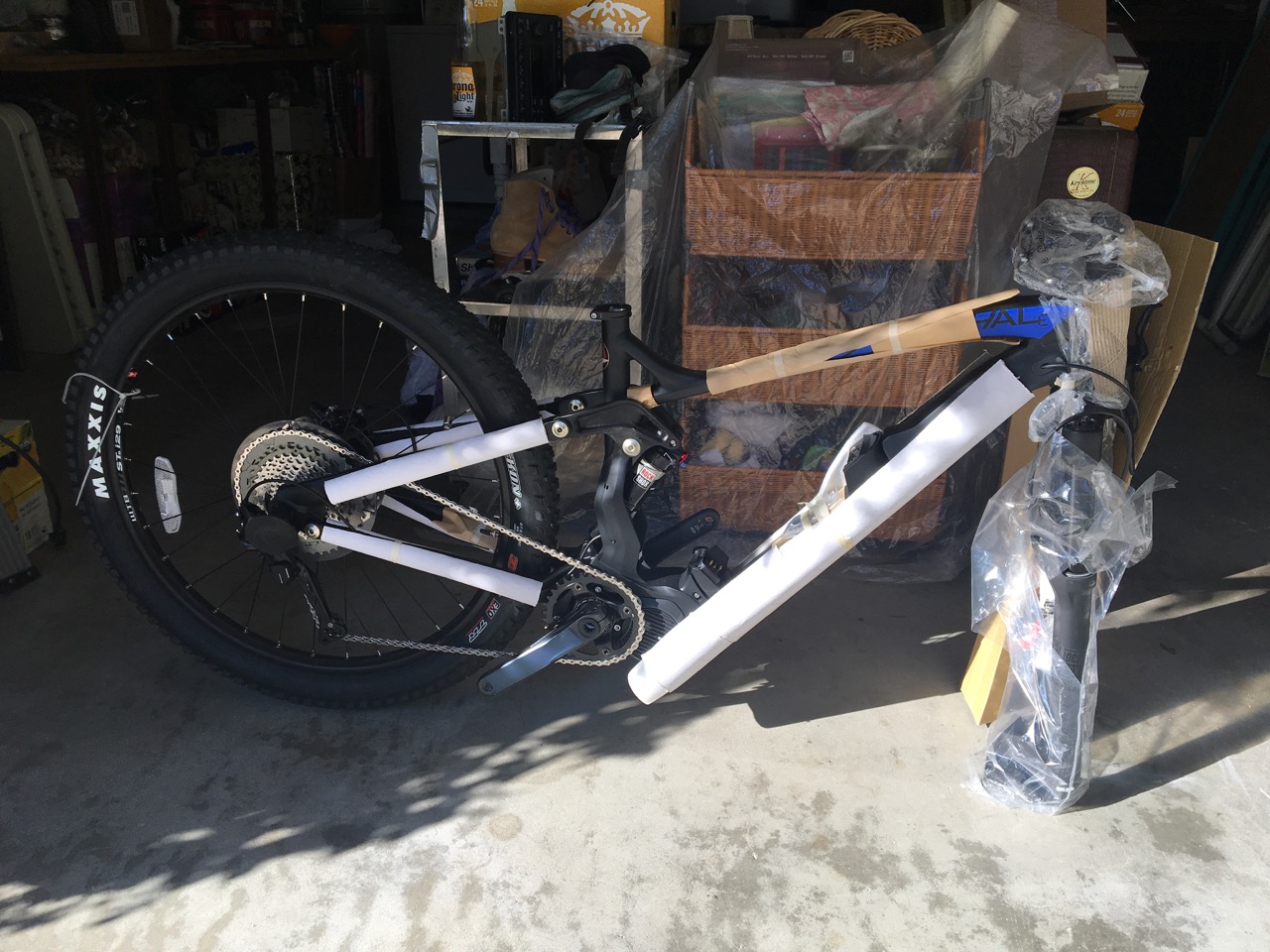

Thought it would take a couple of weeks to be delivered. It arrived in 5 days. No damage, no problems. The only real assembly was to bolt the front disc to hub, bolt the front brake to Pike fork, place the front wheel into the fork, and adjust the handlebar. And the pedals; had to screw those into the cranks.
Frankly, I am impressed with product and very happy with the purchase. I really thought I'd see some evidence of "cheapness", but fit and finish is good. They obviously didn't put any money into cool paint and graphics, but the worst you can say is that it has the Motobecane name on it in a few places. The hardest part was adding the LEV Integra dropper. Yes there is a spare entry into the frame for the internal cable routing (as their page states), getting a cable to pass through the intended route, however, it is very difficult. In the end, I got it done. But I will say that there is value in buying a bike with the dropper installed; it's pain in the ass to DIY, at least for the first time out. I weighed the bike today. 48lbs 8oz; a good 4-6 lbs lighter than I expected based on the weights of higher priced competition.
Bottom line: The MB is a great value for a full suspension, full Shimano XT level, Rockshox-equipped e-mtb, especially for a rider new to e-mtb. It arrived in fine shape and base assembly was simple. If you've been riding and already have all the gear and tools needed to ride and maintain all the components on these type of bikes, then spend the extra for a premium name brand. For me the "internet bike" saved me enough to outfit the rest of my kit.
