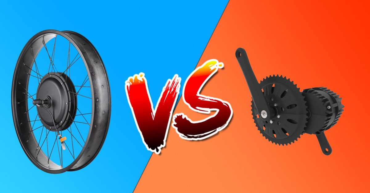

FlastSix or anyone else. When looking at Crazy Lenny's the haibikes seem to mostly have 250w motors. I just bought my wife a Ride1Up with a 750w motor. I'm not a true mountain biker but am wondering why these bikes have smaller motors and if I could get one with a smaller motor and be happy with it? I would like a MTB with that can do hard road and mountain trails also. Can you give me some education?
Mid-drive motors are typically underrated by the manufacturers and usually output anywhere from 500 to 800 watts peak.
The key factor is that a mid-drive is directly connected to the drivetrain (crank, chain and rear cogs) to multiply the combined output using the mechanical advantage of the gear ratios.
A more detailed explanation from Electrek is provided below:
The single largest advantage that mid-motors have over hub motors is their gear ratio. They allow the rider to power the rear wheel via the same chain and gear set as the pedals, which means that a low gear can be selected for powering up steep hills or accelerating from a stop with massive torque. A mid-drive motor in low gear can climb steeper hills than a hub motor of similar power, and can climb hills for longer than a hub motor, which could overheat on long steep hill climbs.
A mid-drive motor is also usually smaller and lighter than a hub motor of similar power. Bafang recently debuted a new line of mid-drive motors for racing bikes that weigh only 5 lbs (2.3 kg). Smaller and lighter mid-drive motors are often stealthier because they can be incorporated directly into the bicycle’s frame. Many people don’t even realize that a mid-motor bike is an electric bike just by looking at it. hanging a tire on a mid-drive motor e-bike is much easier, since you don’t have a heavy hub motor to deal with. You just change it out like on a normal pedal bike. Plus, since you can use normal bicycle wheels, you have the freedom to use any wheels, tires and cassettes that you wish.
Lastly, mid-drive motors allow the use of true torque sensors for pedal assist systems, which regulate the motor power based on how hard you push on the pedals as measured at the crank. Hub motors often rely on cadence sensors for pedal assist, which only regulate motor speed based on pedal speed, and can cause jerky or awkward motor timing, especially when hill climbing or moving the bicycle around obstacles.
