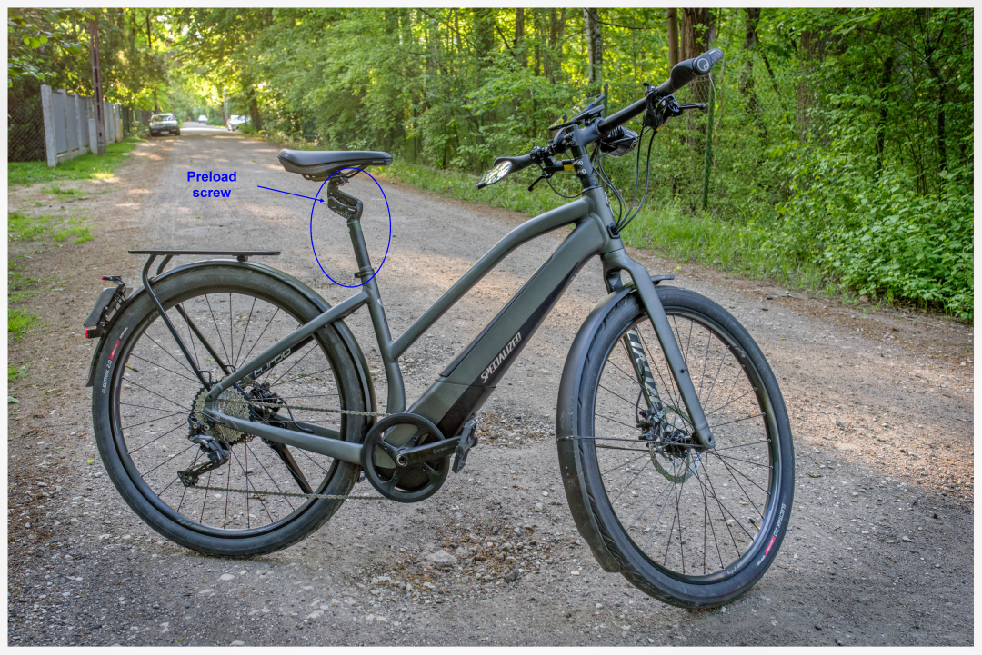

Today, I decided to replace the PNW Coast suspension dropper seat-post in my Vado with the Kinekt 2.1. The outcome turned out to be extremely positive. The problem with the PNW Coast is you need to sit centrally over the axis of the seat-post to make it work properly. All of us might want to choose another riding position; I like to have the saddle slid backwards, and that made the PNW product deliver no suspension action. With the Kinekt 2.1, your riding/saddle position is irrelevant. The seat-post would absorb wobble and vibration almost as good as the full suspension. In case you also own a good shock fork, the only body part that is not shock-protected are your legs. I own another FS e-bike and can tell the similarity. Your behind is protected extremely well with the Kinekt 2.1!
There is also the matter of the pre-load setup, which is very easy. Without proper pre-load on the Kinekt springs, your saddle would bob during pedalling, which takes part of your effort away. To set the pre-load up, just sit on the saddle with your feet on the pedals (make it the way the bike cannot fall sideways; lean the handlebar against a tree or let somebody hold your bike). The other person should just tighten the screw behind the seat-post springs, so the screw head just blocks the backwards movement of the springs when you're getting off the bike. You can adjust the pre-load by trial-and-error method too.
I'm enchanted with the quality of the Kinekt 2.1 and the comfort it gives me!
