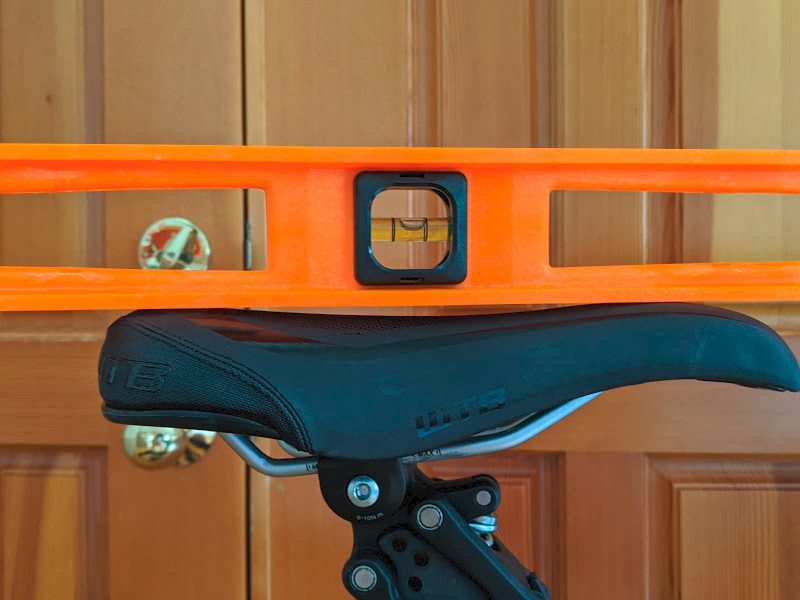

I tried to go with neutral tilt. I'm not sure if I'm doing it right as the back and front of the saddle naturally curves with a dip in the middle. See attached image: ATTACH=full]50210[/ATTACH]
I did try moving it a notch higher (felt like I was sitting in a recliner and the boys felt the tip was too close for comfort) as well as moving it down a notch (didn't feel right either, so I think the angle is right).
Ever since I got this Satori suspension seatpost I've had a bit of discomfort after the ride. initially I feel like it's great, the bumps don't jar my derrier, but by the end of my ride the seat just feels uncomfortable and sensitive after the ride. I did raise my handlebars around the same time so perhaps it's more that combination making the saddle uncomfortable as opposed to the suspension seatpost. I'm thinking with suspension I'm more inclined to let my derrier absorb the bumps and it's taking a toll. Need to expirement more and perhaps this saddle is just not right for me.
The saddle tilt should be neutral and level... yours looks about right. ;)
Also, try adjusting the fore and aft position of the saddle to dial in the fit.

Tomdav, can you describe what kind of pain you have ?
Tilt is a sensitive issue and it depends on your riding style. When you go upright you should also tilt the front tip up and vice versa.
Also when you go upright you sit on a wider spot of your seatbones wider saddles are recommended for more upright riding positions.
Imo start with adjusting your saddle height first. That is almost independent of any other adjustment and probably the most important one. If the saddle is too low you will have knee pain, too high saddle will cause seatbone pain because you are rocking side to side each pedal ravolution. Here is a good tutorial on youtube
In terms of tilt, level is a good starting position (your adjustment in the photo seems nice) however it need not be optimal. if your seatbones ache then you should tilt the tip up a little bit (do this with very small increments), if you are having perineal pain tilting it a bit down may help.
Also a saddle which is very comfortable for one style of riding may be uncomfortable for another position and rising the handlebars will change your seating position quite a bit.

Thanks, I'd say it's more perineal pain so I'll try tilting down a tad.

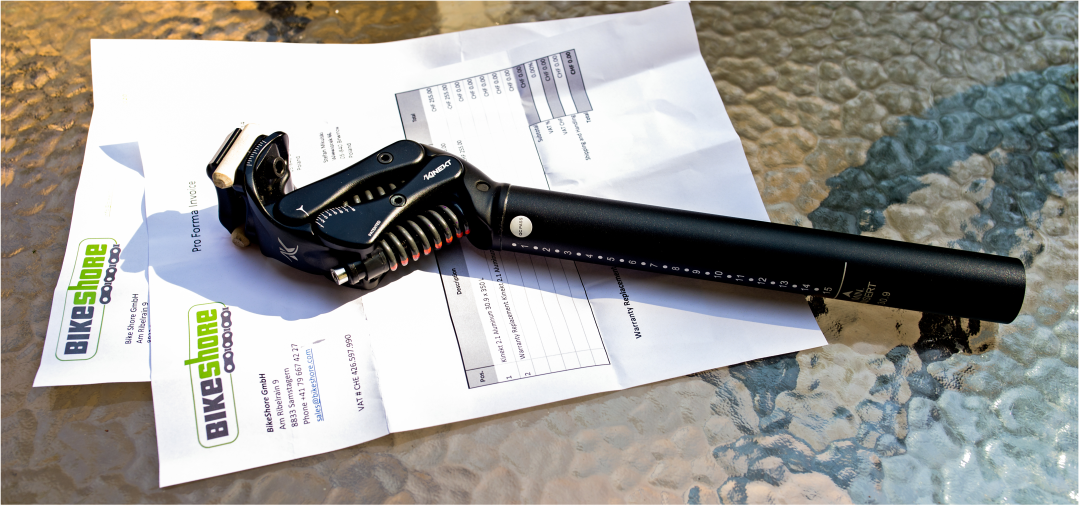

Ordered on March 27th, 2020 at the Cirrus Cycles. The USPS shipment got stuck in San Francisco and never reached me (Cirrus Cycles will have to retrieve it from the USPS, not my headache). Cirrus Cycles asked their Swiss dealer, Bike Shore to send me the replacement Kinekt 2.1 seat-post. The Swiss were as "smart" as to send it with the Swiss Post*.
The seat-post reached me on May 8th, 2020. Waiting for the LBS to release my Lovelec from servicing. An Ergon saddle is waiting, too.
