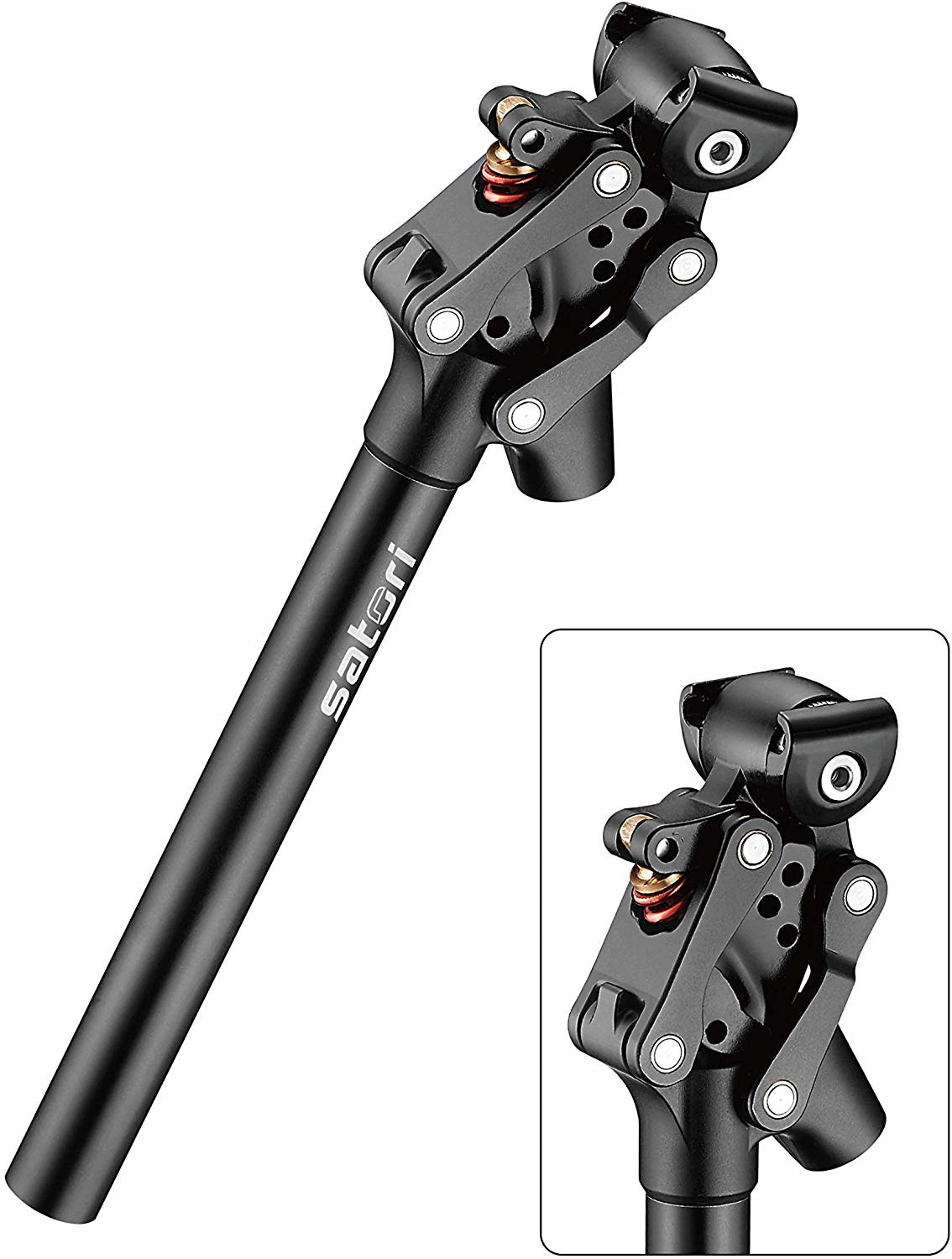

I highly recommend the Satori Animaris suspension Seatpost... very high quality, fully adjustable and a great value at $59. ;)
I decided to give this a try and quite honestly I'm underwhelmed. Maybe I just need to give it more time but out of the box it had zero give. I unscrewed the compression bolt as far out as I could, within a turn of the bolt falling out to provide reasonable give (I'm 180-190 pounds). Satori claims vertical travel is 43mm (1.7 inches). I removed the spring and with every ounce of strength pushing down I was able to get it to compress 1 inch. No way it's giving 1.7" of travel with the spring in. I'm a bit concerned about having to unscrew the compression bolt out so far. I'd think it would need to be screwed in at least 2-3 turns to provide enough threads to support the bolt. Maybe I got a defective one or too stiff a spring?
Original BH Rebel Lite 31.6x350mm post (368g)
Satori Animaris 31.6x350mm suspension post (678g)
Same effective height and minimum insert
1 turn from fully unscrewed
Compression spring removed
Maximum manual compression with spring removed (approx 1" vertical)
I decided to give this a try and quite honestly I'm underwhelmed. Maybe I just need to give it more time but out of the box it had zero give. I unscrewed the compression bolt all the way out, as far as I could, within a half turn of the bolt falling out and then it had give. Satori claims vertical Travel: 43mm (1.7 inches). I actually removed the spring and with every ounce of strength pushing down I was able to get it to compress 1 inch (the rubber at the top provides resistance with the spring out). No way it's giving 1.7" of travel with the spring in. I suppose if I was 300 pounds it might compress 1" but I'm only 180-190. Maybe I got a defective one?
Yes if you try to push it down with your hands, it feels like it has zero give. That was exactly how I felt in the beginning but that is not the right way of testing it. The maximum force you can apply with your hands ,without jumping, is equal your body weight but you can only expect it to sag a little bit in that case. Soon you will realize that it is a good thing. Unscrewing the compression screw will help.
The rubber is an elastomer, it is a part of the suspension and works in tandem with the spring. Even with only the rubber there is some suspension going on. Also for full travel you need a shock(like hitting a bump fast) + your body weight on the seat post.
My advice is to loosen the adjustment screw so that it slightly sticks out(like 1-2 mm) go ride it over the bumps, holes, rocks big cracks on the trail that normally bother you. You should immediately feel the big difference.
FWIW with my weight around 200 it works very well for me. (I wish they supplied different strength springs though)
Thanks. I actually rode it unscrewed a couple turns out from flush as you say, but as I rode it felt like it wasn't giving adequate suspension so I unscrewed a couple more turns, so roughly 4 turns out. 7 turns from flush is fully unscrewed so I had about 3 turns holding it in. My butt still hurts just thinking about it, but maybe it was the saddle I put on. I was testing another saddle which was a little harder, but figured suspension might compensate, au contraire.
FWIW, I've read the plastic stabilizer makes the seatpost squeak after a while so maybe I'll just remove if I need more play. Don't see that it really does anything.
