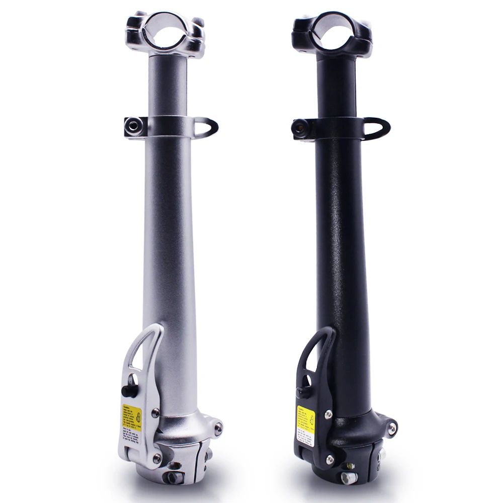

Folding bike stem to hold handle bars - https://www.amazon.com/gp/product/B07CJV492P/ref=ppx_yo_dt_b_asin_title_o08_s01?ie=UTF8&th=1
This will work but I wish I found a shorter one so that I could get more handle bar heights. Also, The clamp that fits over the fork pipe is really beefy and thus will not close enough. I had to cut a aluminum can to make a thin aluminum shim to fit between the fork headset pipe and base of folding bike stem in order to get a tight fit. It works fine now.
9/27/20 Note: I did notice that the hinge in on the wrong side so that you won't be able to fold it down completely because it will interfere with the folding operation of the main part of the bike frame. I will eventual replace it with a different folding handlebar bike stem, something like this...
