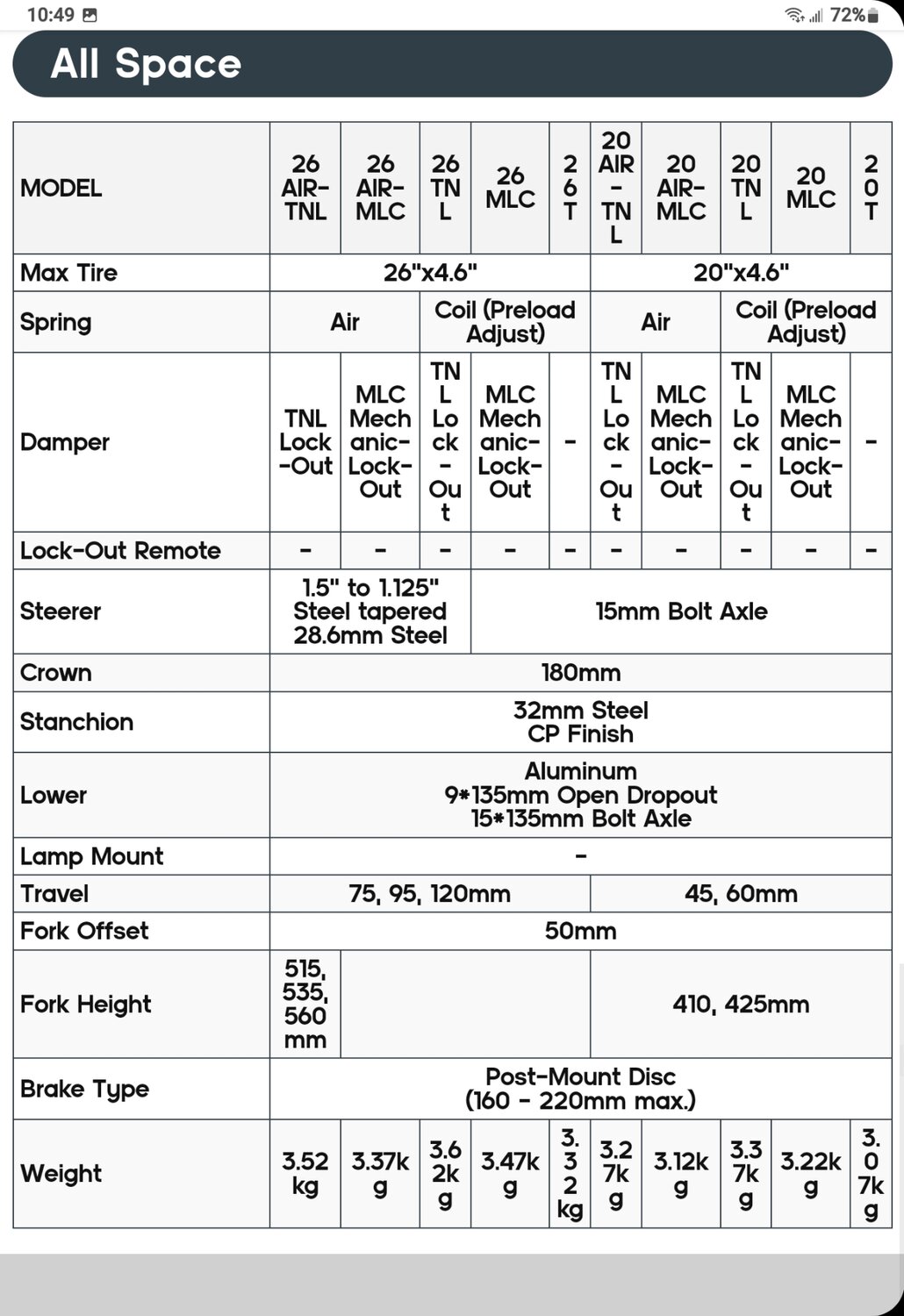

I'm thinking of buying an air fork but I'm having trouble finding something that will fit.
I have a 26"X4" fat forks with a 135 mm drop-out.
They are the TNL 26" version with the coil spring and the hydraulic lockout, 75mm of travel, and 1.5" to 1.125" tapered steel steerer tube.
I want to get a double shoulder downhill fork with as much travel as possible but my tapered steerer tube and 135mm dropout is limiting my options.

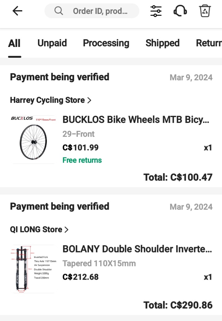

I like these and they are nice and cheap (I don't want to put a $10 saddle on a $2 🐴)
$118 plus $59 shipping.
But they don't come with a tapered steerer tube, so I'm thinking of getting a 30mm to 38mm steerer tube/bearing shim.
The top of the steerer tube is 28.6mm and the bottom is 30mm.
Does anyone know if such a shim exists?
