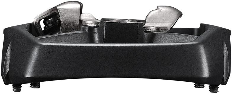

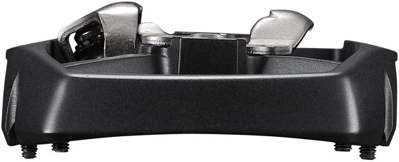

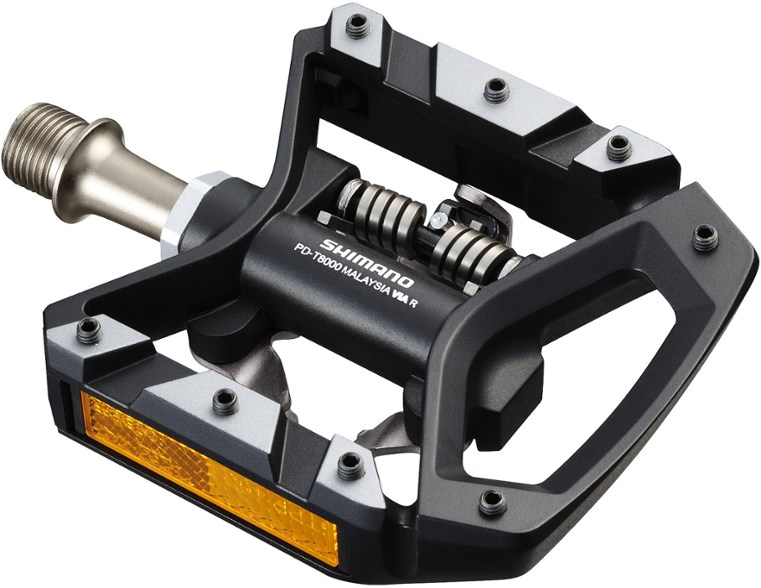

I was having the same issue. Shimano XT PD-T8000 pedals have cleats on and normal pedals on the other. When riding cleat side down, you have much lower chance of a pedal strike. I really like these pedals.
Shimano XT PD-T8000​
I put these on yesterday and they eliminated the problem unless I'm really leaned over. Well worth it to me. The difference is that the pedal is concave on the non-cleat side so the edges are lifted up. Perfect! I'm going to take off the cleats and put some lead wheel weights down there so the non-cleat side always rotates up. Thanks for posting these.
