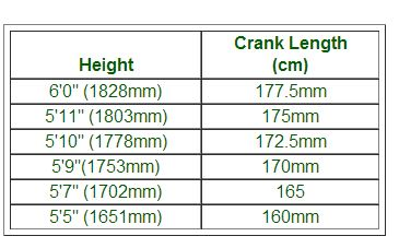

Most riders run regular length cranks (170-175mm) but on an eMTB you tend to tackle harder climbs and the electric mountain bike allows you to navigate up rocks/obstacles etc.
With full-length cranks, pedal strikes become more apparent. This means many riders have been fitting short Bosch eBike crank arms (165-150mm) which allows more ground clearance for more adventurous riding.
The trouble with just swapping the cranks is that it alters the feedback the drive system gets. Which in turn alters the output of the motor assistance feel, torque curve and in particular the characteristics when in eMTB mode.
For 2019 Bosch introduces software updates via a Bosch eBike dealer, who can program each bike to suit the preferred crank length. This adapts the progression curve in eMTB mode and also offers increased support in Tour mode, offering maximum power up-hill.
