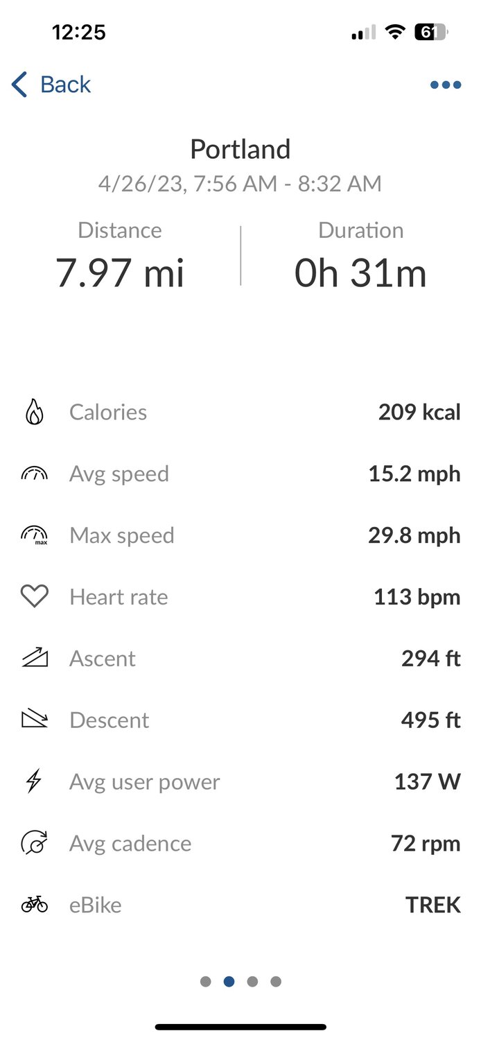

16 calries per mile is maybe average 120 watts or less on the ride. I just did 140 watts average on my 8.5 mile ride and burned 225 calories thats about 28 calories and a average heart rate of only 107.. but thats on my commute with a lot of stops and starts. my heart rate drops a lot on all those stops.
That's almost double my cal/mile. I don't have a heart monitor but it doesn't seem like it goes up noticeably when I'm riding with this 16 cal/mile effort.
What was your average speed on that ride?
I have a HRM and a watt meter so I know how much I am putting out. usually my Nyon display agrees with the garmin on calories burned. without a watt meter its pretty much anything. if I use my apple watch it will give me almost double the calories burned. I dont think anyone really knows how many calories you actually burn. my watt meter and heart rate are the only important factors. I dont get as high of a watt average on my trek as it I do my on my bulls it would be around 150 watts 250 calories and maybe 130hr.
