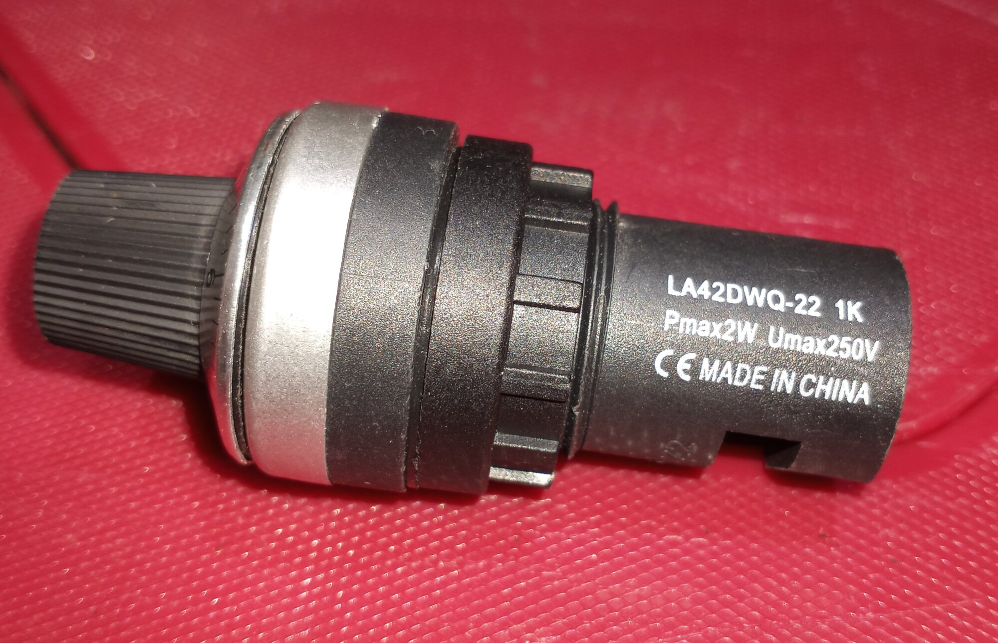

I'm going to make my own,..
I was going to get one, but it comes to $65 CAD with tax and shipping.
I've been using the above scheme of mine for 2 years now and I find I rarely use PAS anymore. No matter how you set the individual PAS levels (if you even can), situations always arise where they aren't adequate. This is especially true when riding with others and try to sync speeds. You can dial in any speed you want with this rig and the parts cost less than $20.
I didn't even hook up my PAS sensor to my new controller.
That's how convinced I am that PAS sucks and I'm never going to use it.😂

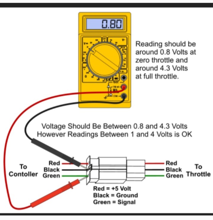

I just realized that that is your schematic...

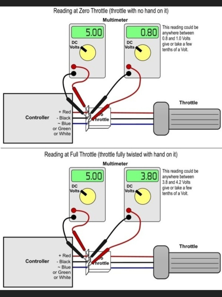

I've found out that you don't need to separately power the potentiometer with batteries.
The +5V supplied by the controller can run it.
I've got both my quick thumb throttle and my twist throttle hooked up in parallel.
Which ever throttle is set the highest, overrides the other.

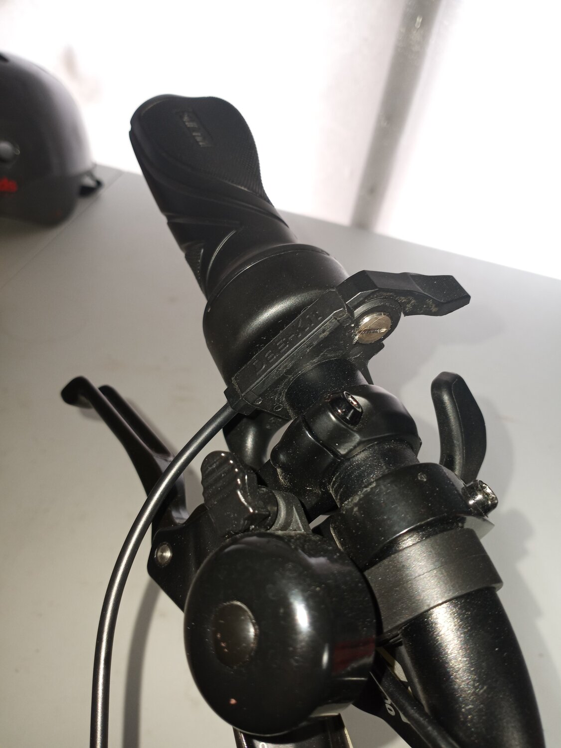

As a follow up to this post and the results obtained,
I got the left hand Bafang half twist throttle, since I use/run inside the handle bar mirrors, on both sides, I had to use the proper sized drill bit on open the left hand side grip end to fit the mirror attachment.
Installed the 1/2 throttle twist and pushed the long end part tight up against the throttle band and tighten down the mirror on the inside of the handle bar.
I took the bike for a ride and FOUND out that I had TOO MUCH pressure on the twist part of the throttle, it would NOT return to the zero speed setting.
This worked perfectly, as the friction between these parts held the speed set by the twist part, rough wash boarded roads conditions did not move the throttle settings, in the slightest way.
I can set what ever speed I want or need with any Eco/Sport settings when and where ever I ride now, and if I need to slow down/stop, I just lightly grab the brake levers, and when the brake is released the speed goes back to the setting.
And as a added benefit, the mileage improved by reducing the power spikes etc.
I am tickled Pink by this conversion, Thanks 6Z.

And the nice thing is that the twist top section can be moved down the handle bar
towards the long end if the tension goes slack, or you need more or lighter tensions.

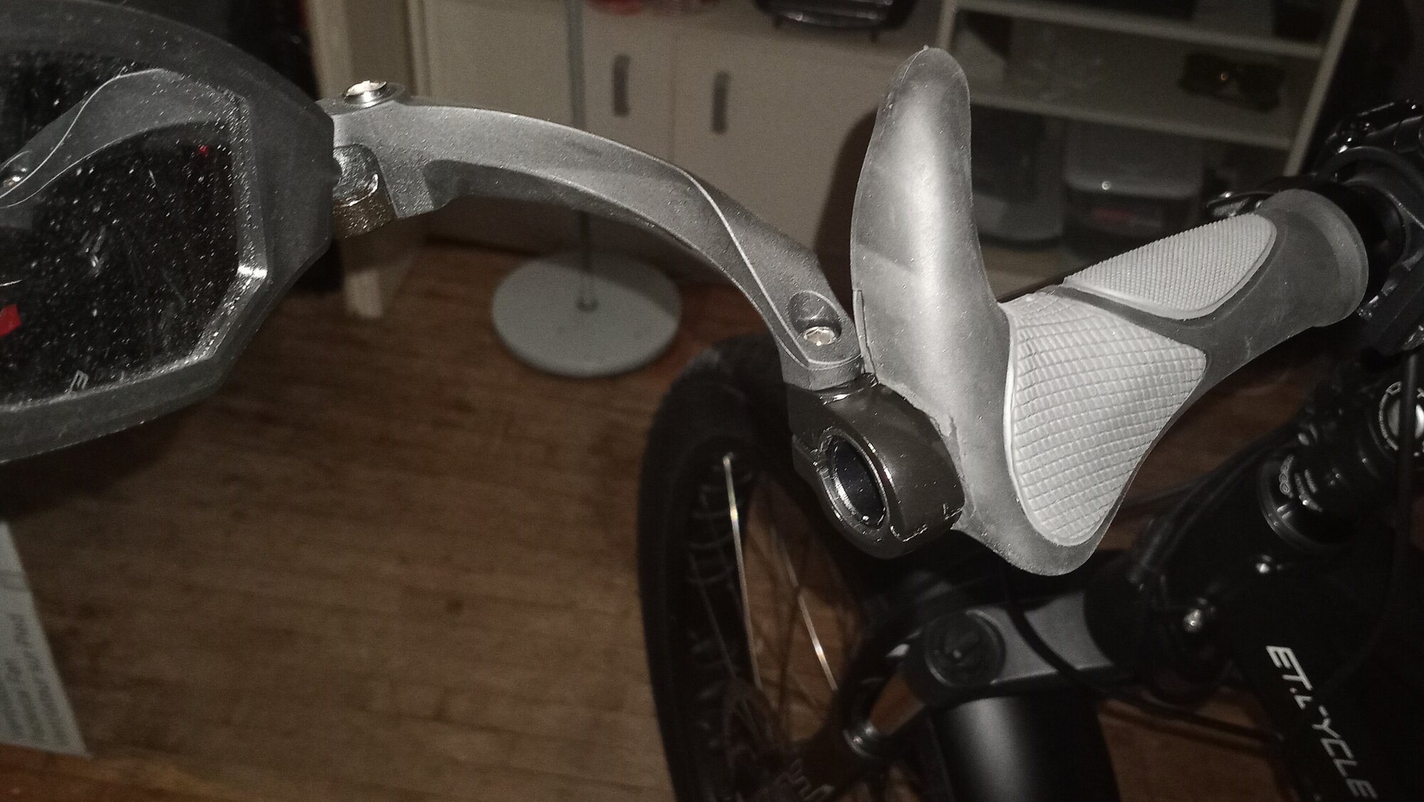

How does it feel to have your throttle on the left?
Do you feel European? 😂
I had my full twist throttle on the right and it was a PITA.
When the road was rough, I would have to grab the handlebars tight to keep control and the throttle was bouncing around and the power was too.
A half twist (like the ½ twist shifter on my mountain bike) allowed me to grab the outside of the handlebar to grip hard without changing gears.
I'm used to the throttle being on the right, and luckily I haven't ridden a motorcycle in decades, so I'm used to the front brake being on the left now, so my muscle memory grabs the correct brake when shyte happens real fast and you don't have time to think.

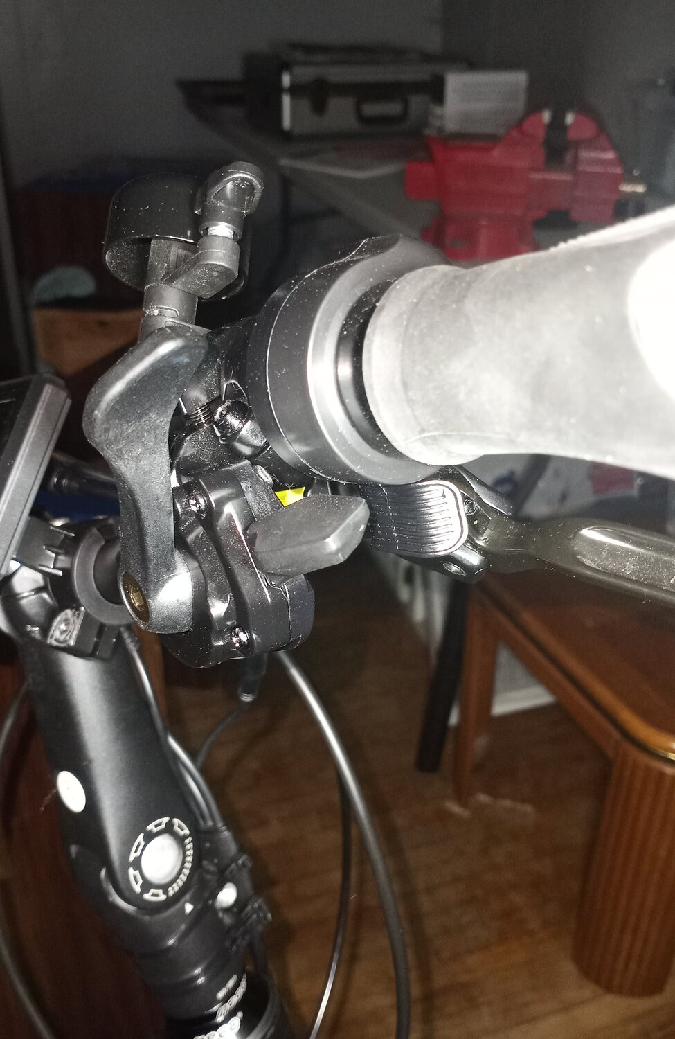

This is my new thumb throttle.
It's tucked in nicely between the brake lever and shifter levers and is well protected from accidents.
I have to reach in and push the throttle around and up though, but I'm getting used to it.

I had to butcher the end of my handlebar grip to fit my mirror too. I could have installed the mirror on the other side of the grip, but I couldn't see past my shoulder.
