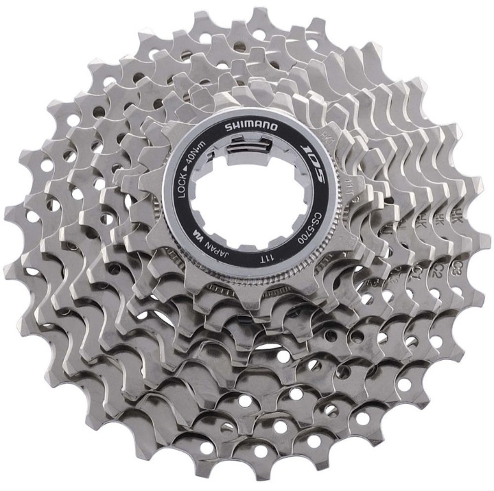

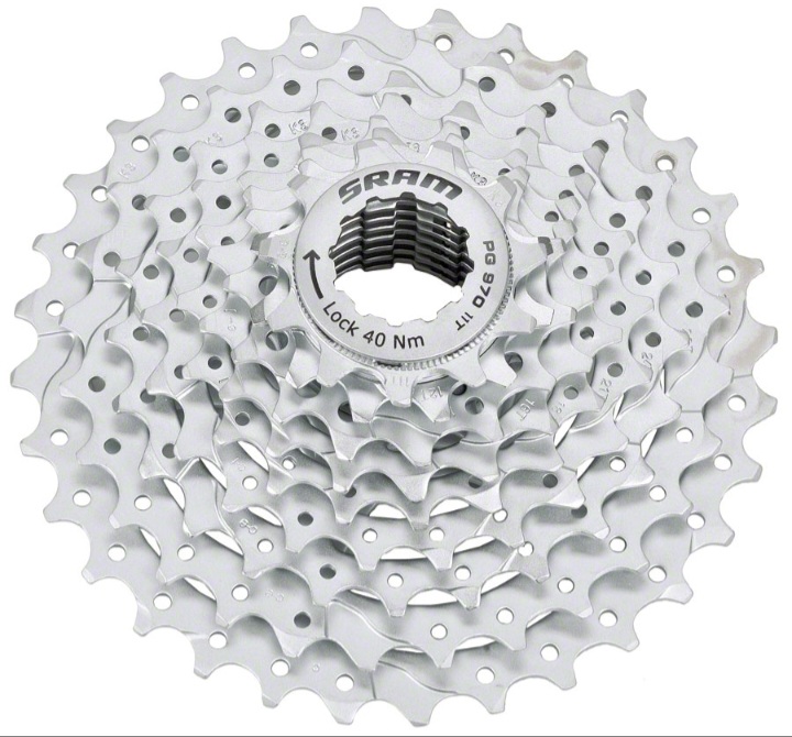

I found a couple pictures of the two cassettes,..

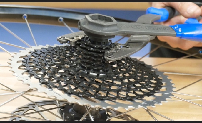

And a picture of the special tools needed to remove the cassette.
You can cheap out on the chain whip and get a Chinese knock-off but don't cheap out on the cassette removal wrench or socket, and get a proper Park Tool. And make sure that you get the right tool. The tools come with different spline counts, spline reach, and spline depth (thickness).
You may be able to remove all the sprockets from the cassette without removing the cassette hub from the wheel hub, and replace all the sprockets with the 9 speeds that you want, but keep in mind that you can only go so big on the low gear before you're derailleur can't deal with it.

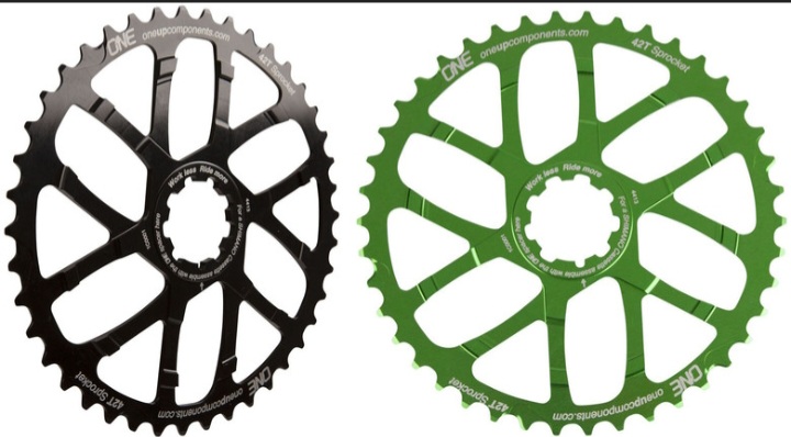

From what I think I remember, some cassettes allow you to replace 1 or 2 sprockets on either end of the cassette, with the sprockets in the middle being fused/welded together.
That allows you to pick the lowest gear tooth count (34T-52T) of your choice, and replace the highest gear (11T) which tends to wear out.
That can give you a super low gear for slow speeds and steep climbs.
Your cassette will look something like this, with a huge jump from first to second gear.
You'd need to know if your derailleur can cope with it and if it will even fit on your wheel and ebike.
