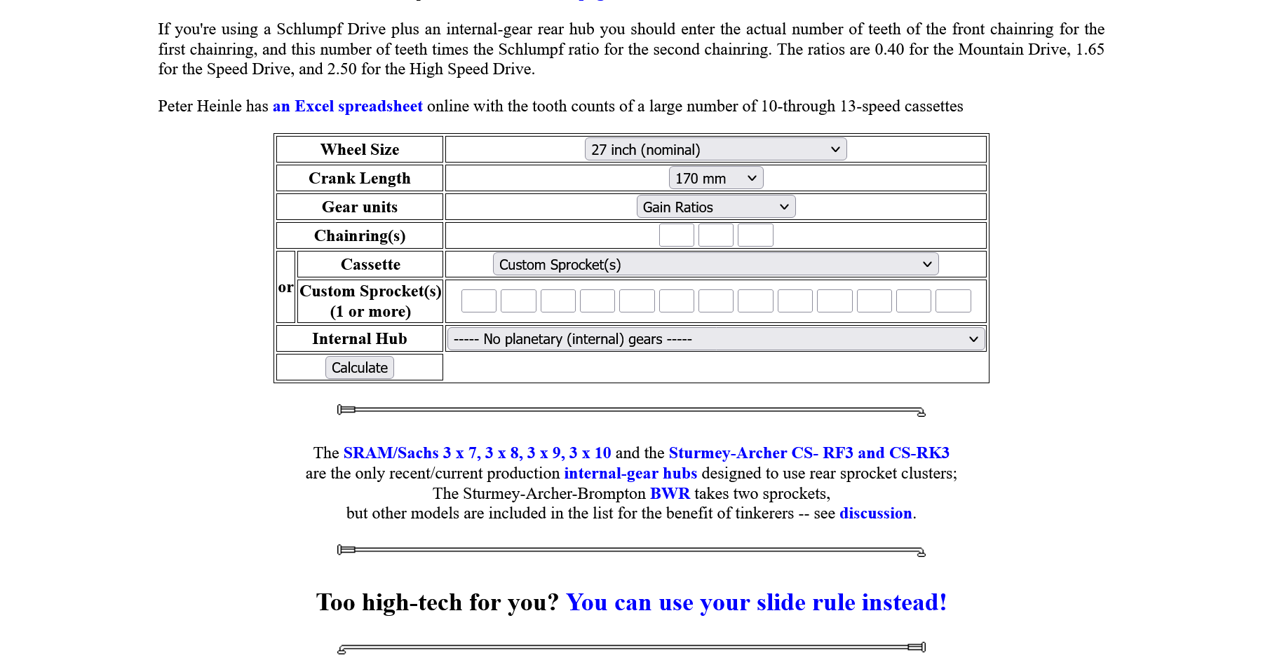

Go to Sheldon Brown's Gear Calculator. All you need to do is change the ring to lower the ratios.

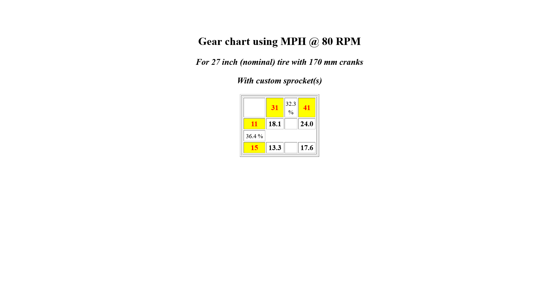

I did that calculation. It is about ten fewer teeth on the chainring to make an 11 act like a 15 cog. In this example a 31 tooth rig to an 11-t cog, goes 18 MPH at a cadence of 80. And in the lower right a 41 ring to a 15 cog, goes 17.6 at a cadence of 80 RPM. Basically, everything is shifted down by almost 1/3rd.

Sheldon Brown's Bike Gear Calculator did the math. It is so easy. I have a chainring on my wall that is 58-t. When I didn't know better, I wanted to go 50!

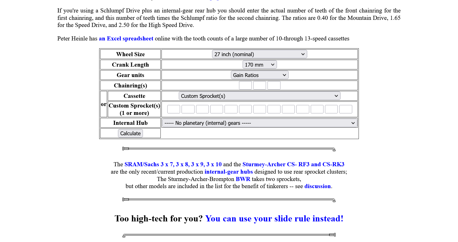

I am also comparing the results with this calculator, that was shared with me.
There is a difference between them.
