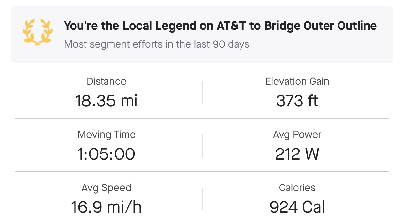

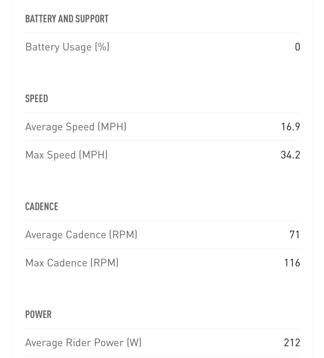

yes, you’re right! mission control displays rider power as you ride, and records it, but does not display it in the ride summary. “ride” or strava - or any other gpx/tcx/fit file viewer will show it exactly as mission control recorded it.
the important thing to note is that if you upload from MC to strava, strava is not calculating this based on speed and weight and gradient, it’s just reading the values saved by mission control (or in your case saved by the wahoo.) the data matches.
strava - 212w average
ride - 212w average
calorie counting estimates vary quite a bit - 827 vs 924 for this short and flat ride.
