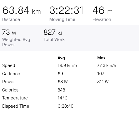

Is the watts data just the pedaling energy while the kcal data includes pedaling energy plus resting energy used?
The power as reported by Strava is taken from your e-bike power-meter while kcal is what you have actually input into pedalling (but not the energy you need to sustain your life -- it is not metered).

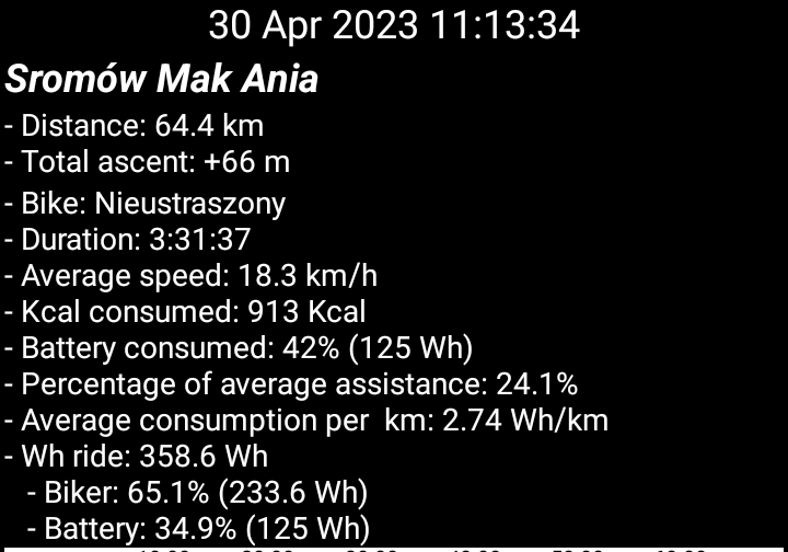

Yesterday, I was pedalling my Vado SL at very low assistance (24% average assistance is what 12% assistance would be on my full-power Vado 6.0).
Meanwhile, BLEvo reported:
As you can see, BLEvo uses a different algorithm for kcal. It is, however, important that BLEvo (only working for pre-Mastermind e-bikes) gives you precise figures for average assistance, battery consumption, Wh per km or mile, the rider's energy input (net) and the battery contribution into the ride. With more data (BLEvo produces tons of stats!), I learned my average leg power was 94 W, not 73 as Strava determined. BLEvo also told my my maximum leg power (in burst) was 316 W.

Using the Strava data: 52 watts for 33 minutes = 28.6 Wh. 116 kcal = 134.9 Wh.

strava calorie estimates are active calories, i believe, based on the amount of work done and not your resting metabolic rate.
are you looking at data in strava that the strava app collected (i.e. you were running it in your phone while riding) or did you upload the data from mission control to strava?
in the case of the former, the estimates are totally useless. without a bunch of sensors connected the strava app has no idea how much work you’re doing.
the strava “watts” data is definitely just the pedaling energy. strava has no idea about e-bike battery usage or motor output. however, again, if you didn’t upload the data from mission control (which is connected to the bike’s pedal power sensor) those watt estimates are pretty useless. they don’t take into account wind, drag, bike weight, a million things.

The Strava data was uploaded from Mission Control after the ride was complete.
Here's what I don't get. Calories and watt hours are energy units just like kilometers and miles are distance units. In the ride shown above Strava says I exerted 52 watts for 33 minutes. That's 28.6 Wh. It also says I used 116 kcal. That's 134.9 Wh. What am I missing?

that’s about right.
the efficiency of the human body as a motor for cycling is around 25%. if you burn 1000 calories, 250 of them go into motion at the cranks. 28.6 * 4 = 114, pretty close to 134.9. the slight variability of efficiency is why the calorie estimates are just that, some people are a little more efficient than others.
