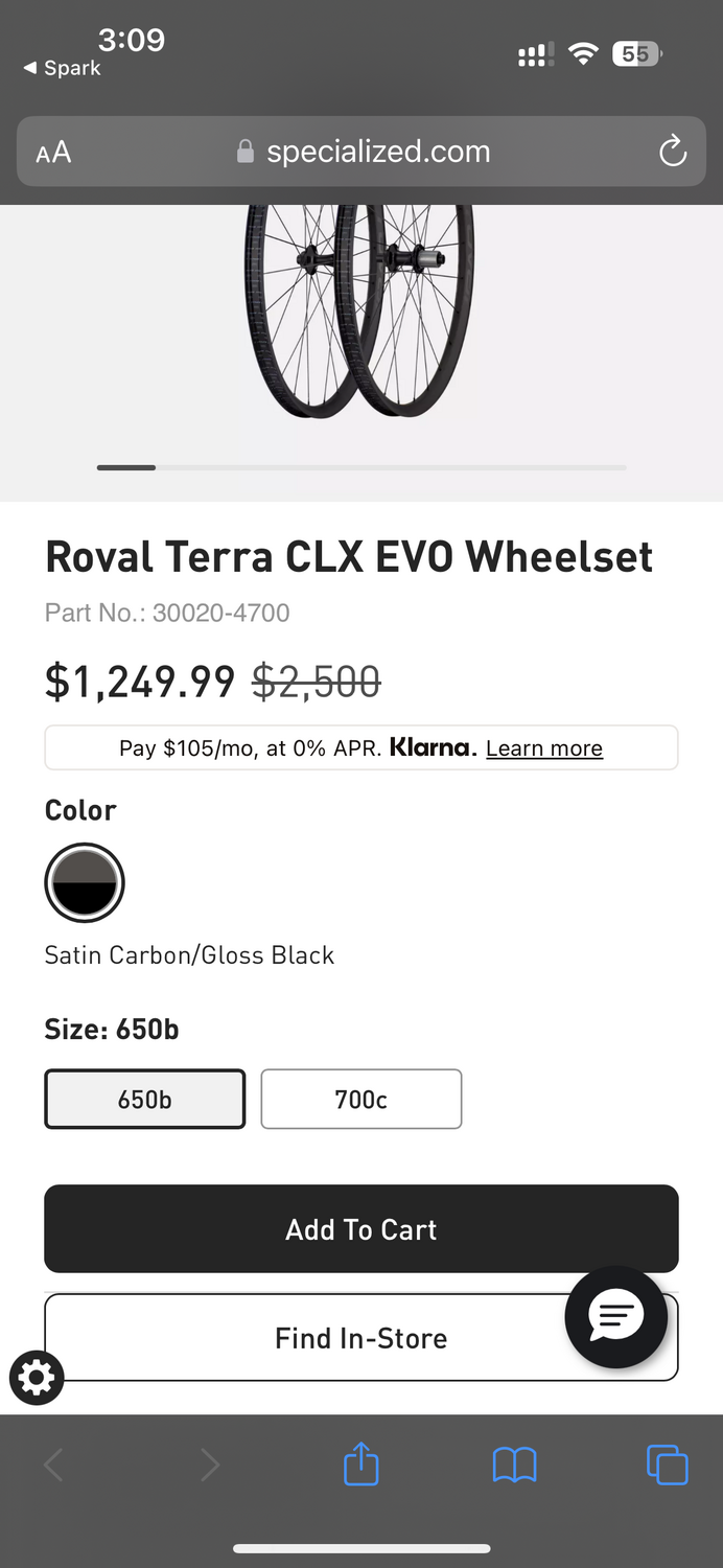

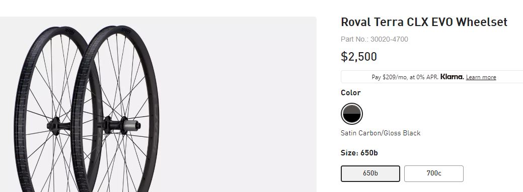

strangely spec's site initially shows a big discount on the terra clx evo but then not once you click through, in either size!
