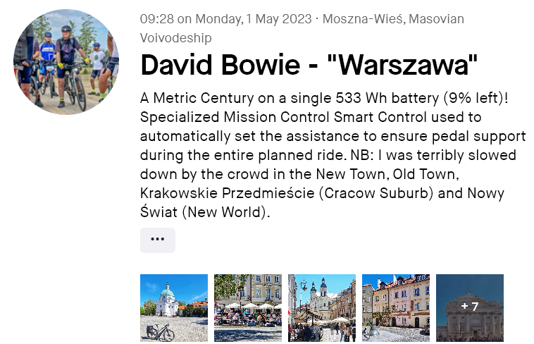

Not a Creo 2, not a particularly long ride but Smart Control appeared to be working well.
Necessary to mention, I have been confronted with the conditions of the upcoming Sudovia Gravel E-Sprint race: A single battery set, no recharging, 80 km, +1000 m, many short climbs up to 16%. I intend to make it on a Vado SL with the main battery + a single RE. I will have to entrust Smart Control whatever it takes. I would only be using Turbo mode on the steepest inclines, and consistently going OFF for any descent. I'm changing the gearing to 36-51T for that race.

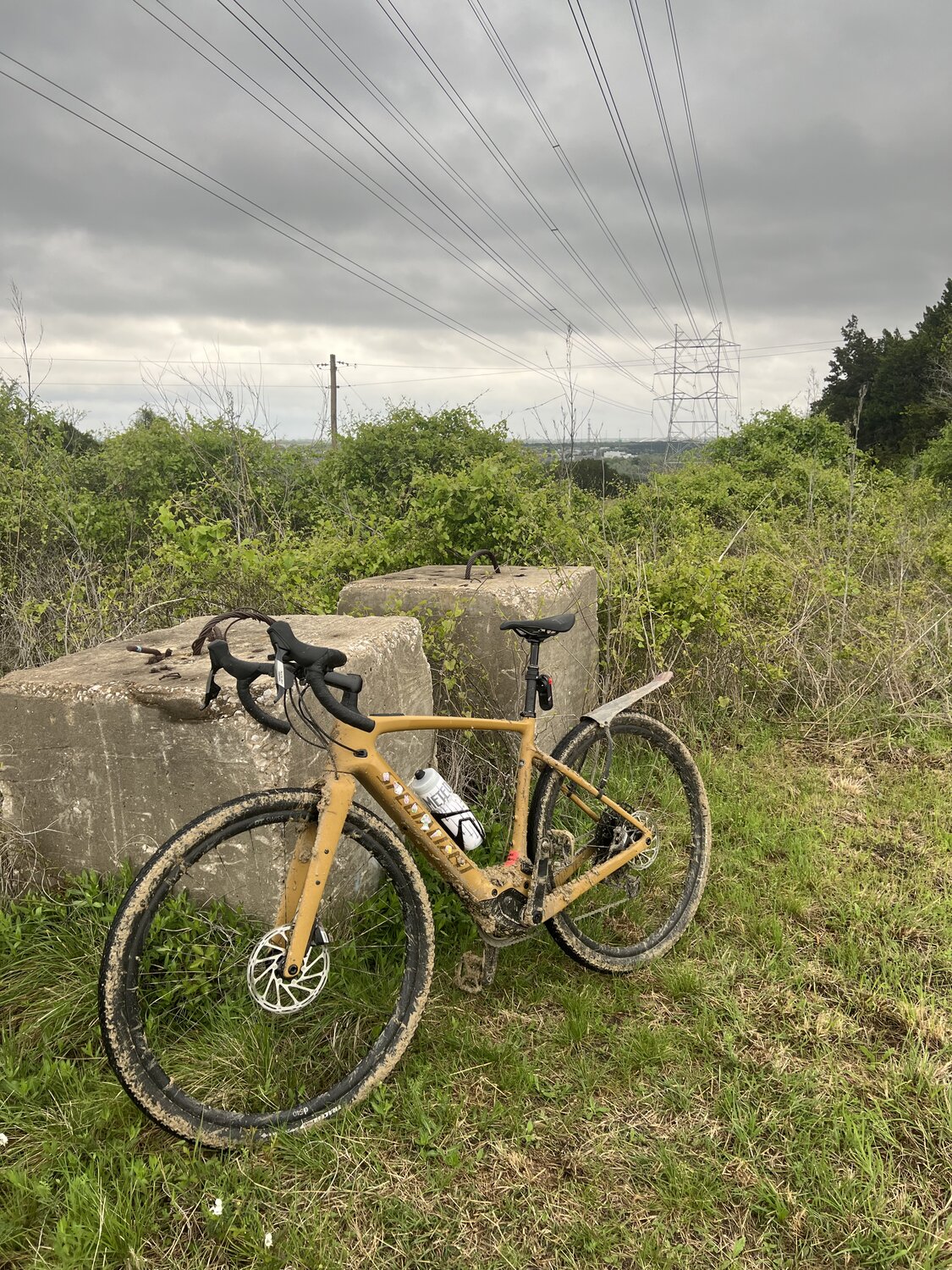

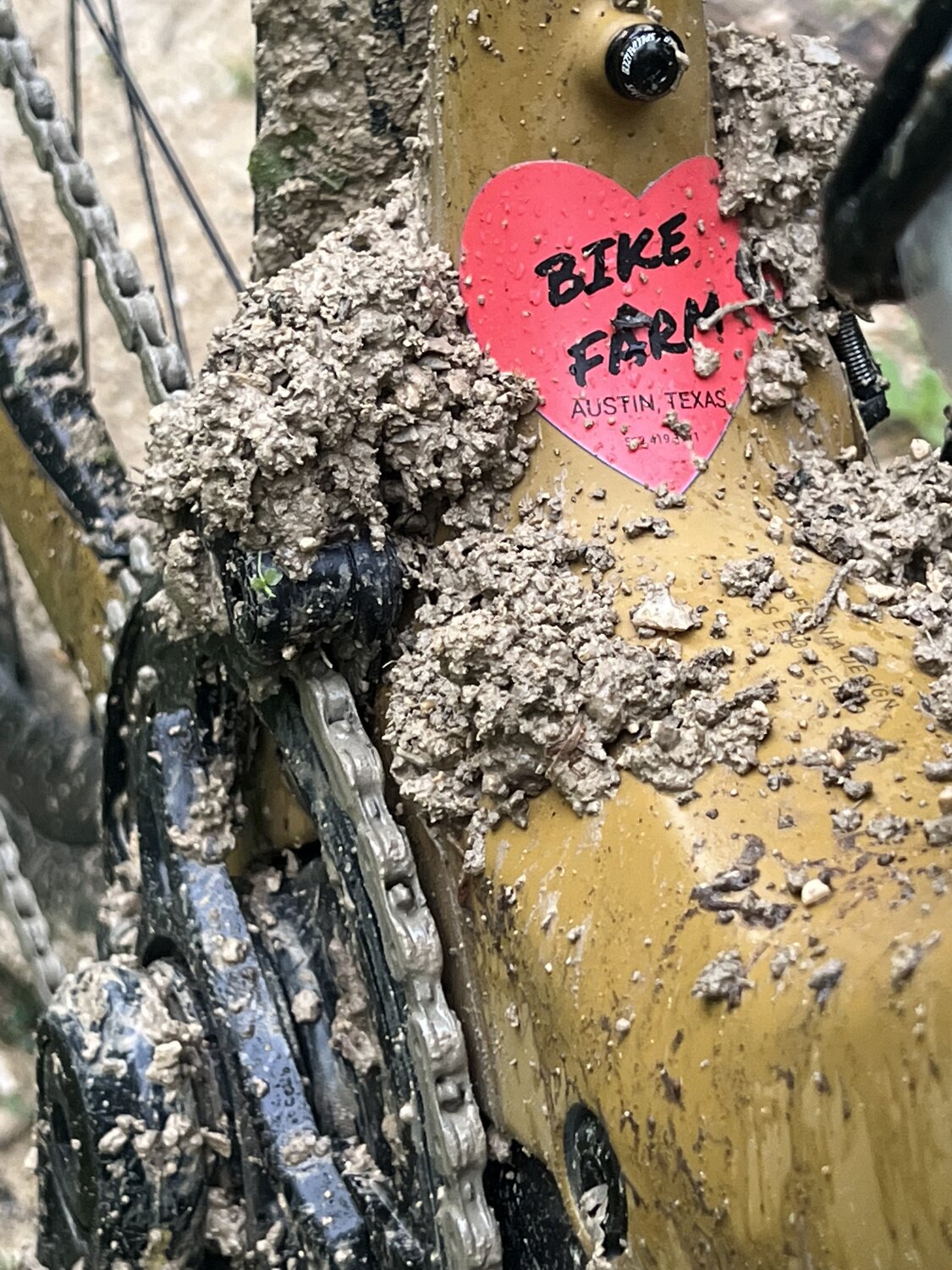

Little impromptu adventure yesterday. With the Creo every "oh I wonder what's over there..." becomes "well, might as well find out!"

Wiggly like a worm in the mud :D
And in case you were wondering what tan walls might look like on the Gold Harvest colorway.. I'd say, pretty dang good!
The tan sidewalls and mud look great with that colorway. How wide did you go with the new tires? And I concur, I'm much more willing to explore tangential trails and roads on this bike.
Oh that’s all mud! Nice little mockup of what tan walls might look like.
Running the stock 47s and very satisfied with them so far even for road riding.

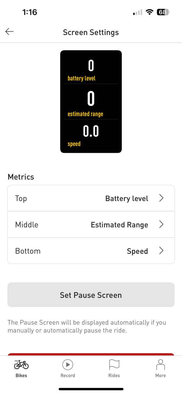

Having a technical problem with transferring a screen from the Mission Control app to the MCU on my bike. Ridercare says to press both remotes simultaneously to trigger the screen transfer. Not happening. Below is a pic of the screen I’m trying to add to the MCU. Does anyone have a solution?
In my experience, there is no pushing buttons to "transfer." When I change a field on my phone, it updates instantly on the TCU. Make sure you are using the newest spesh app with the white S on black background. The old app is white S on red background. The newest app is no longer called Mission Control. The new one I believe is simply, The Specialized App.
Also on my list of questions. My bike only shows the very first screen style in the menu. I can switch the one variable (mph) to the other options, but the other screens do not push to the bike.
I have the new app. When I talked with Ridercare, they suggested the screens could be synced to the M TCU by pressing both remotes simultaneously. I can use the remotes to toggle back and forth for Microtuning if I don’t want the other ride modes (ie., ECO). But otherwise I only have the battery level showing up on my MTCU. Ridercare suggests having the remotes checked at the shop.
When I'm at home configuring the screens on my phone that I want on my TCU, I never touch the remotes. Now, when I'm on a ride and I want to toggle between the screens I've created, then I press both remotes at the same time. That's how you switch screens on the TCU, press both at the same time. Good luck!
