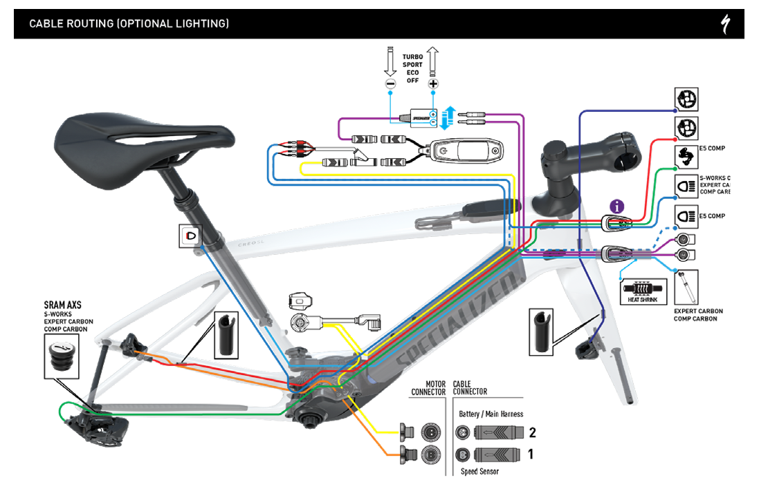

Do anyone know if the Creo 2 Comp wiring harness has (unused) connections for integrated lights similar to those on the Vado SL - Lezyne lights. I found that the Creo SL had the potential for fitting a cable splitter - is the same part compatible on the Creo 2 Comp ?
Thanks
the manual states that there is the option to run the "standard" barmounted buttons(S216800011 ELE HMI, SL SYSTEM, ROAD REMOTE FOR DROP-BAR BIKES), the S216800001 TURBO SL WIRING, Y-SPLITTER FOR LIGHT, NO FUSE can be placed on this Mastermind and works with the barmounted buttons, so I would be surprised if this splitter would not work with the Creo 2. You could always ask the delaer/Rider Care if this is correct.
found this in the rider workbook for the Creo 2
