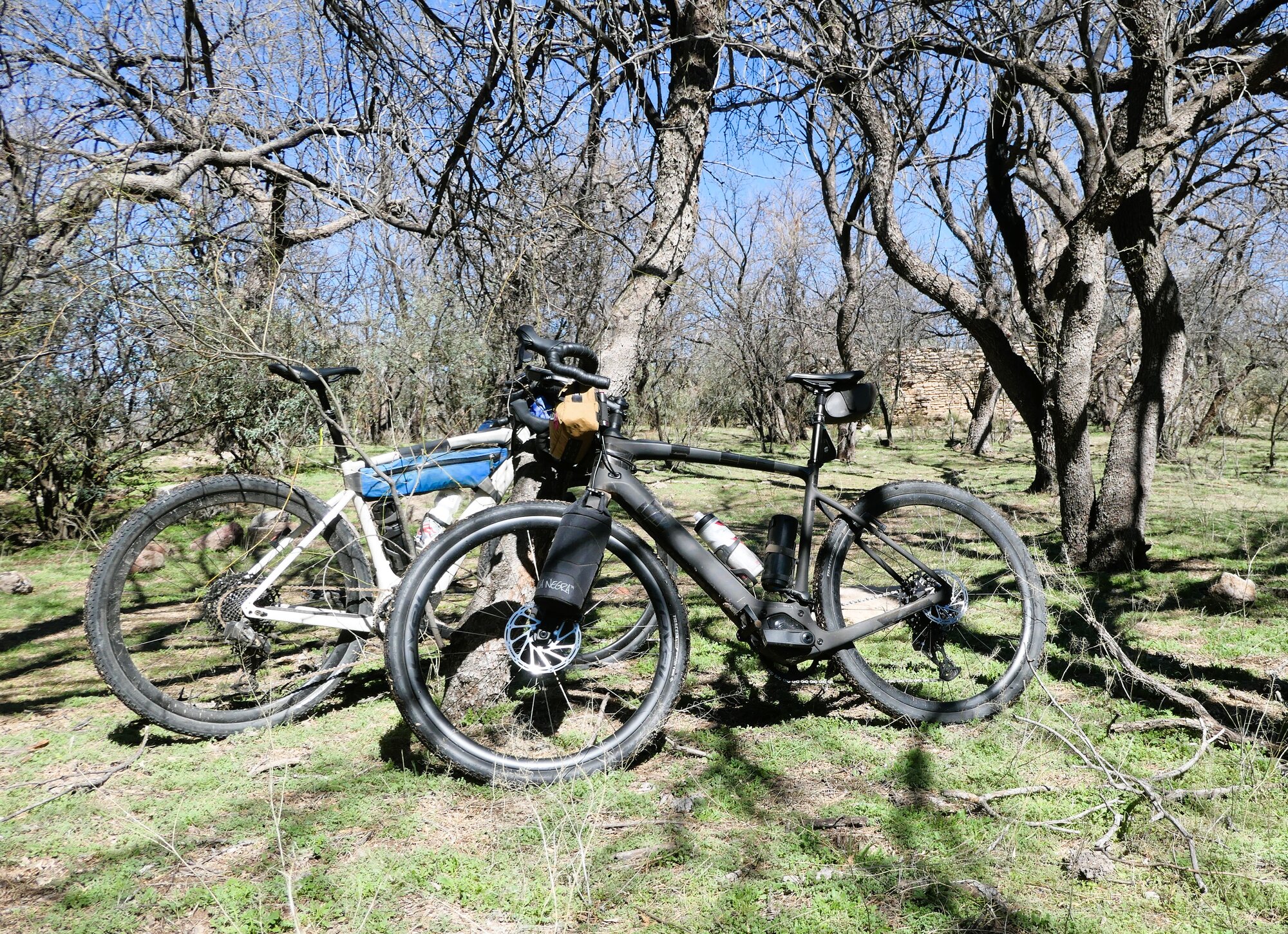

This is the only pic I have so far of our bikes together. When using the RE, you have to find other ways to carry water especially when no services are available on a remote ride. I've very happy Spesh was smart enough to put mounts on the fork.

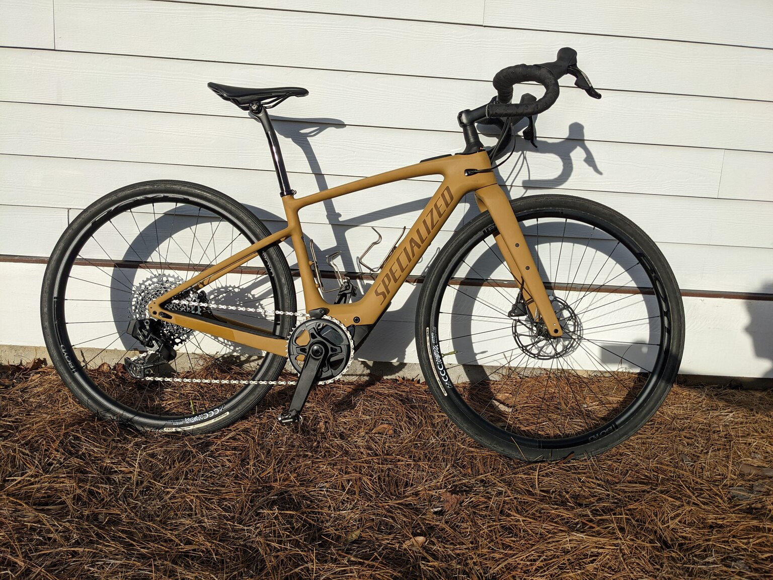

as of yesterday, Officially in the owners club. if there is such a thing.
Came from a 2023 Diverge and fits great, no changes needed to the setup regarding fit
Parts changes made at shop before taking receipt:
*removed the G540 wheels w/Tracer tires put on wheels(Boyd) and tires(Panaracer SS 43mm/tubeless) from Diverge and saved 1.6lbs (0.725748kg)
*removed bars it came with, put on Redshift Kitchen sink bars (love these things!)
*removed dropper post, added Roval Terra carbon post from old bike
the harvest gold color is better in person I think
there is a review that says 'love at first ride' - i see why now.
this thing is going to be so much fun on some hilly gravel rides. including a few pics for evidence

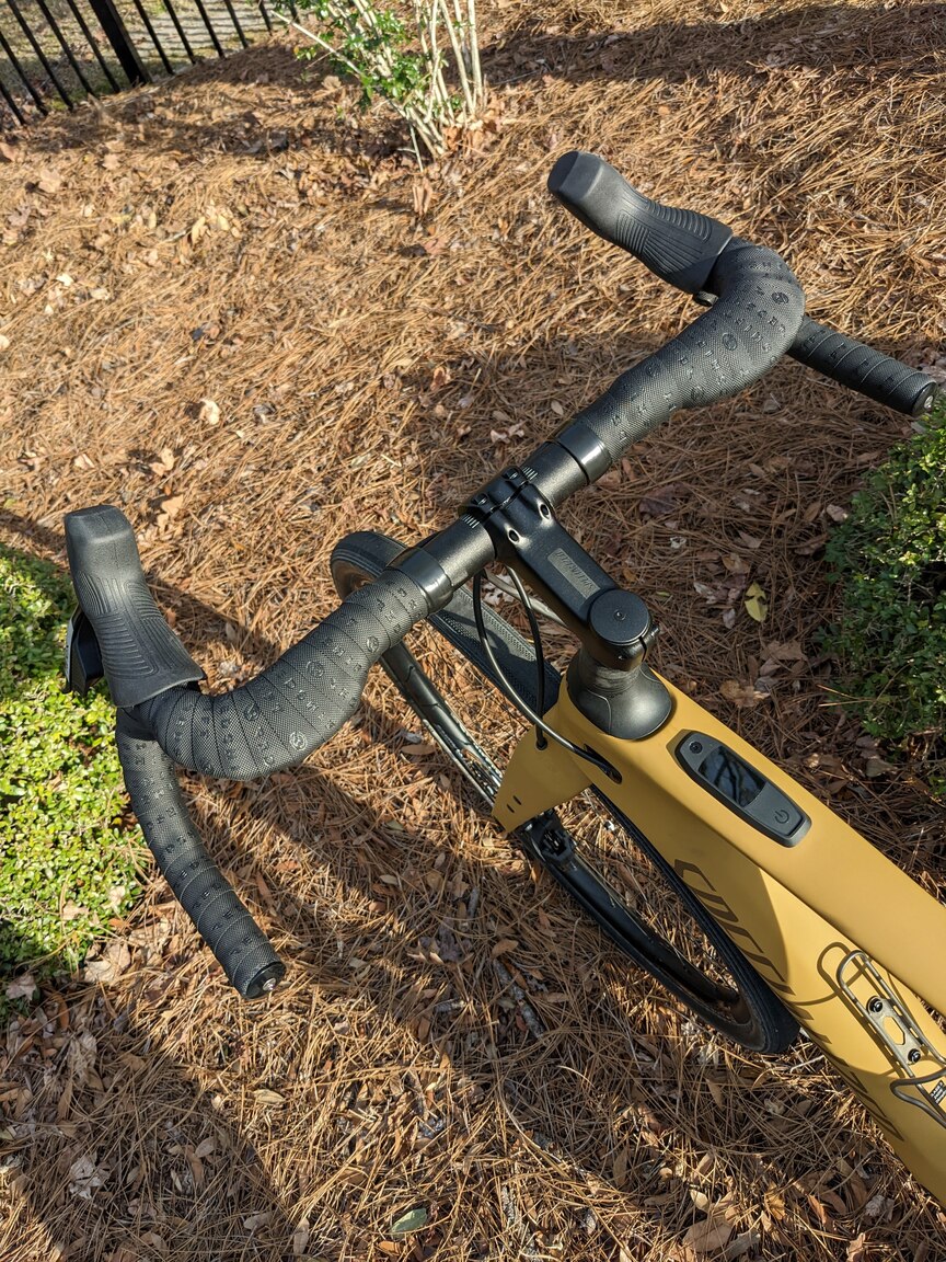

When it rains, it pours! I also joined the Creo 2 New Owners Club today with the arrival of a new Expert with the white-flecked finish. I live just north of Portland, Maine, and--wouldn't you know it-- the one LBS in town that handled Specialized dropped the line last year and now is a Trek store. There are a couple of small shops about 20 miles away that do handle Spesh, but they defininly are geared to the lower-end casual riders and kids, and I didn't feel they had the expertise to really support a Creo sales and service.
So I called the LL Bean bike store, just a six-minute drive away. I knew they handled brands like Santa Cruz and Felt, but was surprised the Specialized website listed them as an authorized dealer. The LL Bean bike outlet is unusual in that they don't have any of the bike brand signs or decals on their windows or doors-- it's a very low-key operation from the exterior. Turns out they do stock and sell a lot of mid- and upper-end Spesh bikes like Roubaix's, and the saleswoman there knew all about the Creo 2 (she had owned and ridden a Creo 1 herself) and was gung-ho on bringing in a couple of the new models.
I asked her if they were versed in the bike technology, and she assured me that their staff had been trained and knew how to service the SL1.2 motors.
Plus-- the icing on the cake-- if you open up an LL Bean MasterCard, you save 15% off the bike and anything else you buy that day at the store. I ordered an Expert in size 58, following her advice. Now, a 58cm frame would normally be too large for me (I'm a smidge over 5'10, 200 lbs), but she pointed out that the 58 has 31mm more stack than the 56, but only 9mm more reach. I'm a 'Stack Seeker' because I get muscle aches if the bars are two low-- that's my 70 year old neck crying out.
I hopped on the bike at the store today-- it wasn't quite finished (no bar tape for example), but they swapped the 110mm, 6-degree stem for a 90mm,17 degree one, and the fit was pretty comfortable. The bars are pretty much at seat level, so I won't have to crane the old neck too much and the reach is also reduced to be more ergonomic. The saleswoman even said that if, after riding the bike for a month, I felt it was too large for me, she would switch it out for a 56-- that's what I call good service!
Plus, with the RE battery, charging cables, and some tubeless supplies, I saved $1,444 off retail with the MasterCard deal. If you live in Maine-- or near it-- you might want to check out this option. By the way, I've had their mechanics work on several of our bikes over the past few years, and they really know their stuff-- I've been pleased with the quality and prices there, compared to some other shops I've been to.
I'm heading out for town for a few weeks, so I'll pick up the bike later. In the meantime, I asked her to have the blips mounted on the lower insides of the hoods, which someone recommended on the FB Creo group thread. Can't wait to get riding!

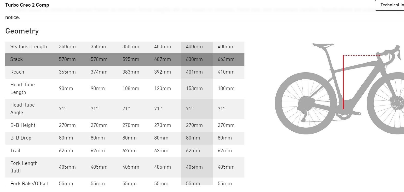

Brand new to the forum here. If I might ask a question....I have a 2018 Diverge Expert and am looking at getting the same frame size now in the Turbo Creo 2 Comp. Near as I tell, with a site called "99 Spokes", the frame dimensions between the two are almost identical, except for the front forks laying out a bit more (longer wheelbase with Creo). I depend on getting my saddle level with the top of the stem, and I believe that Specialized has incorrectly drawn the stack height attached. Shouldn't it be from the center of the bottom bracket to top of head tube; not to middle of stem mount? Thank you.
Specialized seems to measure stack height the vertical distance between the bottom bracket and the point on the future shock that the stem sits, without spacers, which would go below the future shock. This is the minimum stack height measurement, equivalent to the stack of a non-futureshock bike with the stem seated right on top of the head tube.
Just to clarify, does this mean that the true stack height should be from the center of BB to the top of the top tube at the junction of top tube and the black plastic headset cover piece? This is where I measured my old Diverge to agree with stack spec on that one. In addition, for 58cm frame on the Creo, they show a top tube length of 590mm measured from top of head tube level to center of seat post.. If you consider the "higher" stack height of 638mm, and the forward reach of 401mm, and calculate the rearward reach to center of seat post (638/tan(16.5deg)) = 189mm), and add 401 and 189 together, you get exactly 590 which is the "lower" top tube length shown to be about 3" lower. I know this is getting really detailed, but for my adjusted saddle height of 30", this is a difference of 3" of handlebar height. Since the angle of the seat tube is more vertical and the head tube is more "laid out", the distance between the two decreases as height goes up, so if their drawing were correct, the combined reach forward and back should add up to 4mm shorter...

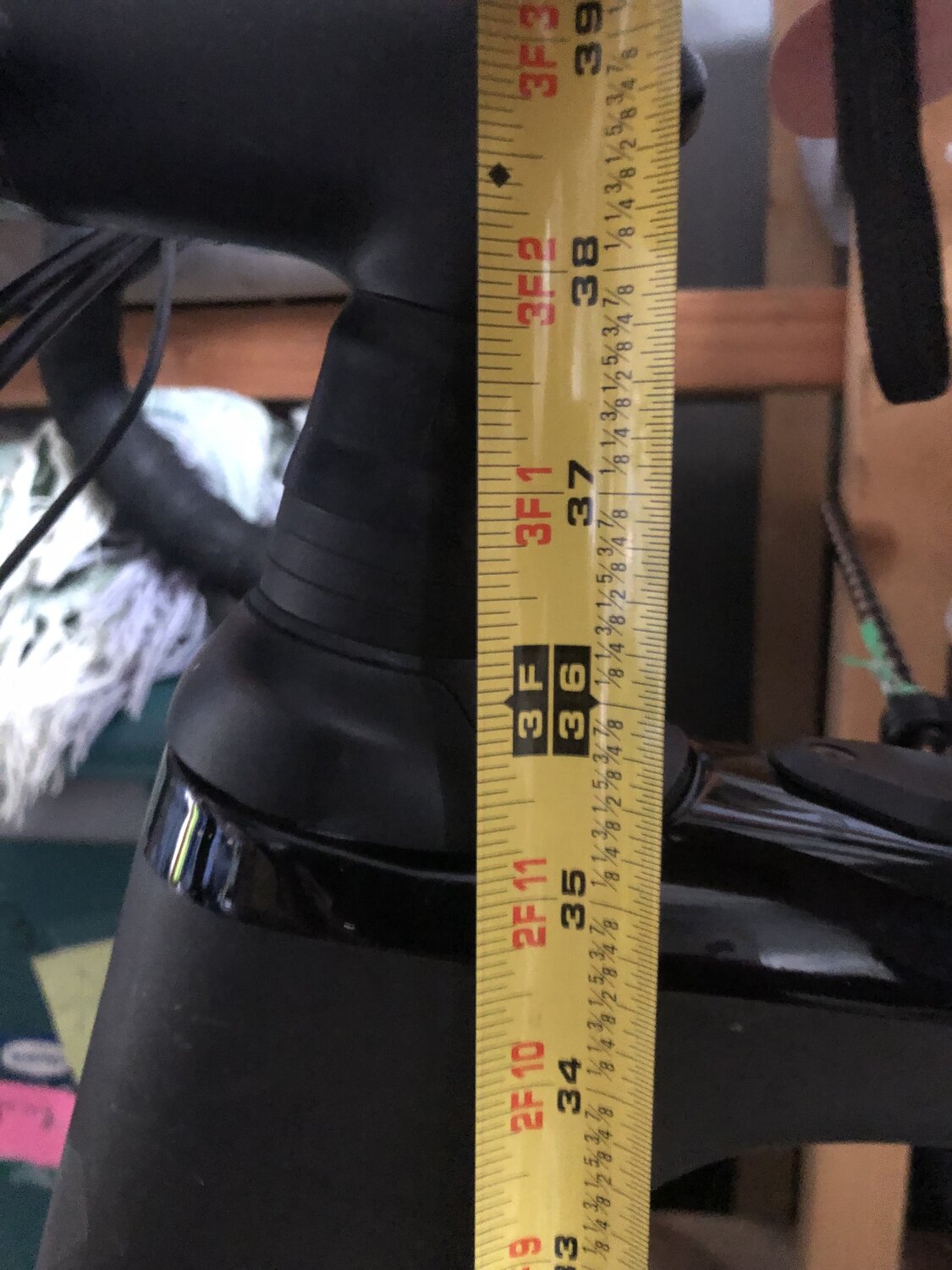

Here’s what I did to estimate the way specialized measures their stack height:
My 2021 XXL Creo specs say the bottom bracket height is 269.5mm, Stack 675, Reach 399, Horiz top tube 605. Adding the bottom bracket height to the stack gives about 945mm which is just over 37 3/16 in., floor to “stack height point”. My bike has three 5mm spacers that sit on top of the headset cover (duckbill) that raise the future shock up by 15mm. You can see in the photo that if you remove the 15mm of spacers (just over 9/16 in.), the future shock cartridge will sit 9/16 in lower and bring the stem down with it to sit at about 37 3/16 in. So I think Specialized includes the headset cap and the point on the future shock that a stem rests on (without any spacers) In their stack height measurement.
Just to check other measurements, I measured from that 37 3/16 point on the headset to the center of the seat post (horizontally) and got about 23 5/8 in. (600 mm), which is pretty close to the 605 spec.

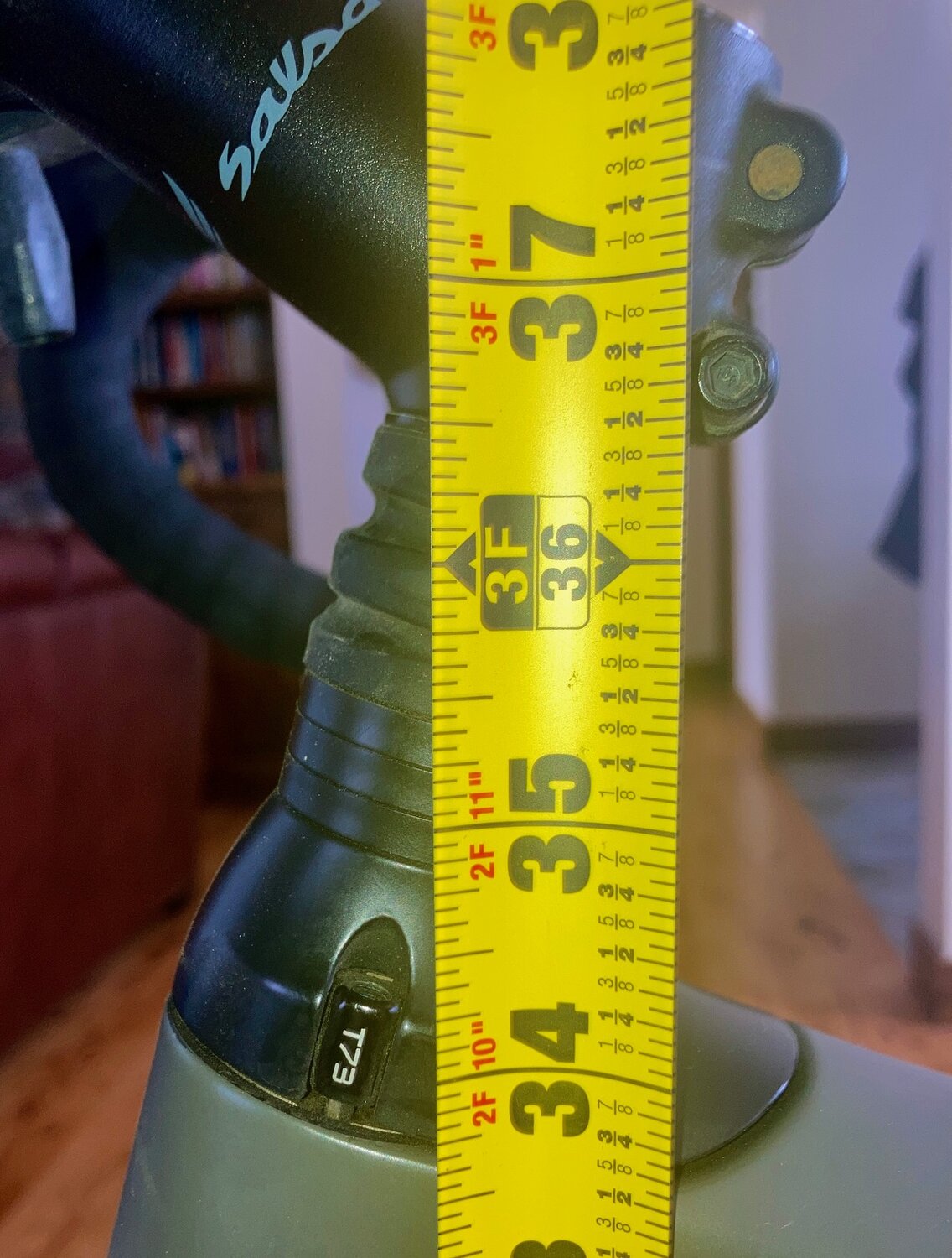

Are you performing this size assessment because you don't have access to a store where you can test ride the actual bike? Are you almost always in-between sizes?
Thank you. Ok, I just did the same and with inflated tires and verifying BB height, my 58cm 2018 Diverge specs were 265 mm floor to center of BB and 624 mm from center of BB for stack height. That's 889 mm, or 35". That's right in the middle of that first 5mm spacer above the duck bill. Seems Specialized isn't consistent with their definition of (or measurement of) 'stack'. I got in touch with Specialized, got an email back, added details, and replied. They're forwarding to the Creo team. I'll write back with their response.
